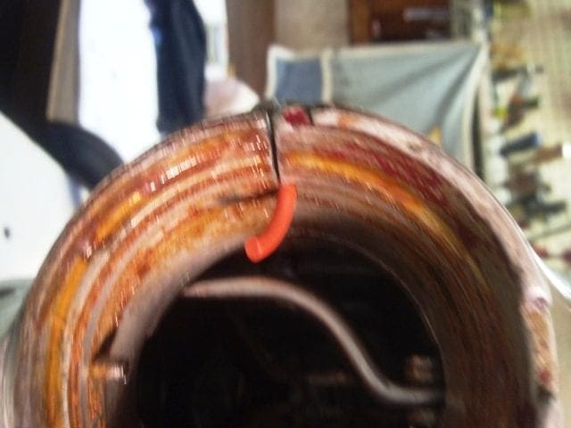

                #178561
                outboardnut
                  I did pressure test it with soapy water
                  Bolted the halves together with three screws.
                  And I was able to force a piece of spaghetti seal into the grove without too much effort.
                  piece-of-speg
                  #178566
                    If that picture is with screws installed and tightened, you certainly do have a problem. That gap between the halves is not normal. Mismatched, bent, or whatever. Don’t overlook the Gale 25hp gearcases in your search.
                    #178570
                    outboardnut
                      That picture is the halves tighten with three screws and then a one inch piece of spaghetti seal mildly forced into the groove
