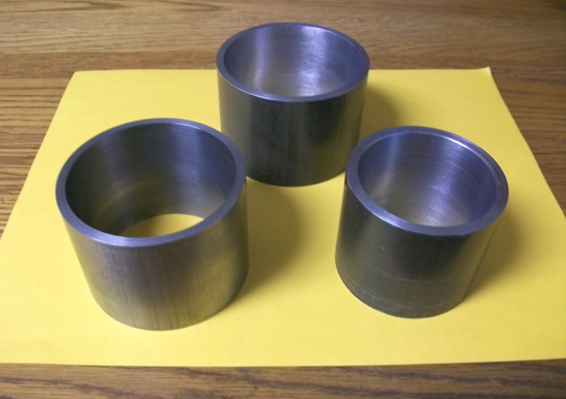

                      #83965
                        For those of you that are unfamiliar with the tapered sleeve types. OMC only made them for their larger pistons, but other companies such as Martin also made them. They are also easy to make if one has a metal lathe. Showing a few that I made.
