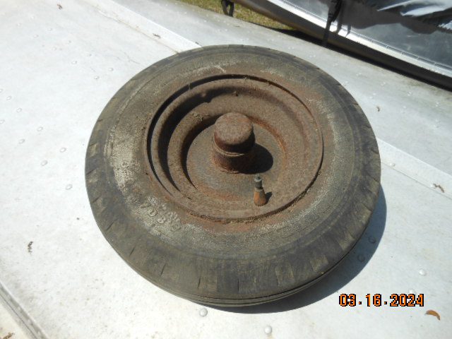

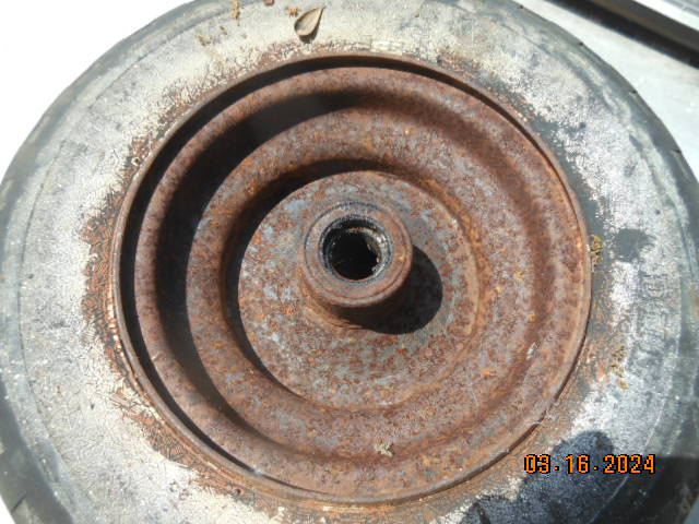

                MIKE SIMS
                  Is this what you are looking for?
                  DSCN2624
                  DSCN2625
                  #286004
                  JOSEPH BRINCAT
                    That is what the OP was asking about, but from my expierence with these, one will need to know a few details, like…
                    • tire, wheel size
                    • axle diameter
                    • spacing of the bearings ( distance from cone to cone)
                    These hubless wheels are not all the same
                    Joe B
