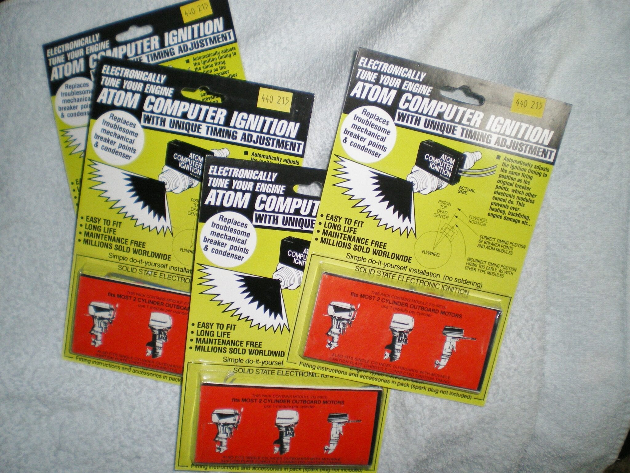

                      #235395
                        It’s good to know someone else likes the Atom modules to!
                        IMGP0099
