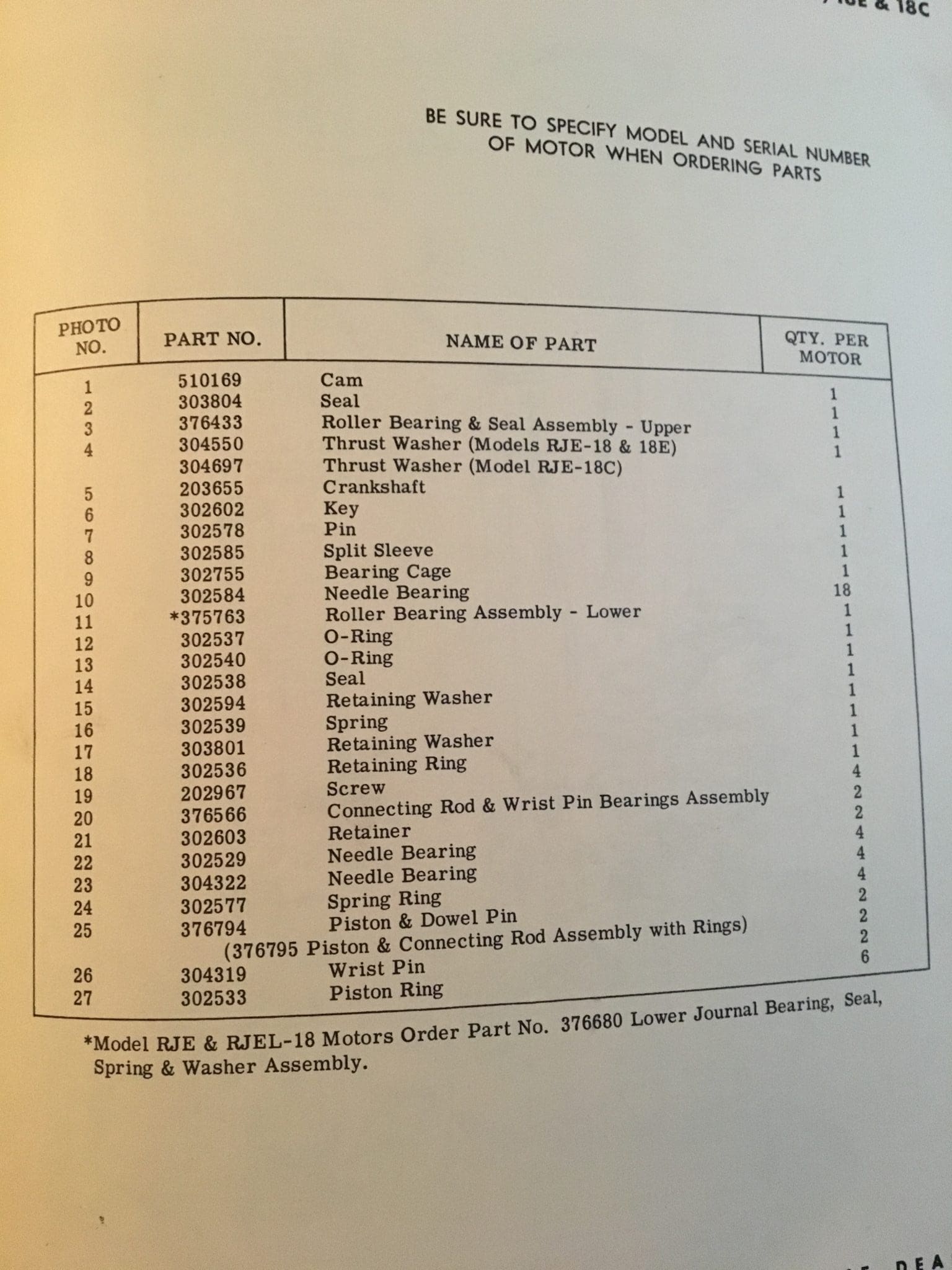

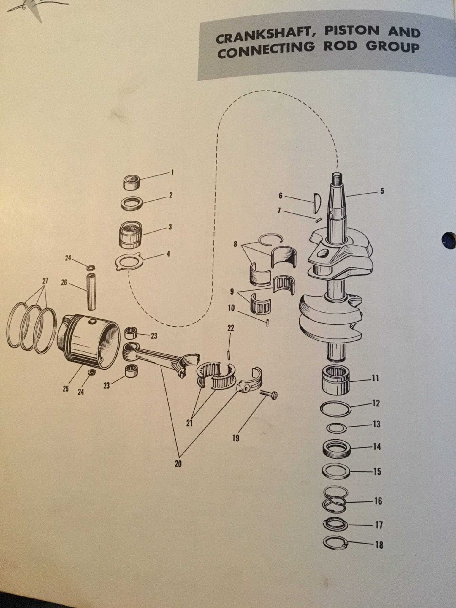

    Tinman
      This is what I have.
      IMG_4836
      IMG_4835
      #180423
        OK, your parts list says the difference between “E” and “C” is the #4 thrust washer. It also says RJE-18 (no suffix), replace the entire lower bearing with seal parts. That means the no-suffix model is the one with the bad seal and you have to replace the whole assembly to correct it. Since you do not have the no-suffix model, you got lucky.
