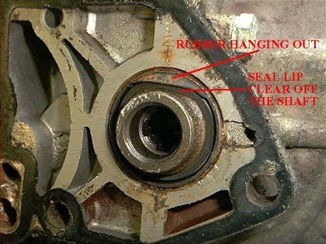

            Lower crankshaft seal was a major powerhead killer. When they leak water gets into the crankcase and it will throw a rod. Highly suggest you change it. Some J/E had the same problem.

              Does it take a special puller to remove the seal? And do they still make a base gasket for the 12 hp? You mentioned the some j/e have the same seal problems, what ones where affected? Thanks.
              #180387
                Nah you can dig it out with a screwdriver or whatever. I’ll have to look up the gasket #. The troublesome seal number was 303804. Also used on some but not all 1955-56 15/25/30hp J/E motors. And all Gale 12/15 hp motors with rubber motor mounts.
                #180390
                  Base gasket gets confusing. Original # was 303892. That was superseded by 377070 baffle and gasket kit which included a stainless steel baffle plate and two thinner gaskets. The baffle was supposed to keep the nasty away from the seal. Didn’t really help much. The thin gaskets were 304588. You can use two thin gaskets if you don’t have the baffle. J/E also used these parts. In fact, the Gale 12 is just a 15hp J/E but with smaller bore and different internal powerhead parts.
