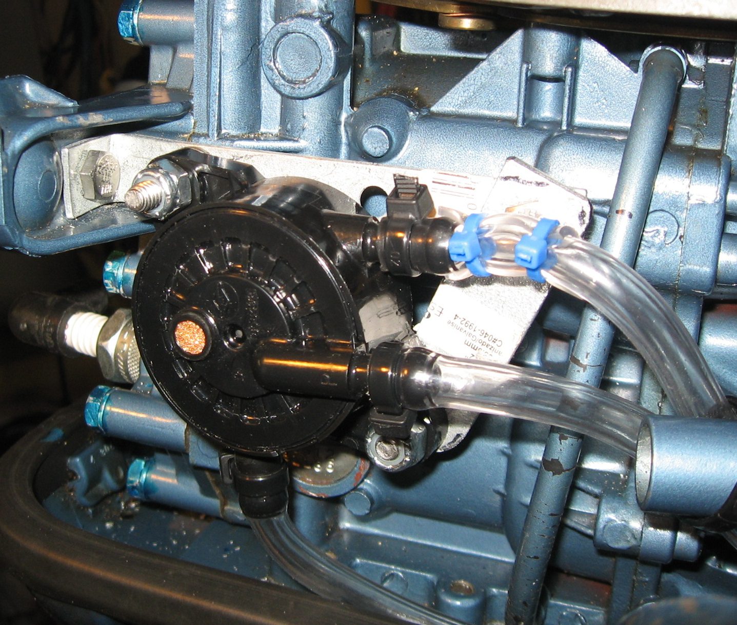

      just FYI… tried to get a nice 10hp Evinrude going this week (modified it last winter for a pump on a plate) everything looked dandy …good compression .. started on a second pull with choke
      died after a 10 second run with a short RPM increase.
      no reason to do so yet it did several tries later I pull the carb and checked it out . perfect
      silly thing started to run while hand pumping it
      I loaded the carb with fuel got it going and pulled the fuel line to the carb….and no fuel was getting pumped out to replenish the carb πŸ™
      put in a new square pump… same thing
      both pumps look fine except they leak air if I do a directional flow test OUT to IN and I could hardly get any of no air IN to OUT
      I had noticed this last winter when I checked my 5 new arrivals at $6.99 CDN each !!!
      conclusion… 99% certain I got a bad bunch of pumps and will be modifying with a nice round B&S pump with a pulse nipple on the cover plate instead . At least I know th B&S pump passes the directional blow test
      opened both up looks perfect….they have metallic check valves that seem to work yet they leak air … almost like the layer gaskets aren’T doing their job of sealing the various sections.
      i’ll try to fin d my purchase history and feedback to the seller. πŸ™

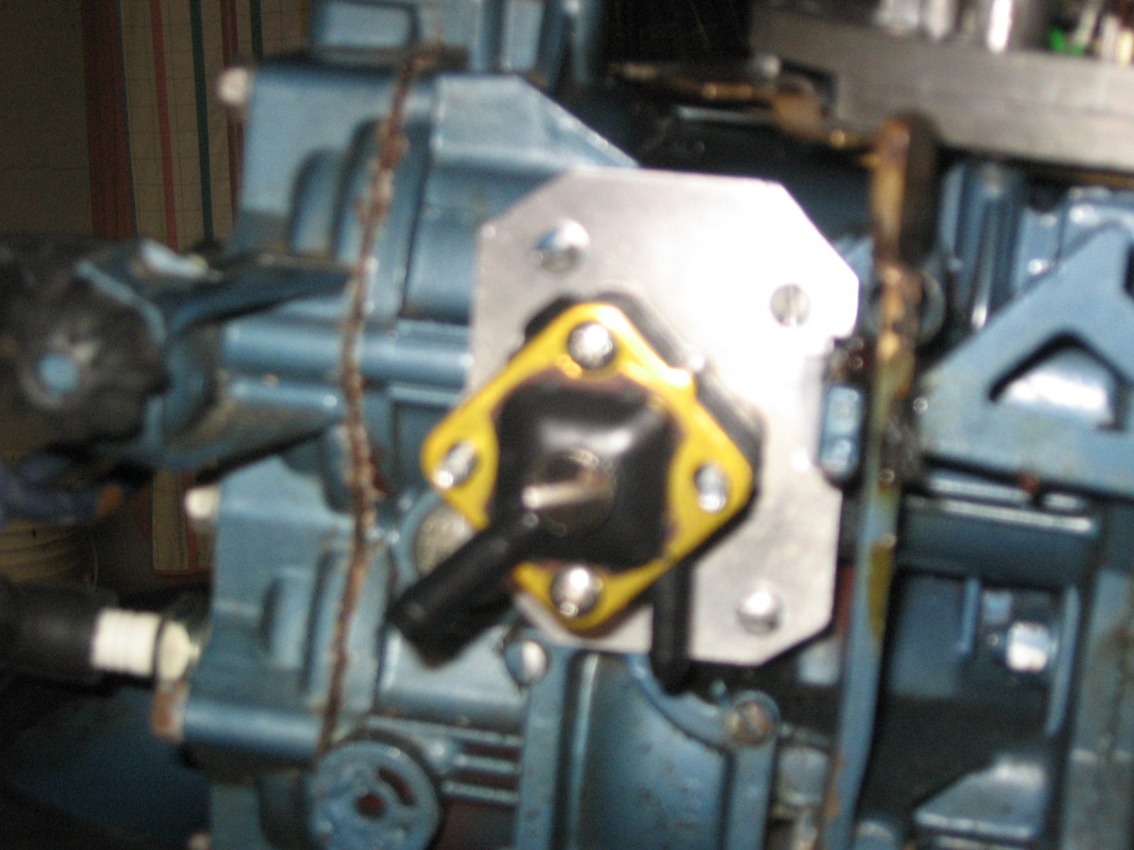

            ordered the pumps from AMAZON feb 21 5x$6.99 One member suggested they leaked but would probably seal up when BOLTED solid which added 2 more bolts on the corners
            but I had no fuel pumped out.
            ok at $7 each not a big loss but I wrote the seller to express my opinion maybe he will come around and send 5 pumps from his good stock …
            In any event I’ll go B&S which passes the blow test 100% and mounts just as well
            all I need is the extra nipple /hose to the bypass cover..available on a 10hp done it before on a 7.5hp see picture…using the modified air pulse nipple behind the carb.

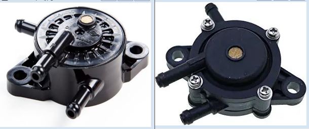

            CHUCK
              For one thing…..there are TWO versions of that style pump. (The black one in the post above this one)
              There is another version that uses screws to hold the thing together.
              I would definitely suggest that you use the screw version.
              I have a couple of the un-screw models…..and they pop apart within a few minutes of running.
              Interestingly …..the “Genuine” Briggs pumps sold for $40 at mower shops have the Briggs logo on them and are the Un-Screwed version. Not good!
              Chuck
