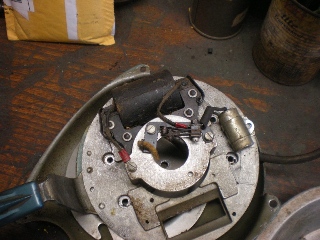

      well i need help again . just landed a real clean champion 2J . no spark , coil has many cracks and crumbling . its a cylinder shape held on by clips . any ideas on a replacement ? thanks in advance
      #230027
        Here’s what the coil looks like in case anyone is wondering.
        I did not have to replace the coil on mine. Perhaps an OMC
        coil retrofit would work on this single cylinder engine?
        2J17e
        #230051
        Robert Neymeiyer
          Appears to be an early Bendix Scintilla ignition. I know coils are available and look the same but wires come out on one side. Condenser is more of a challenge but can be made.

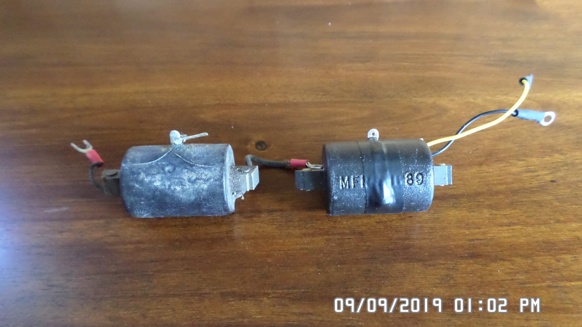

          #230377
          kirkp
            You can relocate the nub where plug wire connects.
            Old Bendix vs. New conversion…….copper foil tape glued & soldered to a properly located solder tab for the plug wire ….two wraps with electrical tape and sealed with corona dope……easy and cheap
            coil-fix
            #230395
              KirkP, interesting about the copper foil used. Is there a benefit in
              using that rather than soldering an insulated wire from the
              original secondary post to the new one, other than it would
              be a little thinner?
              #230508
              kirkp
                Buc, I personally have not done this conversion but have been following discussions on another board. It was stated that using wire was difficult due to clearance issues. Here’s something another person wrote. “I got a piece of K&S brass strip about 1/4″ wide. I bent it to fit the contour of the coil, soldered one end to one of the little solder terminals on the side and JB Welded the brass strip to the side of the coil.”
                I’ve also heard of someone using heat shrink.
                Hope that helps
                Kirk
