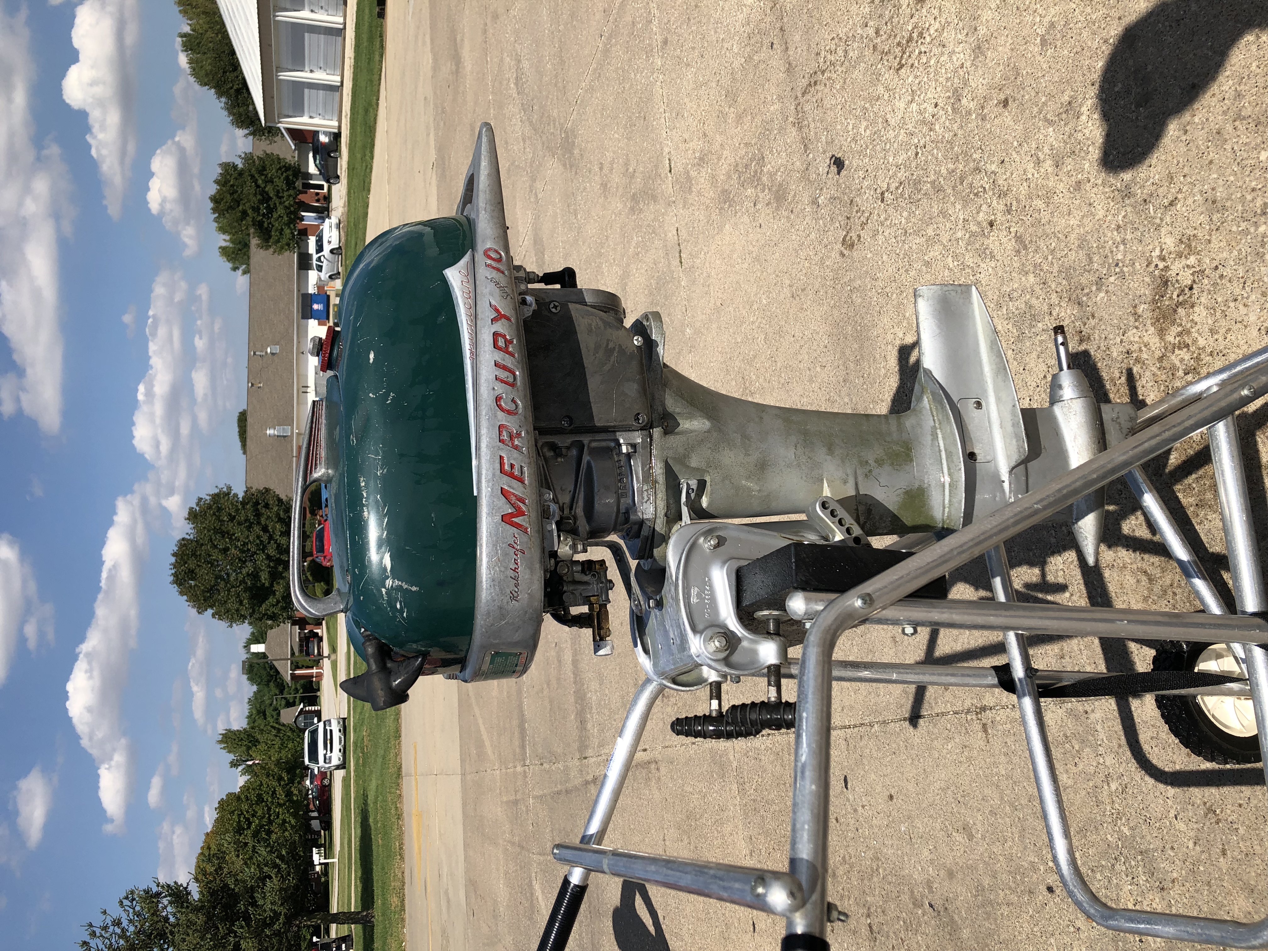

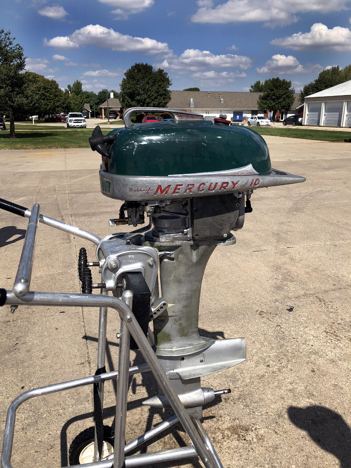

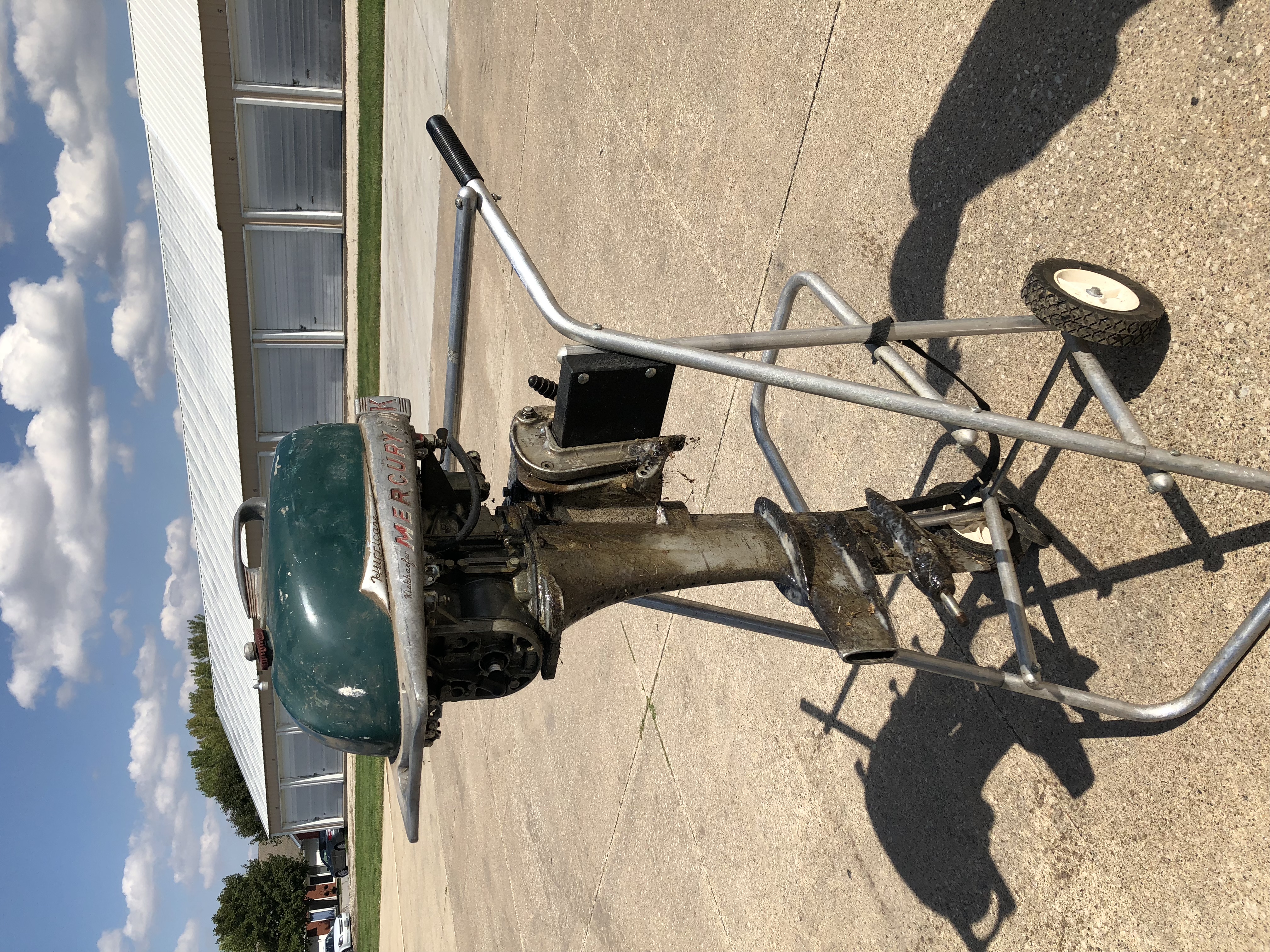

      This weekend I was cruising the Facebook for sale boat motors. Because as I stated before, my wife thinks it’s junk… and I like sleeping on the couch.. anyway I saw a merc for sale so I decided to pop the picture up, and at the bottom it looked like a pointy lower unit. So I sent the pic over to my dad, and we made plans to go pick it up. Cause my mom doesn’t share our enthusiasm , I figured I might as well get him in trouble too. So we get to the guys house, and there is a KG7 on a q tower! Score, I don’t think dad could throw the 100 bucks at the guy fast enough . Even had the bottom cowl with it. The motor has good compression, and everything looks great other than no spark. Which leads me to the question, does anyone know where to get coils, points and condensers for it? This winter my dad, my brother and myself will be building a hydroplane to put this thing on. He’s 15 and super excited to get into the hobby.
