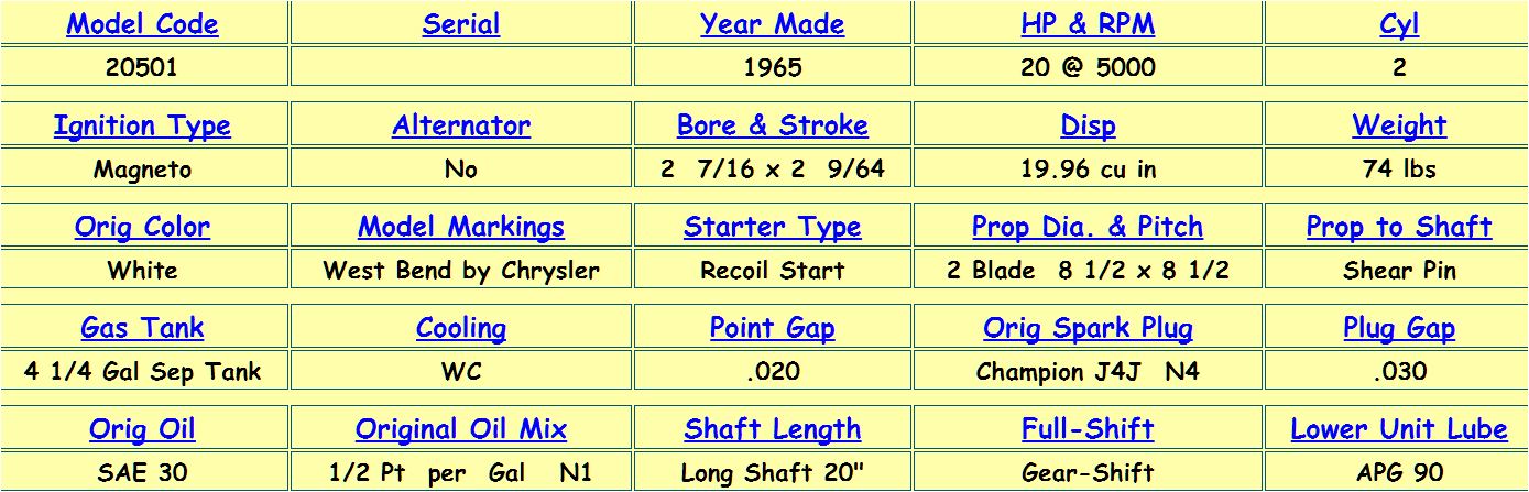

      Just had a Chrysler 20hp dropped off. Model 20701. Serial#3723. I haven’t come across one of these before. Any info would be greatly appreciated. Thanx, Mike.
      #67394
        The model number identifies it as a 1967 model. Chrysler bought out West Bend in about ’65 so this motor would be one of Chrysler’s early ones. Based on the West Bend motors, Chryslers are well engineered and often not appreciated for it. The specs for it will probably be similar to the 1965 20501 model. Note the 16:1 fuel mix.
        #67414
        CHUCK
          Interesting Specs Mumbles…..
          Is that your own personal spreadsheet….or is there a source out there somewhere that you can point me to?

                quote Seakaye12:
                No, not mine.
                I lifted it from these guys.
                http://www.discount-marine-parts.com/
                http://www.discount-marine-parts.com/ob_chrysler_1.html l
                #67438
                elgin2
                  Thanx for the info Mumbles. I don’t think I`ve seen a 4 1/4 gallon gas tank.
