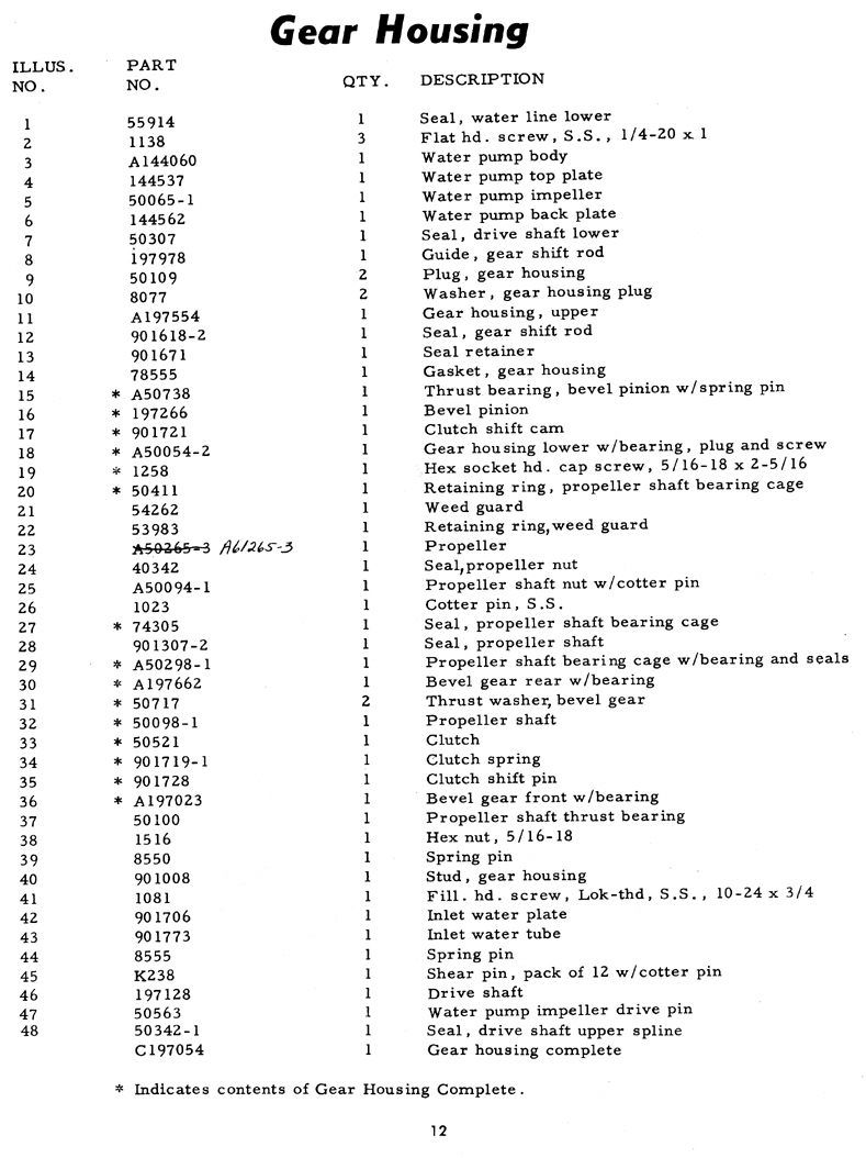

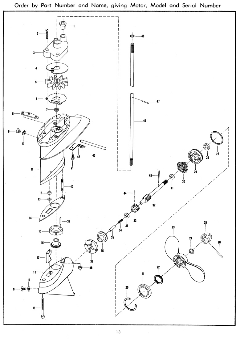

                    I’m not sure if this helps or not but here’s a PDF on the 5 1/2 – 9 HP Benders.
                    #69049
                      This is Chrysler’s 8 horse Sea King . . .
                      How close in it ? ? ๐Ÿ˜•
