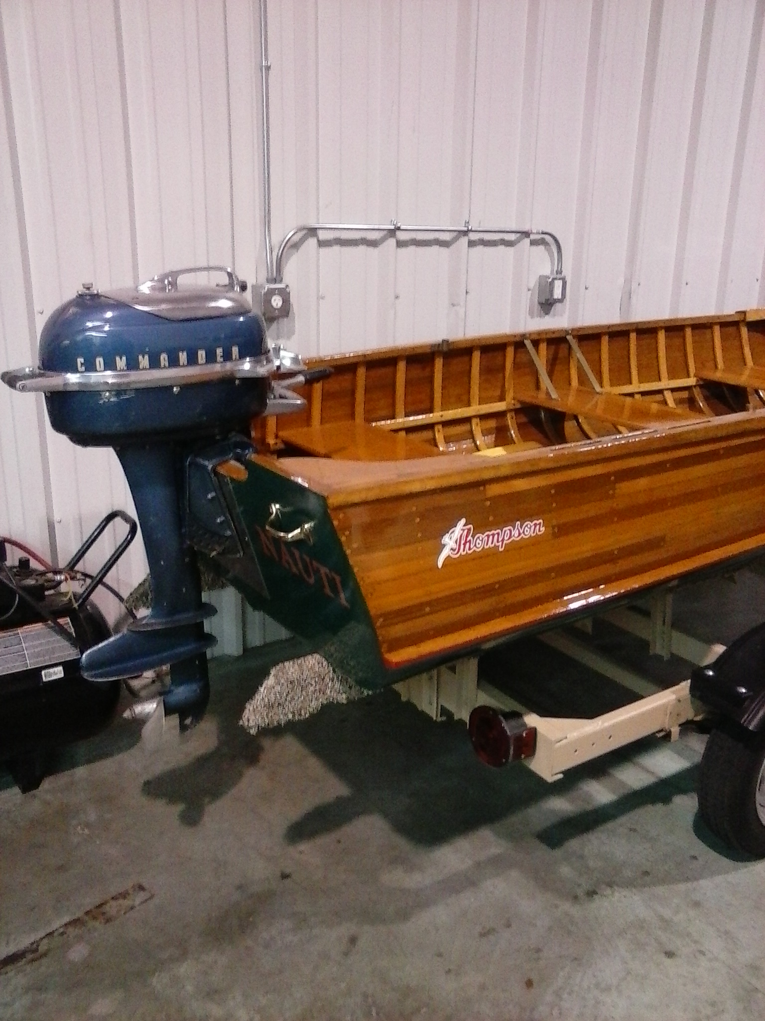

      Here is my ”runner” Commander. It is original except for the polished recoil. I did this because someone before me already sanded this part down. The paint and decals are original. That’s why I chose not to restore it any further.

        I know nothing about paint but wanted to say nice rare motor & good luck with it.
