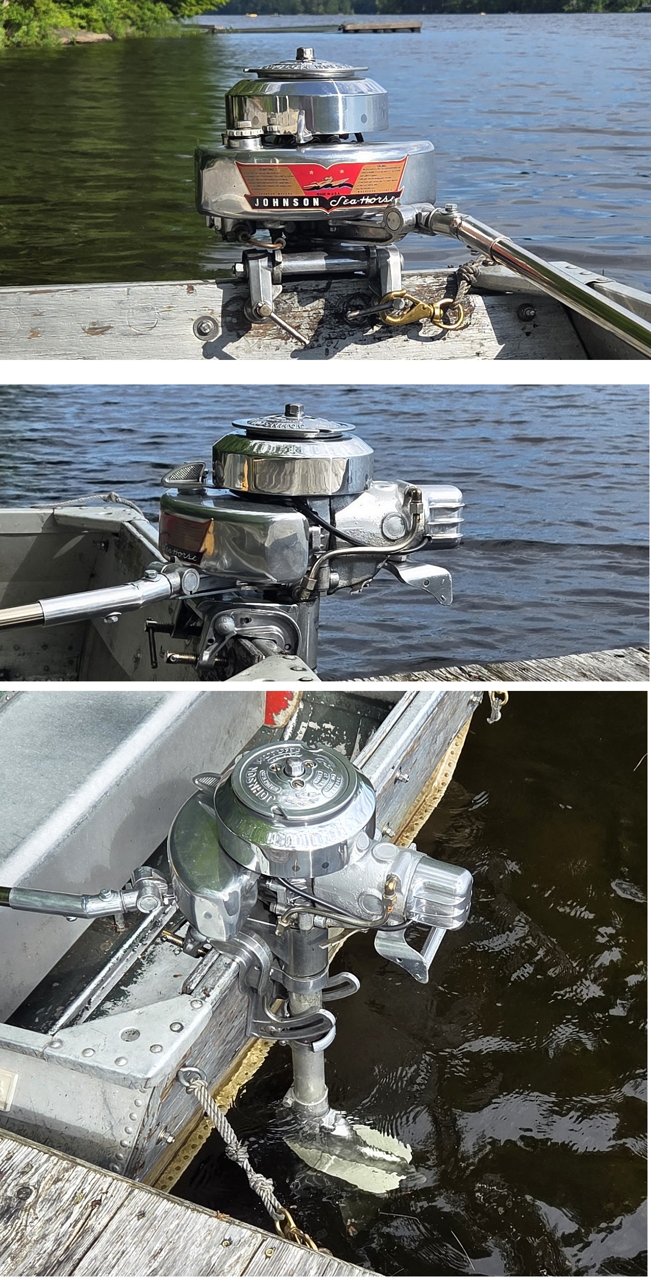

July 4, 2026 at 11:58 am #323631
Got this motor many many years ago. It had lots of issues, including needing the pump seals that Lloyd provides. This summer is the first time I’ve ever had it on a boat. It took a couple days for the seals to break in, I would have to pull the plunger back up, but now they are working great. No Leaks!! Great product. Thanks Lloyd.
July 4, 2026 at 12:37 pm #323635July 4, 2026 at 10:23 pm #323669Tubs – beautiful motor!!
"Every time you remove a broken or seized bolt an angel gets his wings."1 user thanked author for this post.
July 5, 2026 at 1:08 pm #323750Beautiful job!! Congratulations!!
