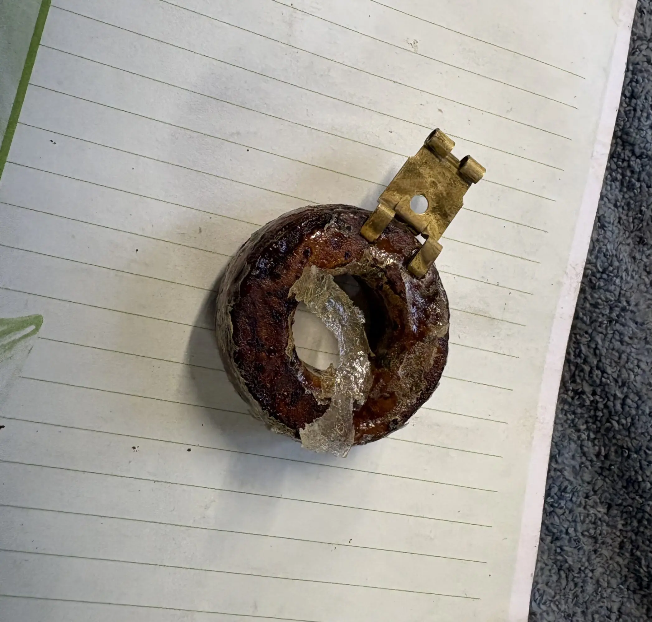

      I coated a float with crazy glue a couple years ago on a 7.5 HP Johnson.   I pulled the carb off recently and the coating was pealing off and plugging up the works!  Not gonna do that again!

        There is a product that is better suited to this job than Krazy Glue. Some use model airplane dope to coat their floats. Personally, I never use anything to coat them. If they are naked and they float, they’re good to go. If they sink, throw it out and replace it because once the cork has shown it will absorb fuel and get heavy, there’s really no saving it except for a sawhorse queen motor. Closed cell foam floats are far superior and its easy to work with as far as cutting it so maybe consider making floats if you can’t purchase replacements.

          After having the same thing happen to me and reading here that cork floats didn’t need to be sealed, I started this little test to know if in fact that was true. Over 9 years later that cork is still floating. I’m away and cant provide the latest result but I found this image from an earlier thread.

          #322696
            Very impressive testing procedure

                I love that test Mister Tubs!   It’s done with ethanol fuel!  Imagine that!  I run ethanol fuel in everything I own.  Thanks for posting it again.

                  Yup I have a couple kits in my stash.  That particular float was is good shape so I thought I would give it a try.

                      I’ve used Butyrate Dope and althought not “Tubs Tested” it seems to be doing alright thus far.
