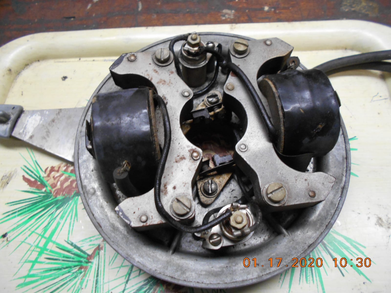

      I tore the magneto apart on the 1946 twin cylinder Mercury KD4
      to clean and “freshen up”. For kicks I checked the coils out with
      the ohm meter. First one tested okay, but the second coil seems
      to have an open secondary. Retested several times, but always
      with the same result. Strange thing is that this motor seem to run
      good in the test barrel last Fall.
      I’ll throw the coil on the Stevens when I get a chance for a second opinion!
      The laminations are 5/8″, so not a direct swap for an OMC universal coil.
      Do the laminations on these Merc turn out okay if you grind them down
      for an OMC coil?
      I’m still having flashbacks of the attempted coil swap on a twin opposed Neptune
      with the single Eismann coil. Never did get the B&S coil or the John Deere pony
      motor coil to work out on that one!
      Thanks.

          I don’t have a LOT of engines with Eismanns but I have not seen a bad Eismann coil, yet. Just the opposite of Bendix. You’re going to want some new condensers though. If you have a Stevens, do a leakage test on the condensers. My bet is they will not pass that test, even if the engine was running okay.
          #192490
            Will check the coil on the Stevens and go from there.
            I haven’t bothered to check a condenser on the Stevens
            since I first got it. I just always replace or retrofit with
            capacitors, and from what I remember, the Stevens
            seemed like it was needing a “tune-up” when it came
            to testing condensers.
            #192554
            lyks2tinkr
              In my experience all the Eisman coils I’ve seen are bad with the exception of 1 on a Neptune 6hp opposed twin. That coil measures good and throws a nice hot spark.
              The secondary windings must have been wound with extra fine wire that just didn’t hold up.
              On the coil you have that measures bad but still runs the motor.
              The secondary winding is probably broken but the spark is jumping the break. Sooner or later that gap gets too wide and the coil will permanently die.
              #192555
                I checked the coil on the Stevens today. It fired nice at about 1.7 amps.
                I’d have to look at what the specs are for that coil.
                Then I went to the coil that check good on the Ohm meter,
                and couldn’t get it to fire on the Stevens. Not sure what was going
                on, but after about 4 tries, monkeying around, it fired at about the same
                amps as the other coil.
                Time will tell if Tinker is correct about the open winding!
