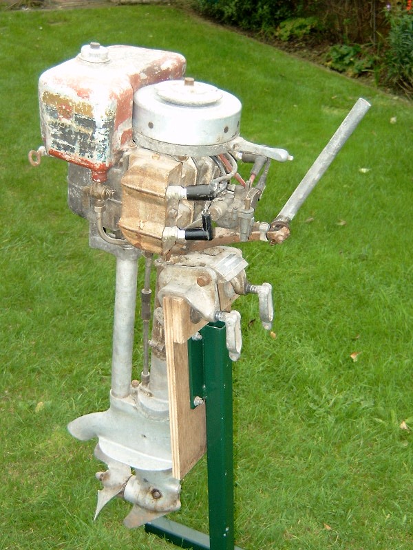

                Here’s a pic of the project.
                #66570
                  Those are Lightfour Imperial cylinders. The Handifour was dropped because it was thought to be taking sales away from the more expensive Imperial. Mechanically they are identical. They also share some parts with the Midget Racer. The Lightfour Imperial was good enough to take our AOMCI treasurer, George Emmanual, on a 100 mile cruise up the Suwannee River a few years back. . . 😆

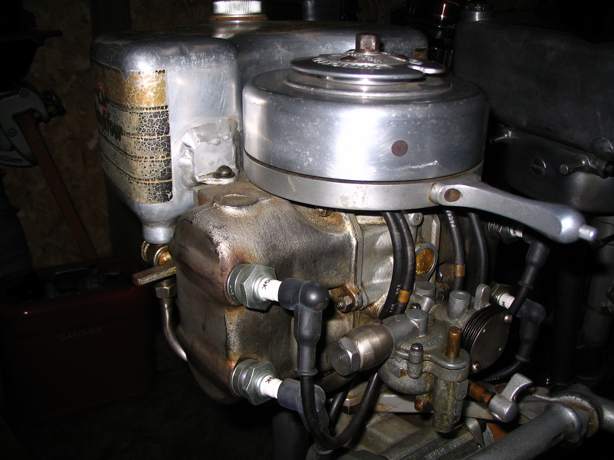

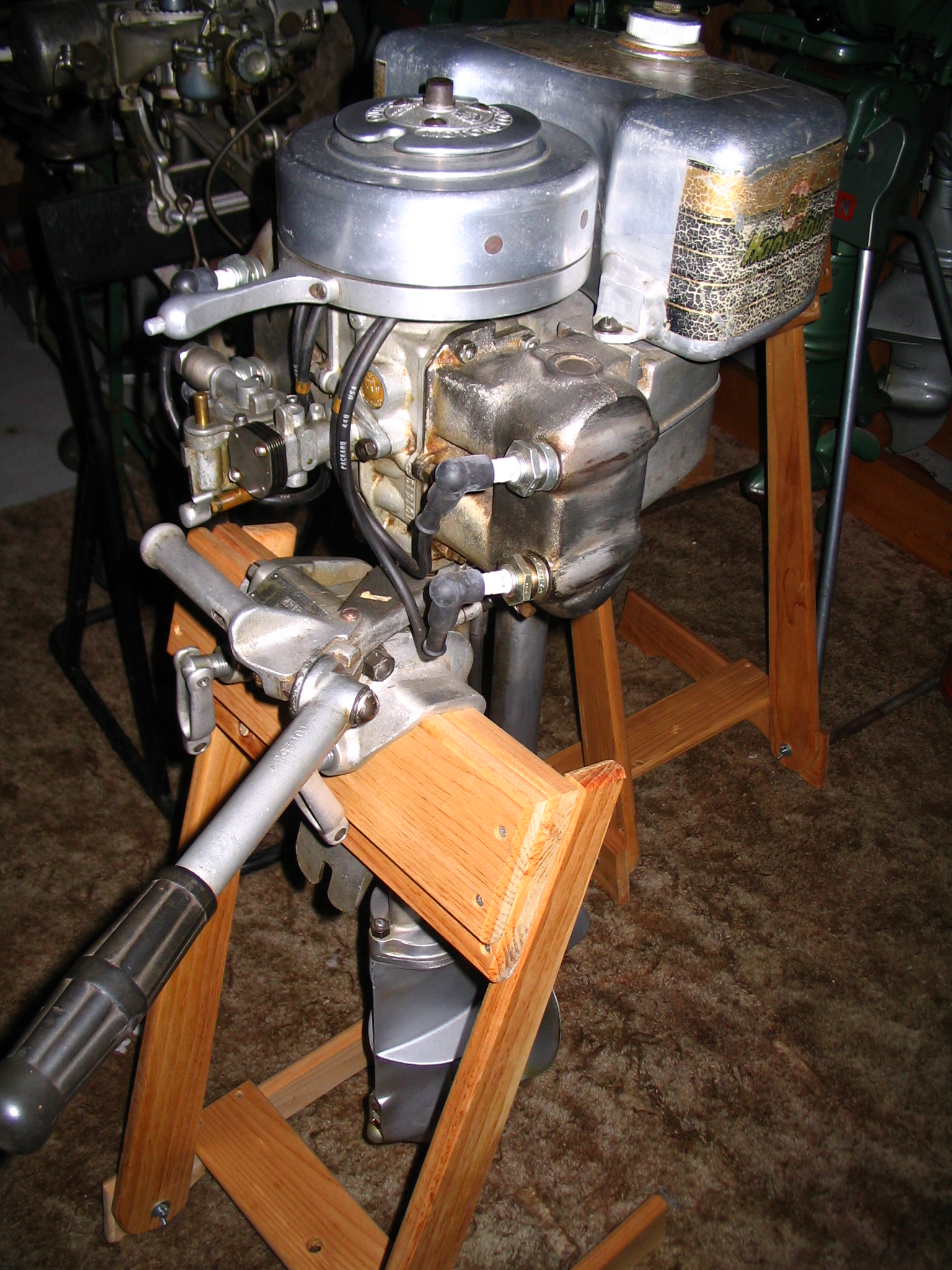

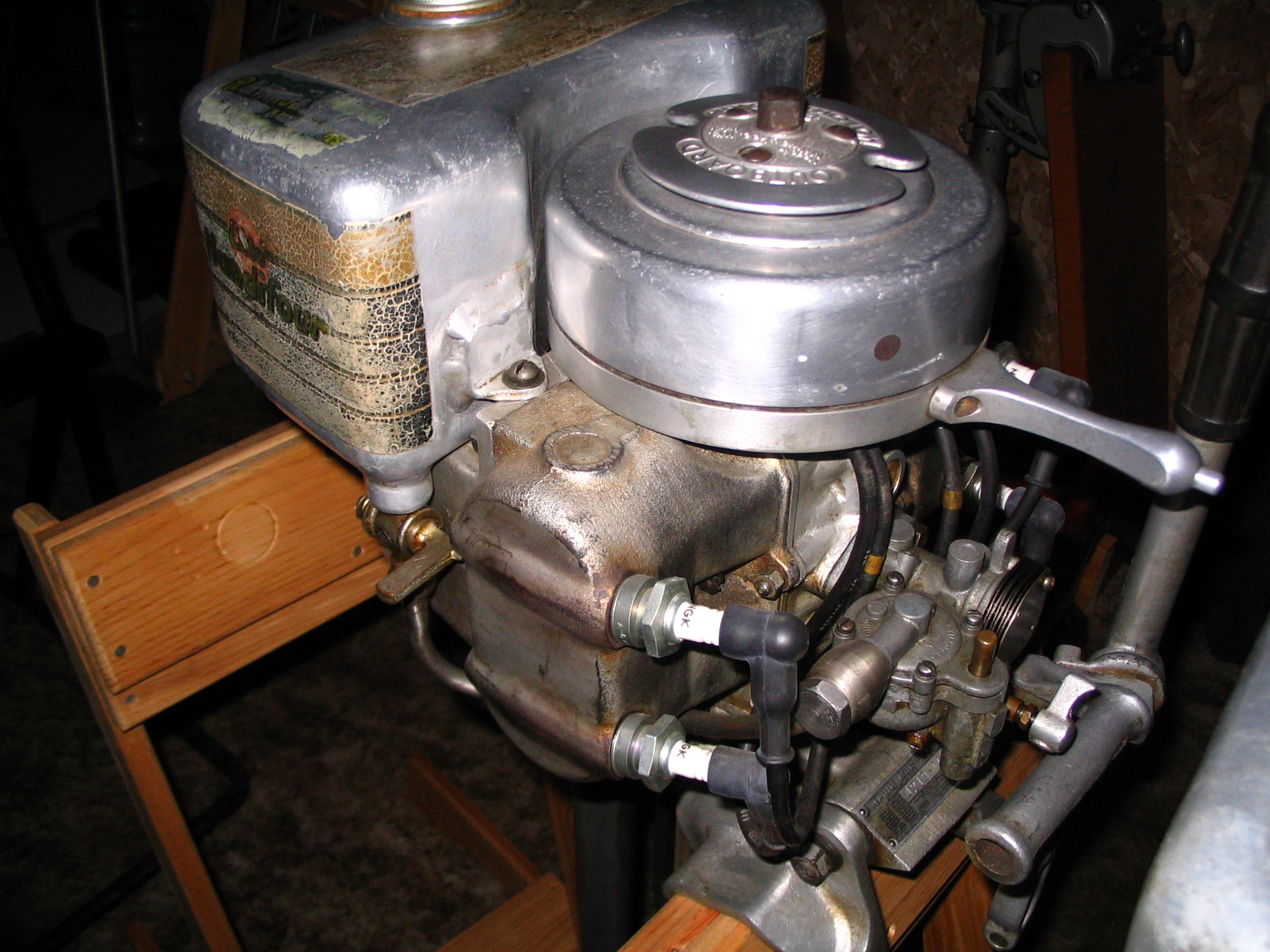

                    Garry is right, those are Lightfour cylinders on the motor you’re working on.
                    I dug out some images of a Handifour that I have on my hard drive. You can see the physical differences between Lightfour and Handifour cyclinder castings
                    Hope it helps.
                    Best,
                    PeeEmm TeaTwo

                        Interestingly, the Elto Handifour project has matching core plug and saddle model numbers – 4219, with serial number 00074, so the addition of the Lightfour cylinders is a mystery. Probably a later modification..it being UK too, not many of either the Lightfours, or Handifours around.
