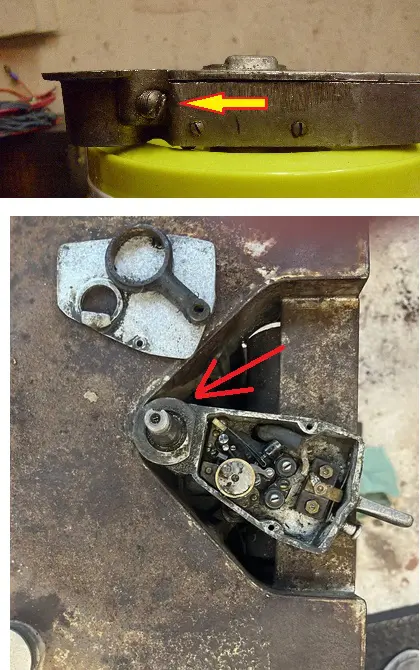

August 13, 2026 at 3:46 pm #326261Success! I was able to remove this stuck flywheel with a two arm gear puller. Came off very easy. Inside the timer box looks relatively clean and with a brass bushing. Question, the timer box is frozen in place and will not move from side to side. Does it just come straight up off of the crankshaft or is there something holding in place?. I can just fit the two arm gear puller underneath it. I don’t wanna break anything.
August 13, 2026 at 6:15 pm #326289Success! I got the seized up flywheel to come off very easily with a two arm gear puller .I opened up the timer box and it looks pretty well clean in place. Question, the timer box itself does not move at all. I’m not sure if it’s rusted to the crankshaft or what I can just barely get The gear puller on there to pull it straight up, but I don’t wanna break anything if that’s not the right move right now. I’m just lubricating it at the crank a lot and waiting. What am I missing?
August 13, 2026 at 6:18 pm #326293August 13, 2026 at 9:03 pm #326298the timer comes straight up … do not force it. Apply snake oil of your choice and a little heat. I recall that there is a tensioning screw with a friction plug ,, look for that and loosen. You are not showing the “dog bone” shaped link that goes from the eccentric under side of the flywheel and the pin on the AK timer? do you have it? Some of these were die cast metal and did not survive.

You may not be able to get to the tensioning screw Joe mentions. Using a torch, or heat gun on the 1500 watt setting, put some heat at the arrow. This will expand the aluminum. At the same time try moving the timer back and forth to free it. Wiggel it off before it cools down. Might need gloves.
August 14, 2026 at 3:37 pm #326339Got it off! With all of your advice I soaked the end of the crankshaft and timer box for a few days with penetrating oil and heat and started gently tapping on the timer box handle. The box was really tight but slowly started to move, enough together access to the tension screw mentioned by Joe. It would not lift of the crankshaft so I placed the two arm gear puller on it and slowly worked it side to side for an hour and it worked!!!! Now to get the power head unseized LOL.
August 14, 2026 at 4:09 pm #326343Success… also I see in your last photo that you do have the “dog bone” link. Just a note about that link, there is a small oil hole through the arm, helps move a tiny amount of oil from the crankshaft area to the timer. be sure that the hole is clean.
