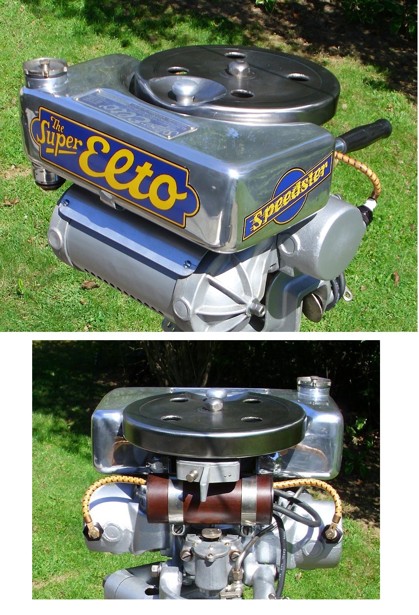

            I removed the remaining nickel
            and polished this flywheel as Chris
            has described. Not nickel but better
            than paint IMO but you need a nice
            flywheel to start.

                BTW Tubs the flywheel on that Speedster looks superb, and proves that the old cast iron will polish up nicely if you’re willing to put the work in on it.
