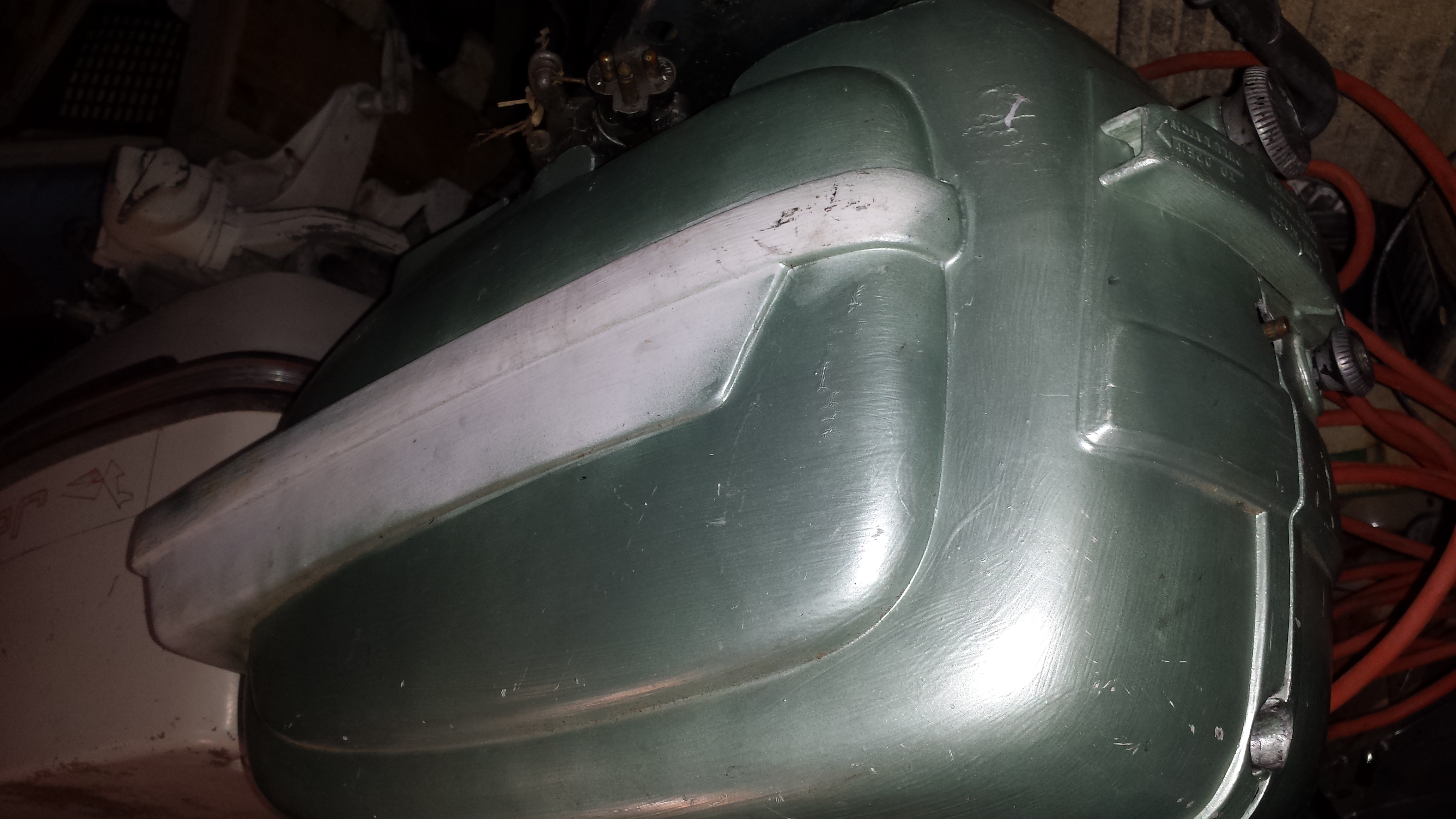

      I picked up an Evinrude that has a "custom" paint job. It looks like a 1953 or 1954 15 horse. The motor mount has been changed to a QD-10 mount so that model and serial number info. doesn’t help much. The Exhaust Cover does have a number from the casting and is 203252. The motor shroud has a number 203264. This motor has a label indicating it was supplied by OMC in Canada.
      I was wondering if anyone could confirm the model and year from the part numbers above and the photos. Sorry about the orientation.

        I agree, looks to be a 53/54 Evinrude Fastwin 15hp….

          Another vote for the ’53/’54 Evinrude Fastwin 15hp. I have a ’54 SuperFastwin myself and I’d say this is a spittin’ image with ‘custom’ paint.

            Absolutely Super Fastwin! The decals on the ’53 were a sort of blue gray, while the decals on the ’54 were black.

                Evinrude 10 did not come to the market, till 1956. Anything earlier, was a green Johnson QD. And yes, that is a Super Fastwin 15. 53 and 54 was called the "Super Fastwin" because they were a vast improvement over the previous 14hp Fastwin. 1955, the Super was dropped from the model name. 1957, they were bumped up to 18hp and vastly improved again.
