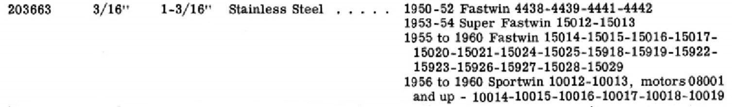

                      I would look up the part number and run the correct shear pin.  Just out of an abundance of caution.  The shear pin was designed to give out at a certain level of force, such as if the prop hit a rock or something.  It is there to fail before the prop strike can damage your engine internals.  Hopefully you find this useful.
                      https://external-content.duckduckgo.com/iu/?u=http%3A%2F%2Fwww.aomci.org%2Fwp-content%2Fuploads%2Fattachments%2FProp%2520Chart%2520Johnson.jpg&f=1&nofb=1&ipt=7a09906df174ab78649234d9ed46c550459c48233422af6d2390ddb45c022fa5&ipo=images
                      #274925
                        What was your old pin made of, stainless or brass?
                        Since your Fastwins prop has a rubber hub which should slip when hitting something hard,  Evinrude originally called for a stainless drive pin, 3/16 X 1-3/16 in this case. Not a brass shear pin.
                        Evinrude-Drive-Pins
