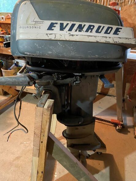

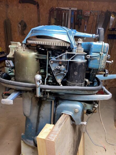

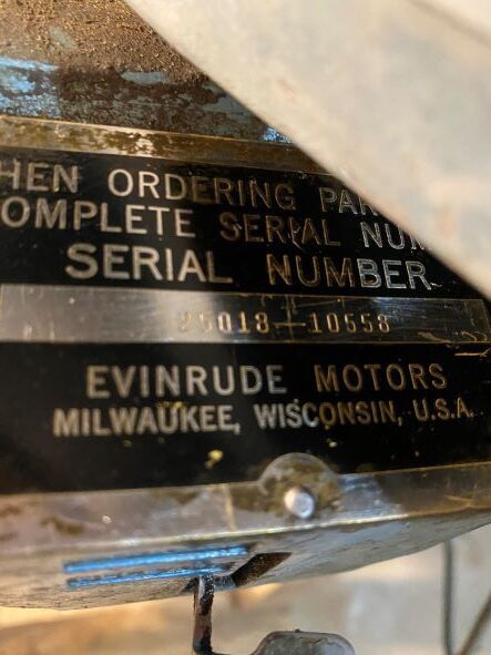

            Shamus
              There’s no doubt about the serial number and the fact the motor has electric start, see photos below. The serial number is 25018-10558, which puts it squarely in the defective gear seal category. It seems to have the proper clamshell cowling for an Aquasonic. I guess it’s possible that this is a “Frankenstein” motor, cobbled from parts, but I don’t see any obvious indications of that, but what do I know? (Nothing). There’s definitely no choke solenoid on the bottom of the carburetor, but I can’t get a photo of it unless I tear it down.

                trex014
                  That motor shows signs of being seriously overheated at some point in its life. The whole powerhead should be the nice Evinrude blue but the head looks brown which is a result of overheating.
                  Check compression and shine a light into the spark plug holes to look for any internal damage.
                  Check the powerhead just behind the back screw for the recoil assembly, theres a little silver plug that has serial and model number stamped into it, if that matches the ID tag then your motor is not Frankensteined.
                  #245589
                    Manual start and electric start motors look the same except for the presence of starter, choke, mercury switch, wires, etc on the electrics. And of course the decals.
                    #245590

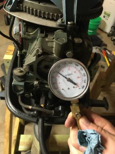

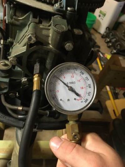

                    Shamus
                      Thanks for that info. That little silver plug has the same serial number. The compression check done by the seller showed about 100 on each cylinder, if I recall. When did Aquasonics start being available with electric? So I still have the same problem – This model (25018) is not supposed to have electric start but it does.
