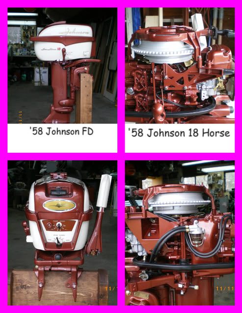

April 19, 2023 at 1:46 pm #275309In my recent FD-12 project, I found the flywheel had a slight wobble to it. During the dismantle and restoration, I found someone had stuck a shim piece inside the flywheel hub and there were some cracks around the flywheel puller holes. Not good. I would surely pull your flywheel off and take a closer look – if it has a wobble, it may likely be bent. I would probably be on the safe side and replace it. As Frank noted, if a flywheel lets go while running, it’s not a pretty sight.
