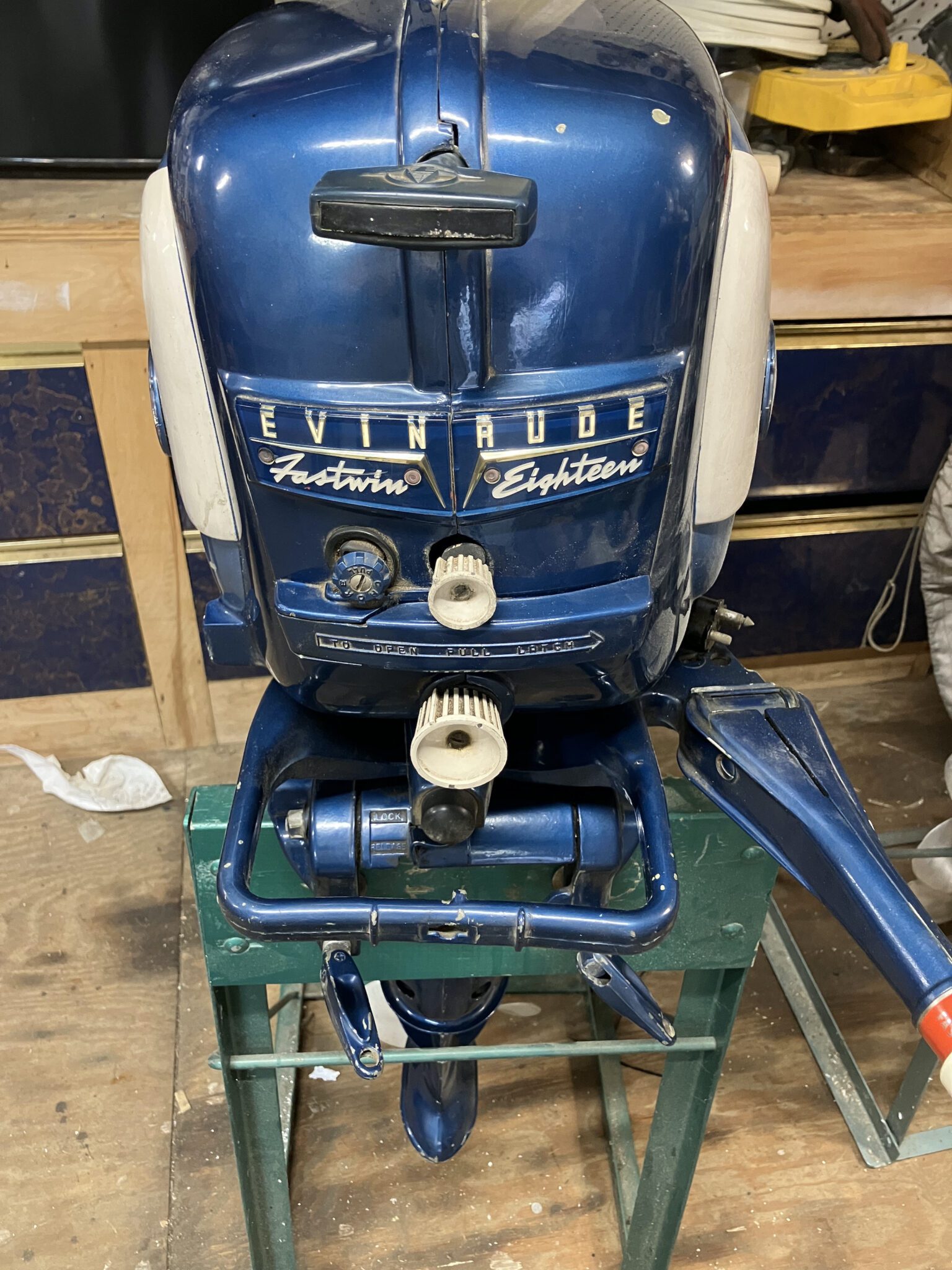

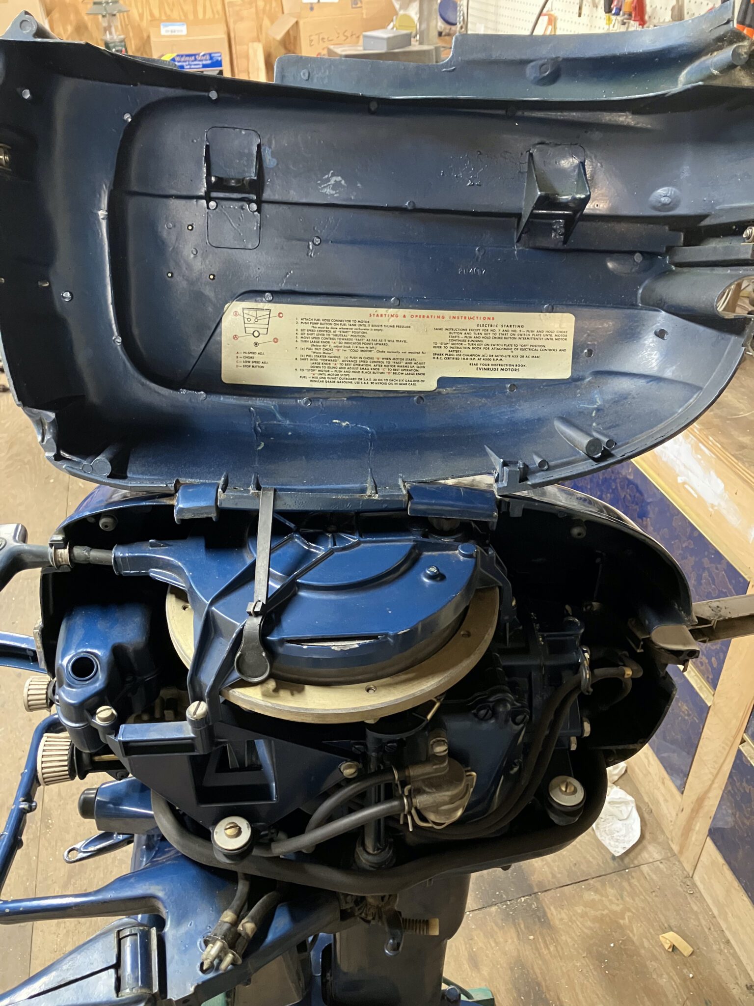

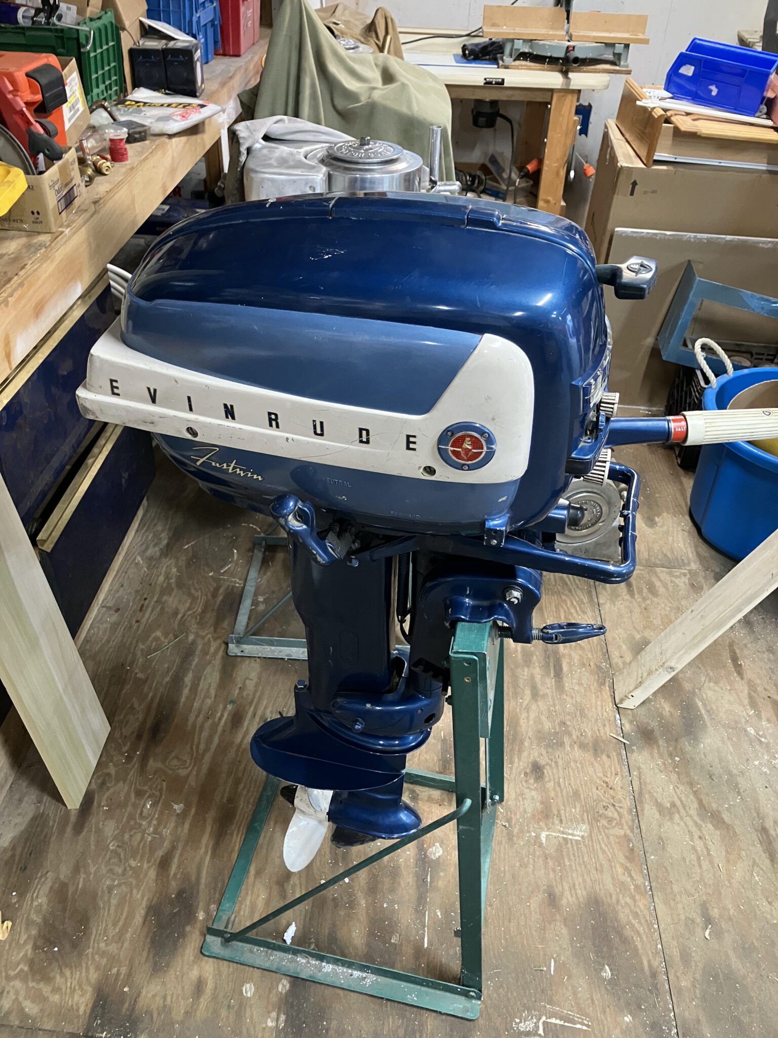

I recently acquired a motor I have been after for a while. A 1958 Evinrude Fastwin 18. My grandfather had one when I was young and I have many great memories of him and his boat and motor. This is NOT my grandfathers actual Evinrude, but it is the cleanest one I have found to date. It is free, but has been in storage for about 60 years, so I put some Deep Creep in the cylinders and will let it set for a few days before I start peeking inside.
I have attached a few photos along with a picture of my grandfathers boat and motor at his island camp on Ambajejus Lake in about 1960.

November 3, 2025 at 4:26 pm #301173it is not even dirty… I would send it back 🙂
Kidding… fantastic find ! with new coils and if it smell gas it will start on it’s own : -)

Boy o boy, what an amazing find, and for free? Beautiful

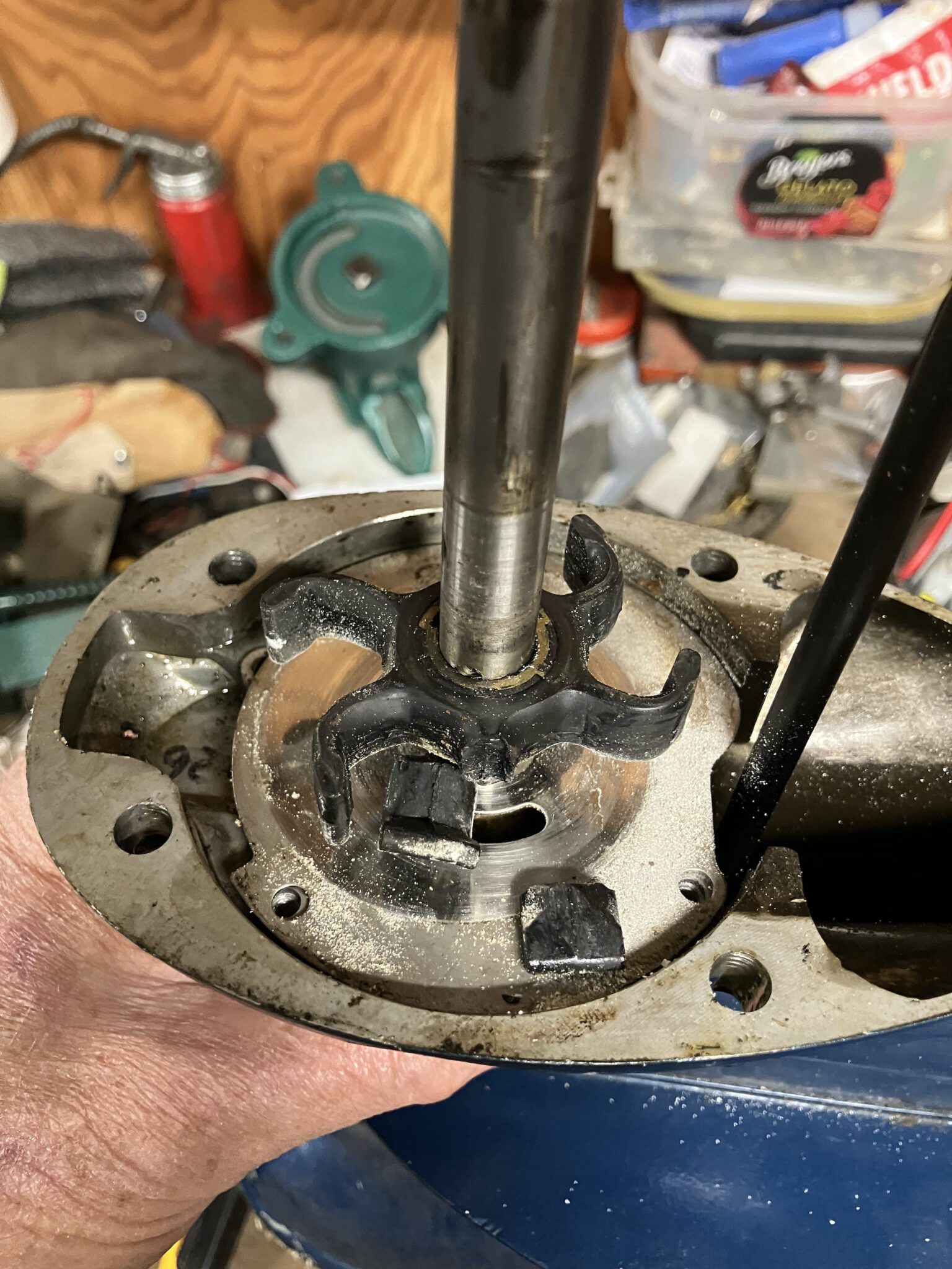

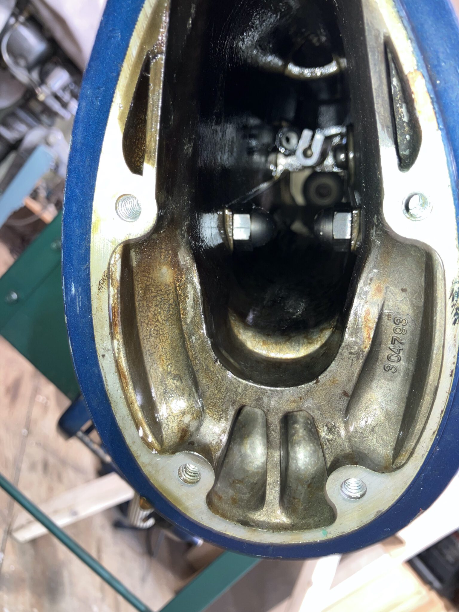

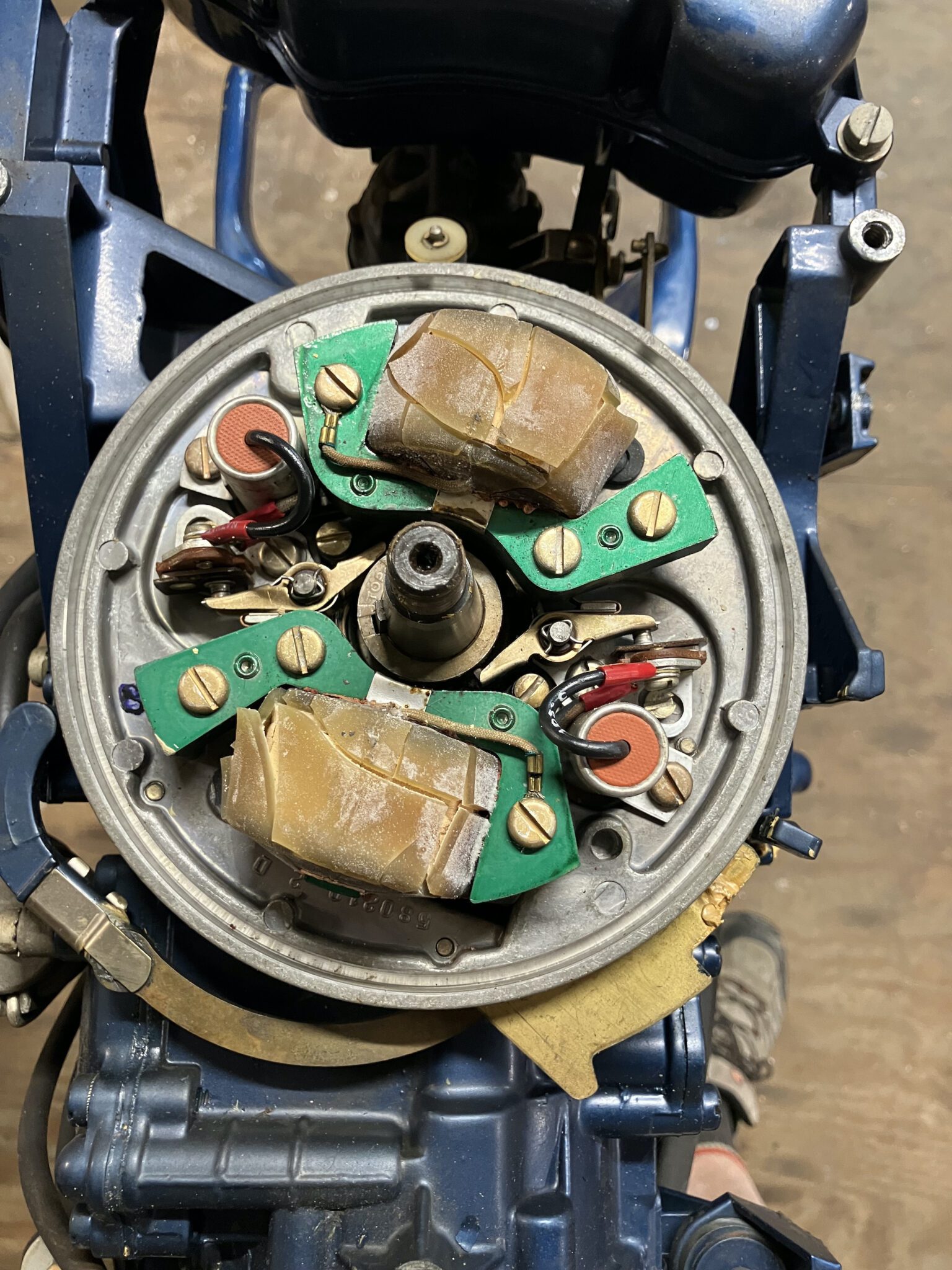

I pulled the flywheel and the original coils are cracked as expected. The impeller was broken but all the pieces were there.None of the screws show any signs of prior work. The exhaust leg is still shiny inside!
I would be surprised if this has run more than a few hours.

November 3, 2025 at 9:03 pm #301192You would be hard pressed to come across another OMC classic that’s any cleaner than that beauty. It still has the factory shine on the paint. Great find!
"Every time you remove a broken or seized bolt an angel gets his wings."November 4, 2025 at 7:29 am #301194greats pics to!! that coil shot is worth a 1000 words for newbies… mind if I copy and reuse it ?
November 4, 2025 at 7:49 am #301195Crosbyman,
By all means you can use it!

Oh, that makes sense… “Free” as is not stuck! Those rotten coils are a good sign, no one has messed with it, low hours. Wonder how the impeller broke, someone spun it backwards perhaps. Great to see all the pieces still there! Enjoy it, I’m envious for sure.
