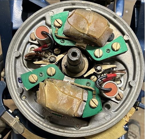

          When bad is good. Did you get to thank the guy that has been saving that motor for you?
          Coils

            #301246
            David Bartlett
              Tubs,
              Nothing I like better than seeing coils like this!
              David Bartlett

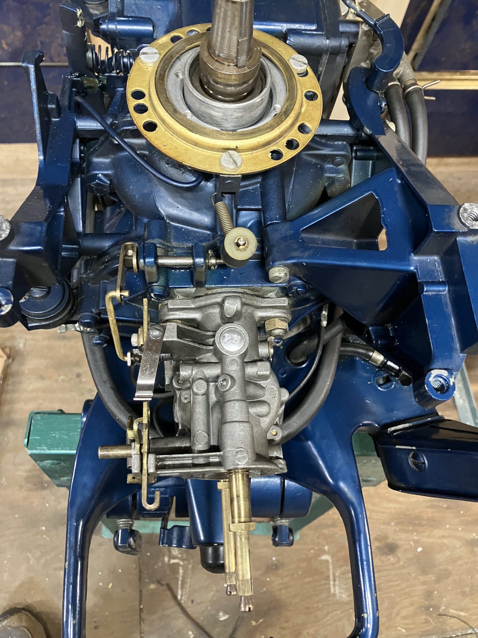

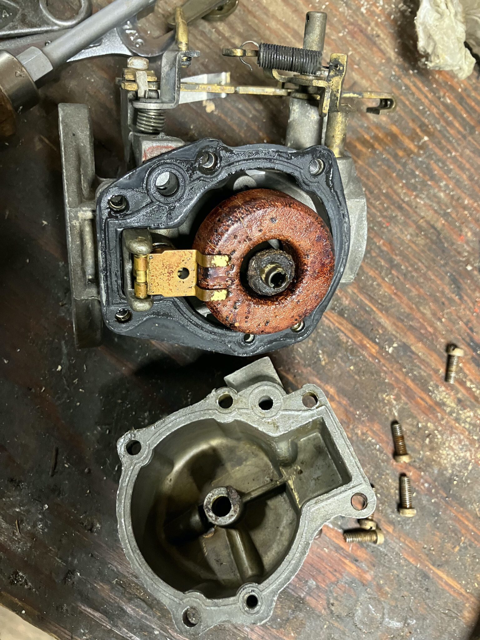

                Today I cleaned the carb and stripped the magneto while waiting for new coils and condensers. I have a supply of NOS points, so I polished some and installed them and put the “old” ones in my spare parts pile. Will put the coils in when the Brown Truck shows up!

                I put my initials on the welch plug on the carb because I do good work!

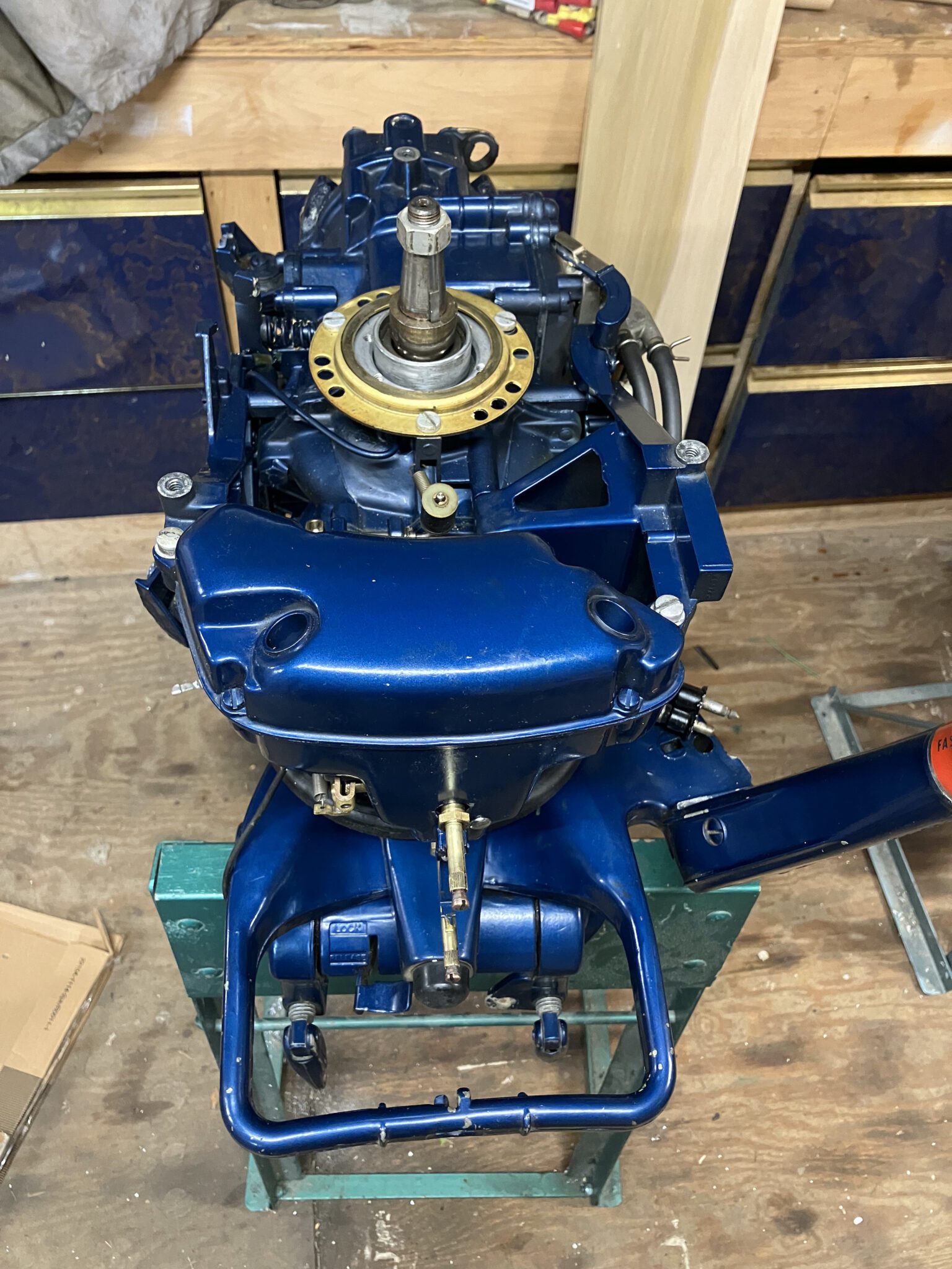

                    #301266
                    Sam M.
                      Nice find!
                      I can’t help but wonder whether or not it was even run long enough to complete the break in procedure…  Just in case, might be a good idea to give it extra oil for the next few hours of run time and keep varying the rpm to help preserve it as best as possible.👍
