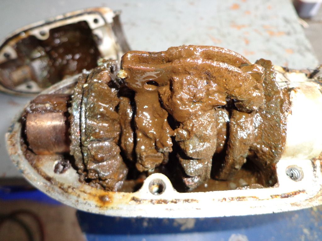

                If the old oil comes out contaminated or you suspect water has been sitting in it for a while, you might want to consider taking it apart for proper servicing. 😮

                  What 1956 OMC gearcase come from. I believe any mechanical should be cleaned up spotless. Only way to do a good inspection or run it. I would take anything apart if I was going to trust it across the water. Not only clean out but to measure wear on the hard parts. Looks like the Nasty Brothers owned that, Wash that thing out!
