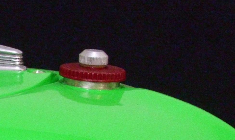

              Its best to leave a gap in the paint around the gas
              cap. Mumbles should have an example of what this
              "Helps" to prevent.

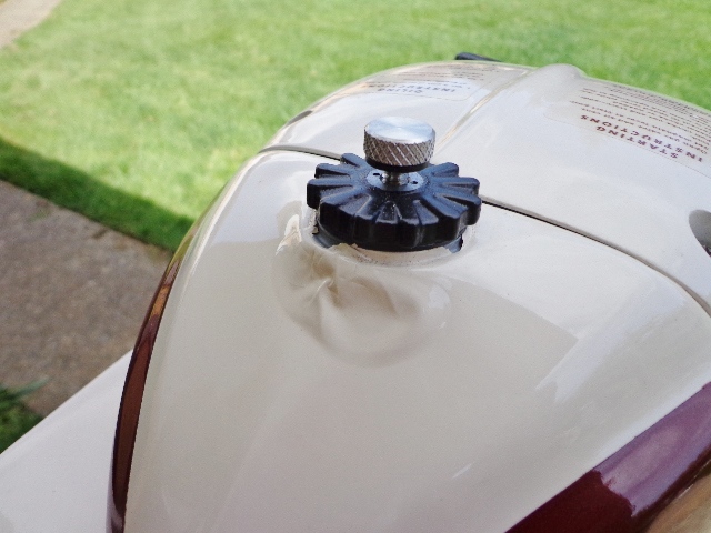

                  Being in a hurry, I never masked the top of the fuel filler properly on this Johnson JW tank and I paid the price as the mix got under the paint. The paint shouldn’t have lifted or bubbled the way it did. Thanks for the reminder Tubs!

                      Thanks Garry. Yeah, it was kinda cute except for that one flaw. Here you can see where it wasn’t masked on the filler. Funny thing about it, after sitting for a few days, the fuel mix must have gassed off as the paint bubble settled down and could barely be seen.
