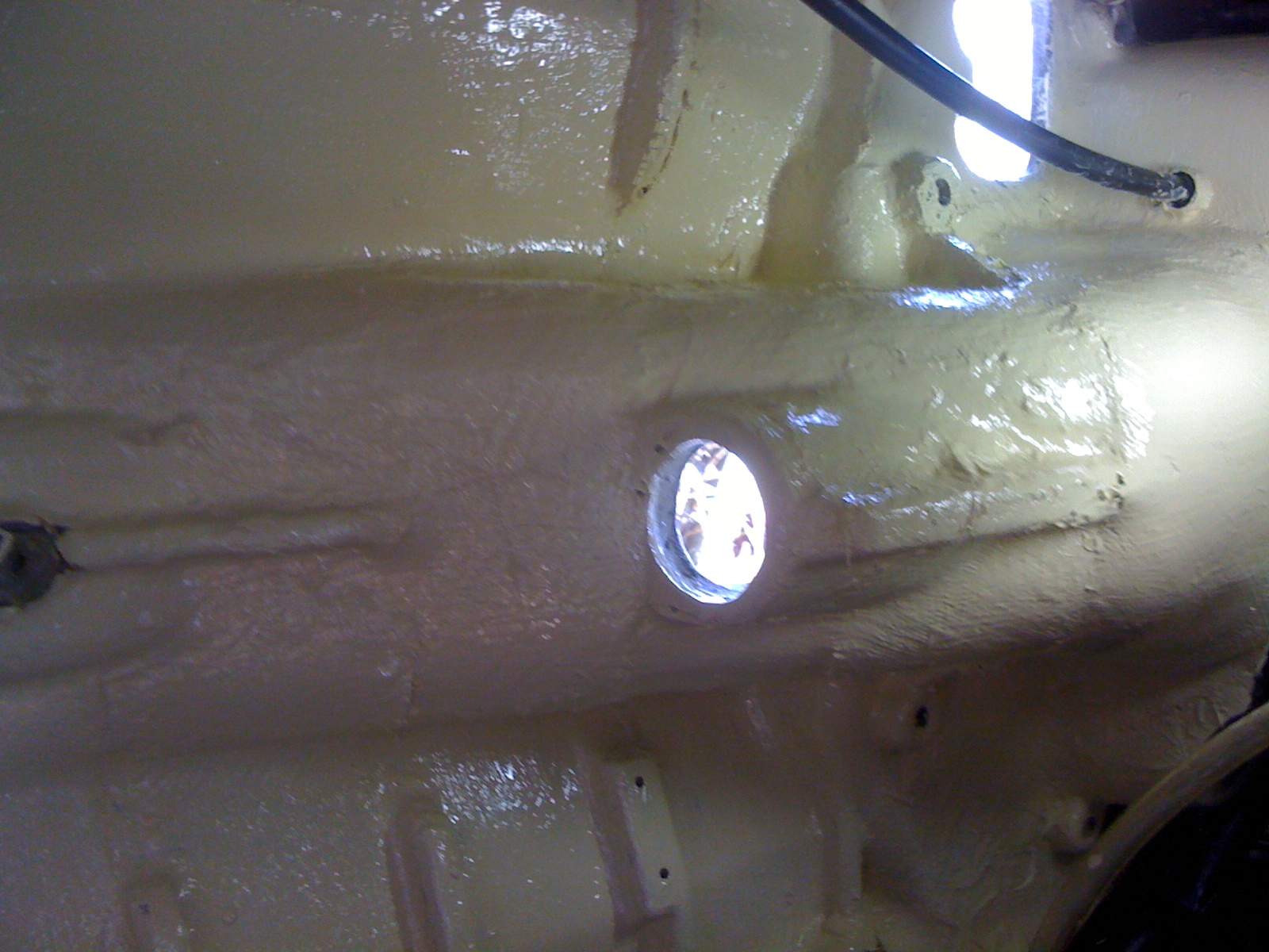

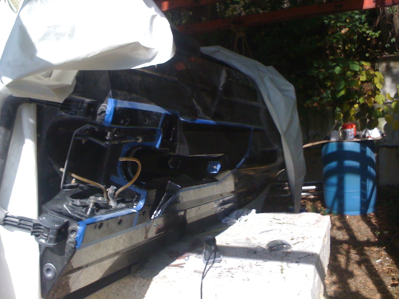

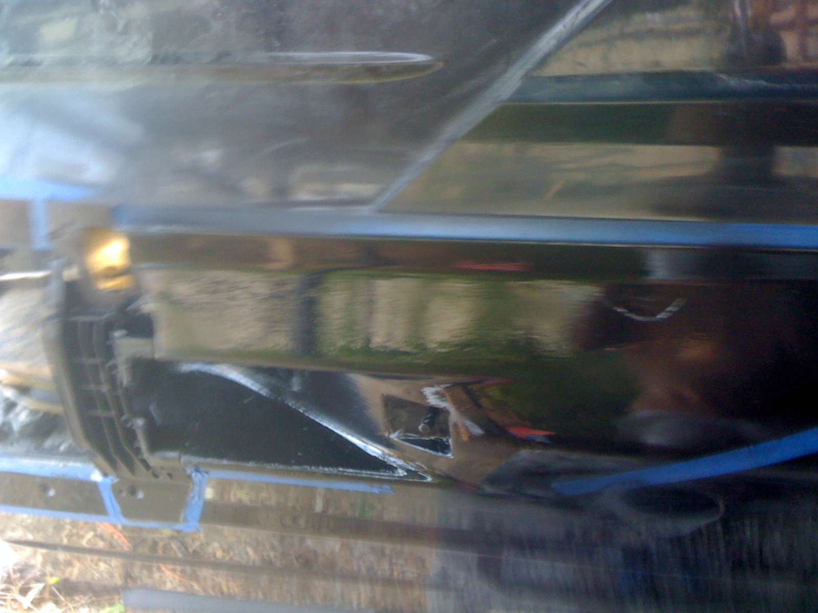

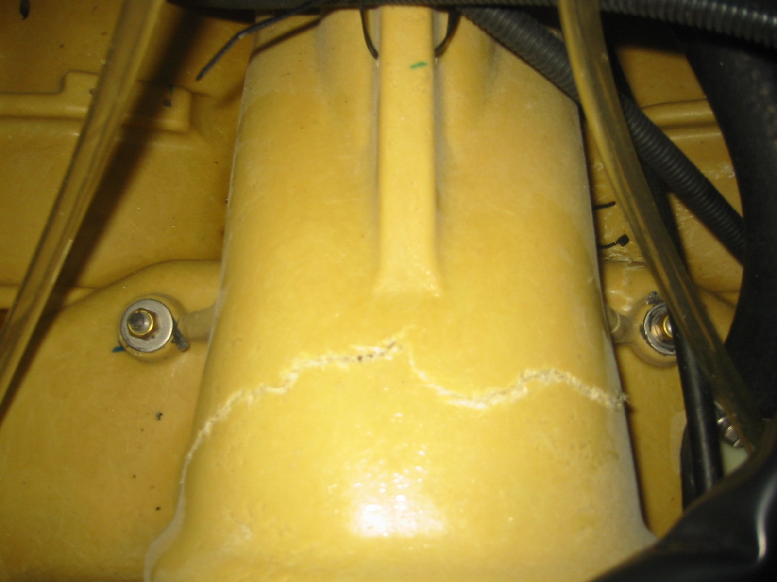

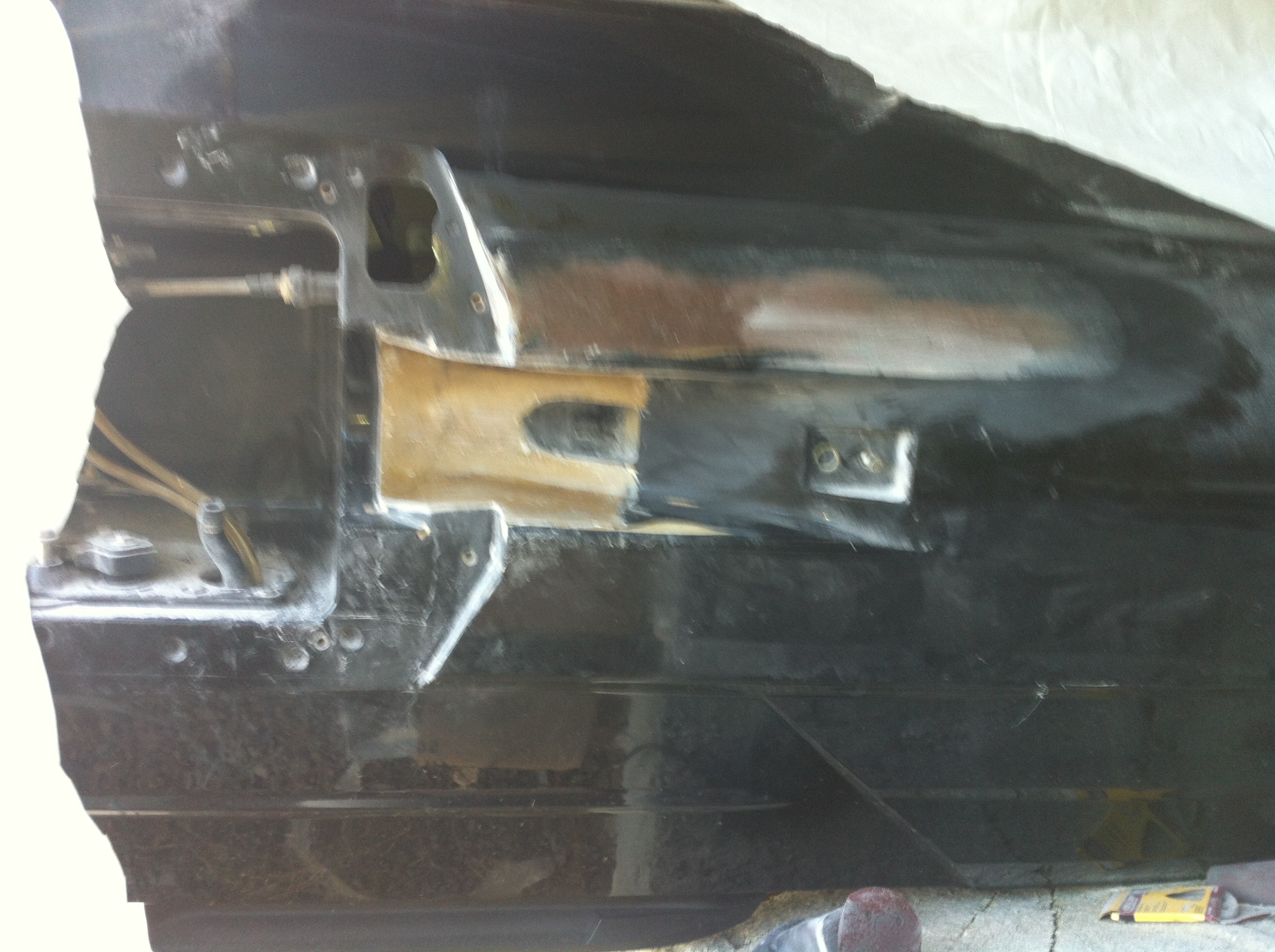

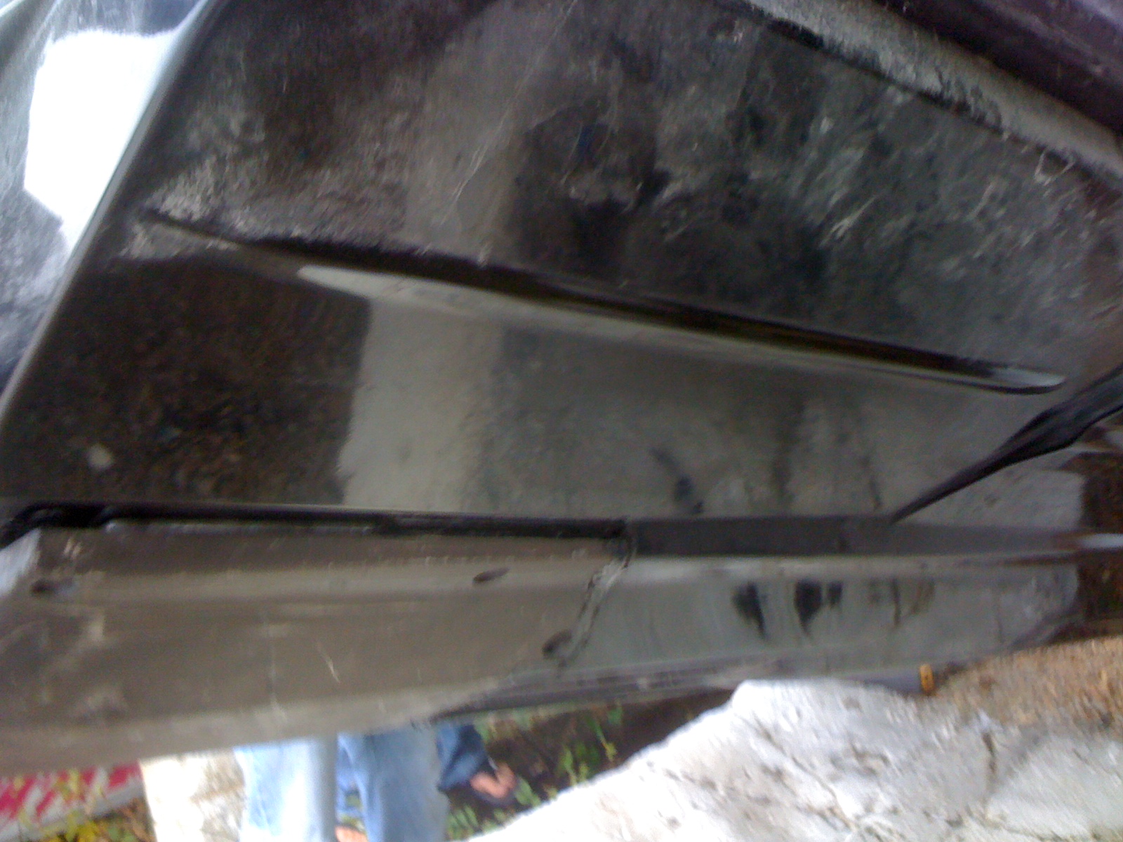

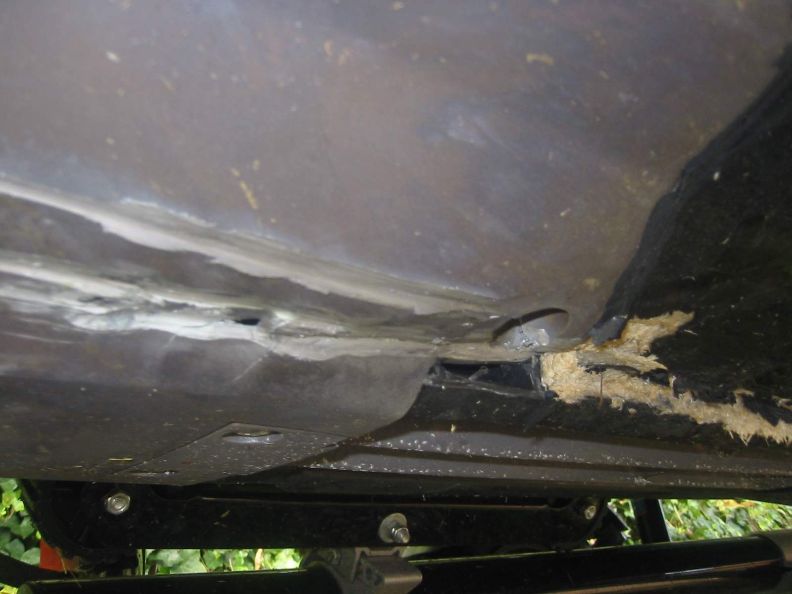

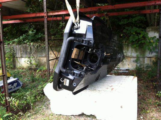

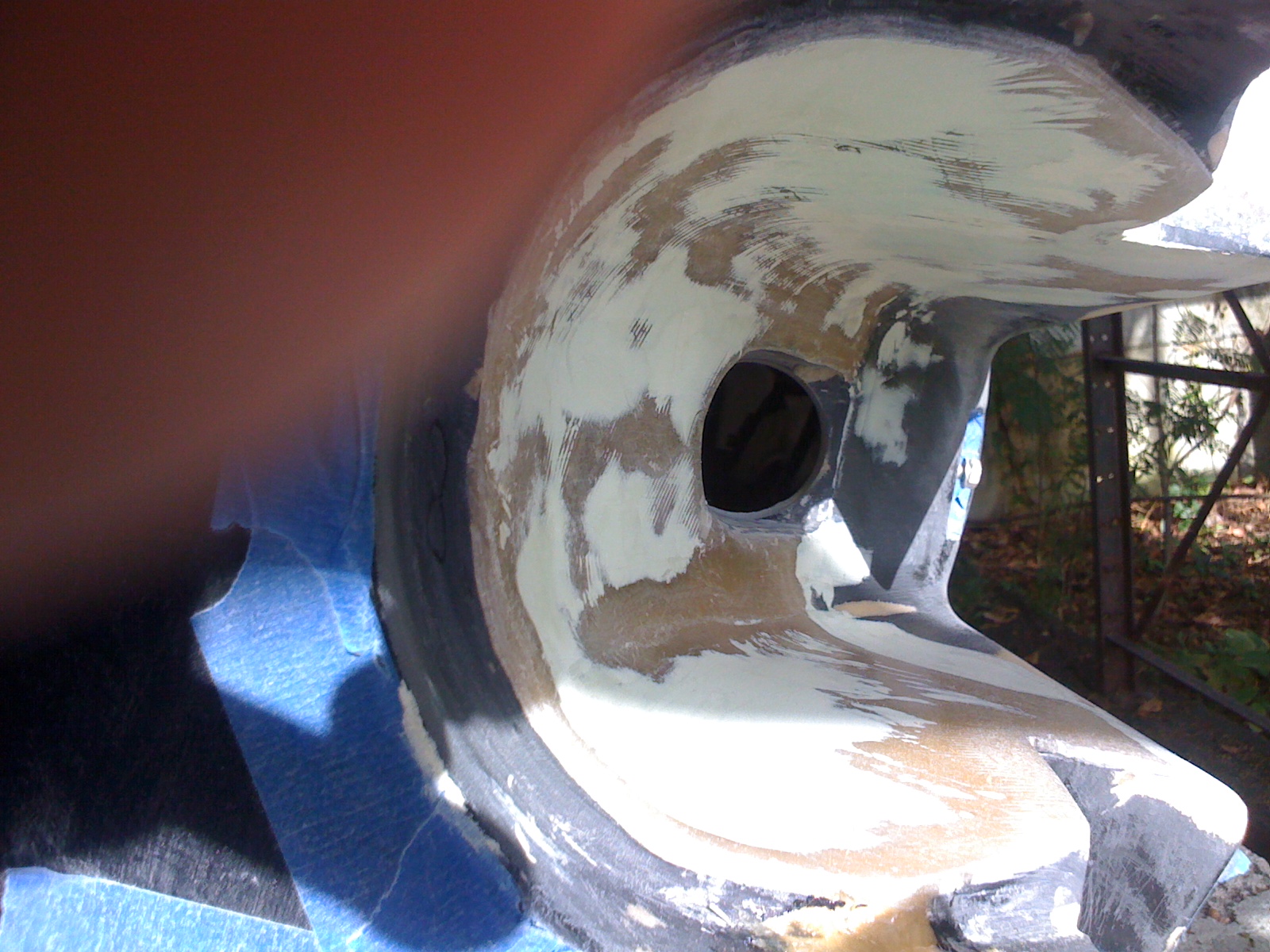

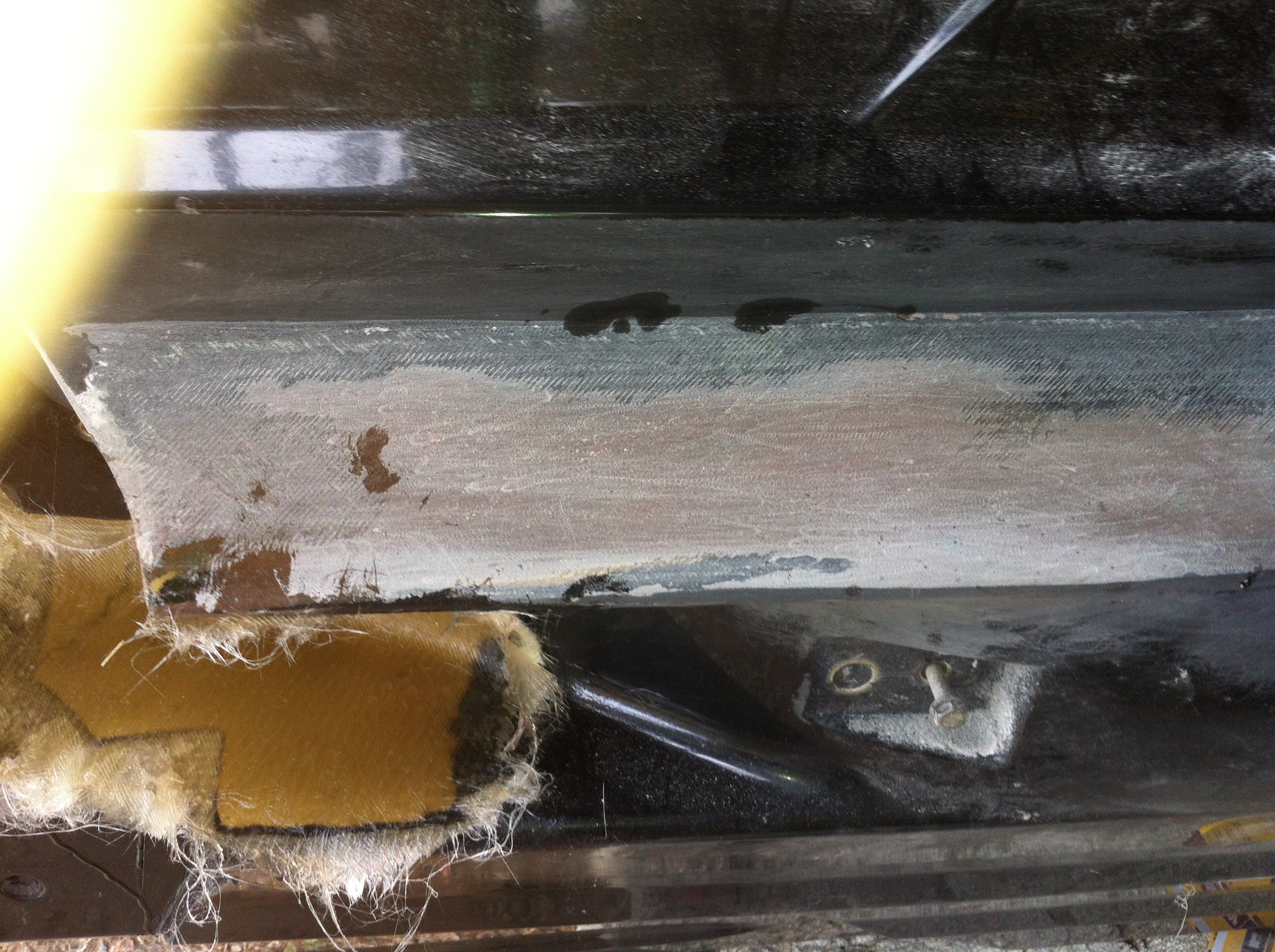

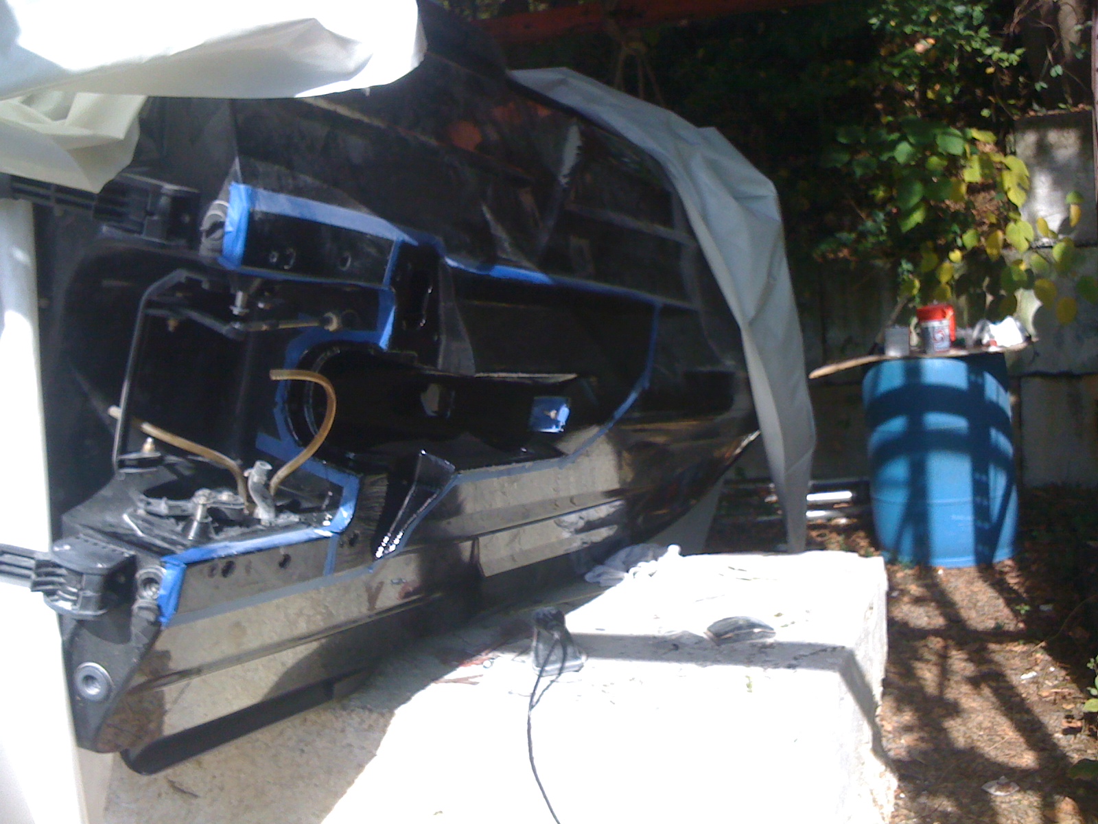

JeffJune 29, 2016 at 1:11 pm #39227This is a guy I used to learn how to do fiberglass repairs correctly. He has terrific videos and knows what he is doing. I re-did a 14K Jet Ski that had been ripped apart on the bottom by rocks using his videos. It included gel coat repairs and fiberglass cosmetic and structural repairs. He has a video even on how to match gel coat color. Take a look at all his videos. If nothing else it will allow you to ask the right questions to someone your considering repairing your boat. Hope it helps. 😀
https://www.youtube.com/user/boatworkstoday/videos
Joe
ps I will attach some pics of the damage and repair. The entire engine and jet drive had to be removed. The jet ski tunnel was even cracked. The ski has 215 horse power supercharged so repair had to be strong. I built up tunnel on both sides over 1/8 inch. I have never itched so bad in my life lol.
I got all my fiberglass resin, matting, gel coat, mekp etc from this seller on ebay. Their products are fresh not old that is very important when doing repairs.

June 29, 2016 at 4:10 pm #39236Some more pics
