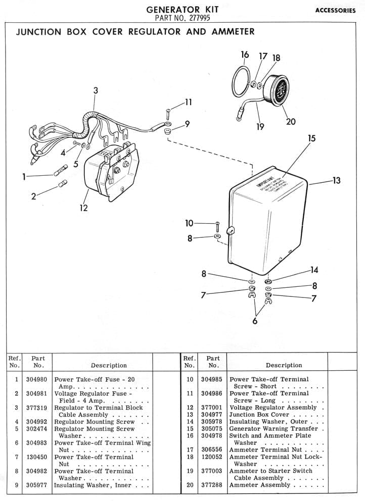

        Don’t pay the stupid price for the belt. Go to http://www.polybelt.com 255L037 black rubber, $5.09. Item # B255L037BNG
        Haven’t been there lately, I hope they are still in business
        Why the flywheel? is the drive pulley missing on yours?
        You know you also need a voltage regulator, right?

            Harley Davidson voltage regulator
            10 amp
            12 volt
            Part number 74510-64 or Delco 1119614

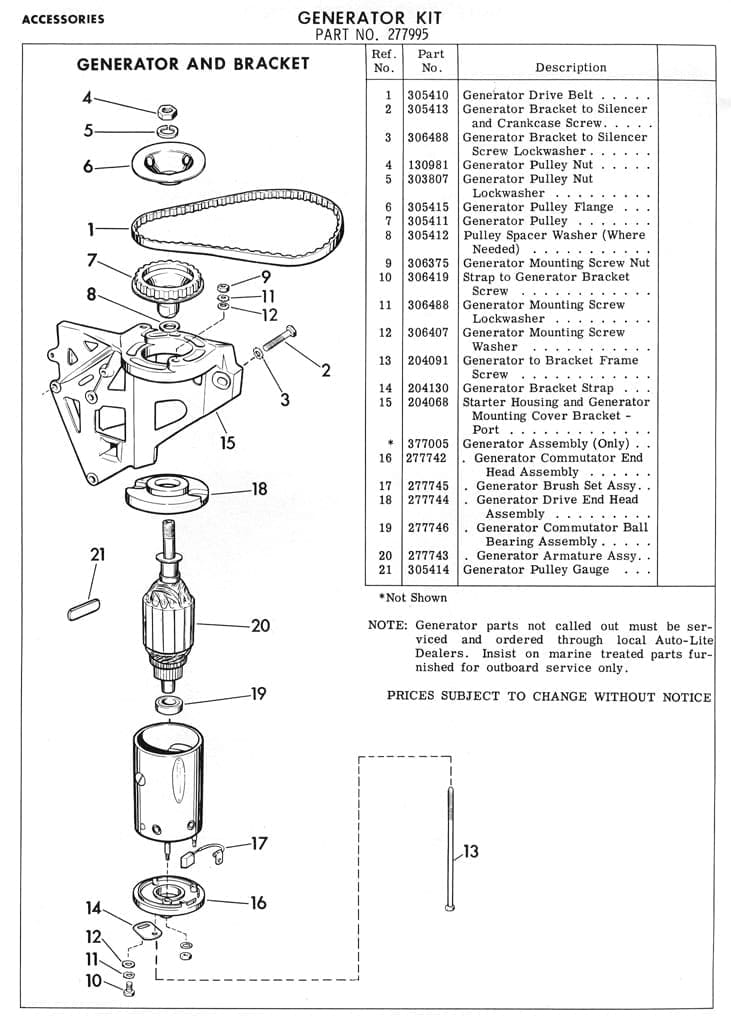

              I have a generator bracket from a 40HP Johnson. Part # is 305679. Not sure what the Gale # is. If you can use it I would make you a good deal.

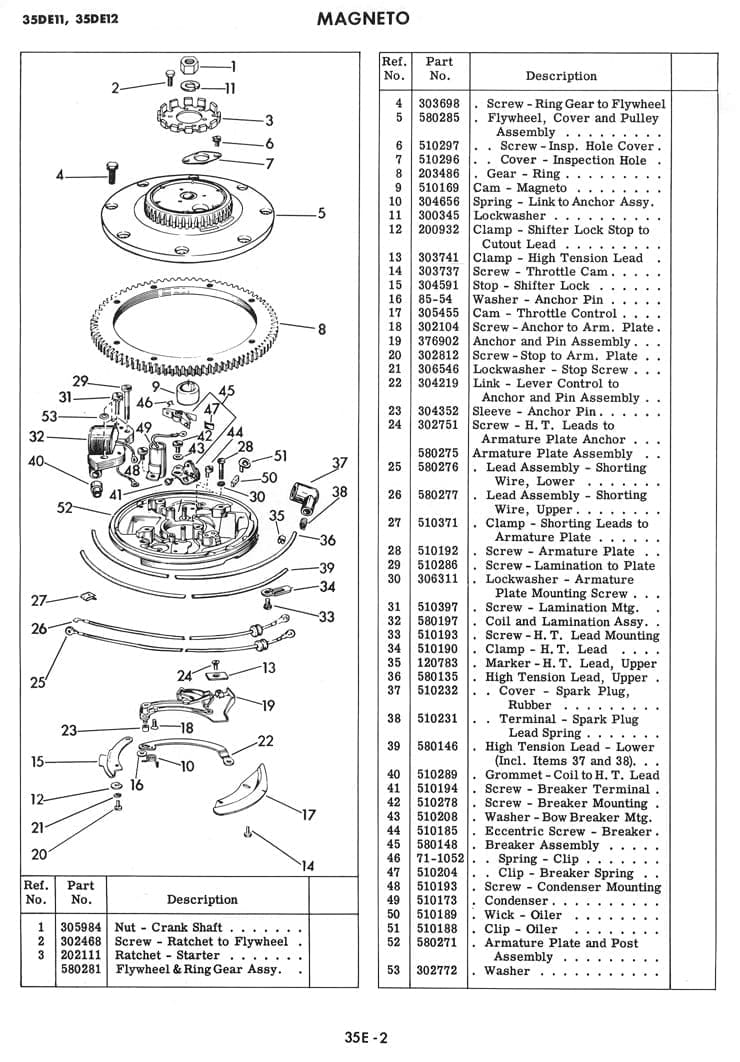

                I have never seen a 1959 Gale Bucannes 35HP with electric start, other than the Sovreign model. The regular Buccaneer 35 was only pull starts as far as i am aware, but could be worng. That is why there would be no cogs on the flywheel for the generator drive. Any flywheel from a 1961 or earlier 25,35,40 should work. I likely have one if you need it. The generator bracket would need to have provisions for the gale style hood mount to be attached. I would have to look at some part numbers o be sure what motors could provide the correct bracket.
                #186620
                  An Evinrude or Johnson 1957 35hp bracket will work, but what a waste of the rare special Johnson bracket. 1958 J/E Non-Super Sea Horse / Non-Lark will also work. 40hp brackets are different. Flywheels before 1957 won’t have the belt cog. And the ’57 cogs were famous for falling off. Pre-1957 motors were 6V (non-generator compatible).

                      1959 Gale generator parts
                      Generator-Kit-Generator-and-Bracket
                      Generator-Kit-Junction-box-Cover-Regulator-and-Ammeter

                        1959 Gale 35 flywheel
                        Pg-35E-2-Magneto
