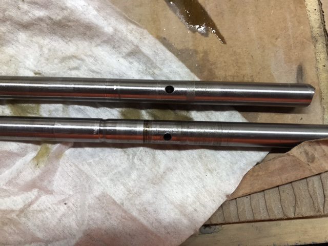

                  I think I have all the parts /seals to put the unit back on that I got from Dave .. I noticed a groove worn into the shaft .. will this be a problem ? Or ok to run it like this ?

                    #245433
                    fleetwin
                      Boy, that is quite the groove, doesn’t look usable to me…

                      Samuel Phelps
                        I guess I will have to try and find a replacement then .
