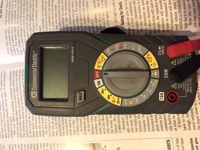

        Just read through the article in the outboarder.. I’m not sure if my digital meter measures capacitance or not . I don’t have one of the coil/condenser testers either ..
        I’ll post a picture of the meter that I have . Maybe you could tell me if it can measure capacitance . Sorry for my ignorance and thank you for your patience..

        Samuel Phelps
          This is what I have ..

            it won’t measure capacitance but remember meter testing is not as valueable as proper dynamic testing with voltages around 300 vdc to check if the inner foils are properly insulating the 2 foils
