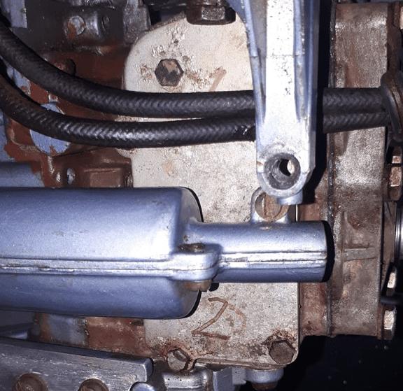

      Exhaust

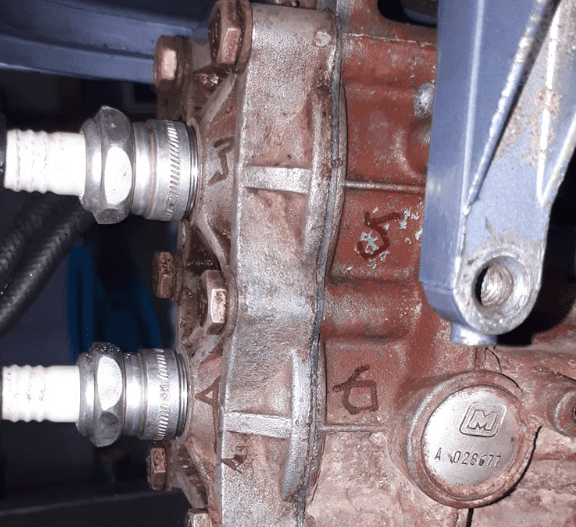

      plugs_side

        Here’s what I measured:
        1 and 2: 230 F (at one stage I was getting 300 F!)
        3 and 4: 170 F
        5 and 6: 170 F
        #196304
          I never had one of those thermometers, in fact they probably hadn’t even been invented yet when I was doing this for a living, So I can’t comment too much on your readings. But I will say that the only ones I find surprising are 5 & 6. On the other hand, you are running in a can at unknown speed and time and with air bubbles mixed with the water So I’m not too alarmed — yet. Service the pump and get it on a boat and see what happens. And try not to worry so much.

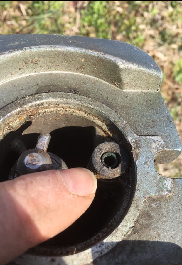

                I didn’t see this mentioned,but the folders have a rubber grommet in the folding joint.It seals the cooling water tubes.Those little folders are handy little motors for camping or as a backup.Did you get the case with yours?
