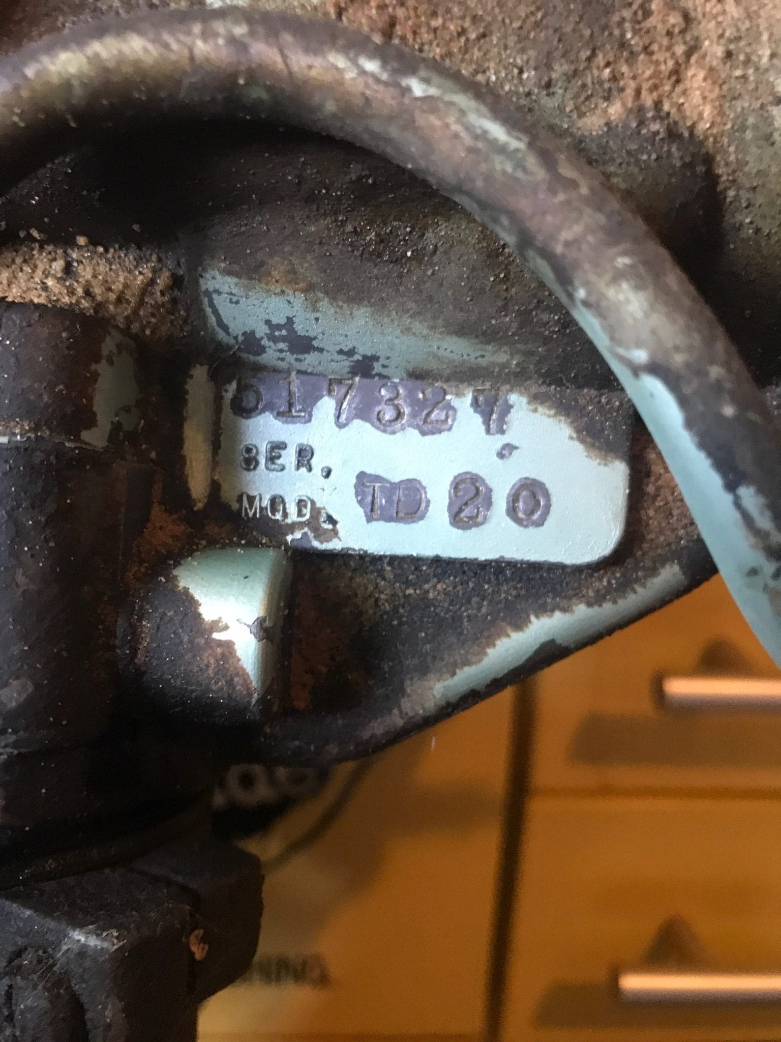

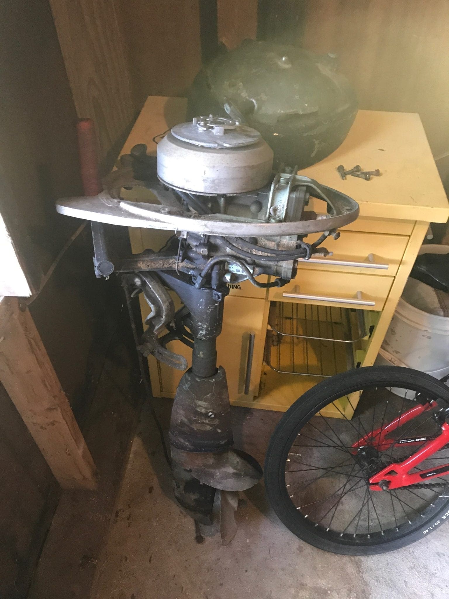

      Wondering if someone could help me identify exact year and some specific info on a old motor that belonged to my grandfather I know it’s a Johnson 5hp but only come up with a window for the year which is 1946-49
      MODEL IS TD 20 WITH SERIAL NO. 517327 (SEE PICTURES )
      anyone could help with specifics on it and any service info as I would like to get it cleaned up and possibly functional depending on extent of repair

      #177877
        Got any pictures? A serial number?
        1982 Evinrude 25hp
        #177878
        mrhtx
          Sorry totally forgot to add the info so it is a TD 20 with serial number 517327
          #177879
            That would be a 1946 model.
            1982 Evinrude 25hp
            #177883
            mrhtx
              Ty bob could you give me brief explanation on how it decoded

              LLOYD LAUTNER
                Those early TD’s usually still have good coils, but you will want to check them with an Ohm Meter. Should have about 3.5 Kila Ohms in the secondary winding. Compression will need to be 70-75 Psi for it to idle and run well. You will also need new Leather primer seals and instructions to install them. If so, send $10.00 cash and a self addressed stamped envelope to: Lloyd Lautner, 9289 North Long Lake Road, Traverse City Michigan 49685

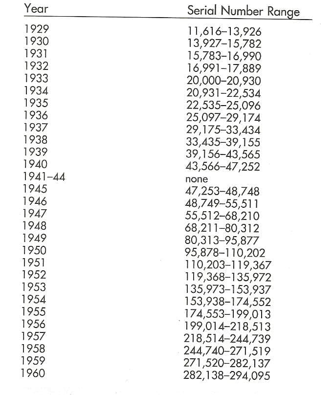

                  There is a serial number listing in The Old Outboard Handbook by Peter Hunn. A good book to have in this hobby.
                  1982 Evinrude 25hp
                  #177891
                    Here’s a list of serial numbers for US built Johnson motors
                    Johnson-Serial-Numbers-USA-001
                    and a list of Canadian built motors.
                    Canadian-Johnson-Seriall-Numbers-001
