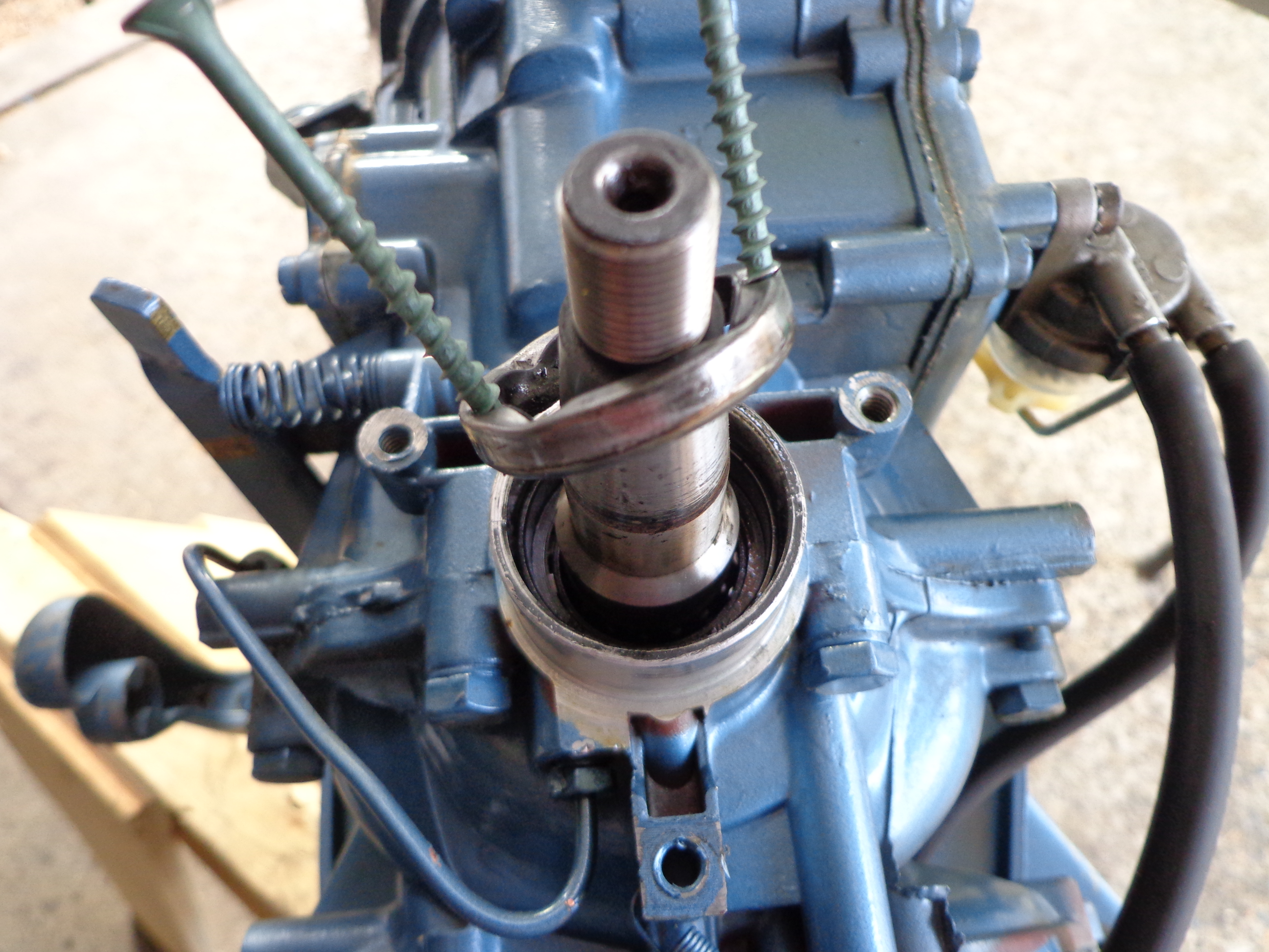

              #70340
                Some carefully placed drilled holes and screws can be used to coax it out if the special tool is unavailable.
