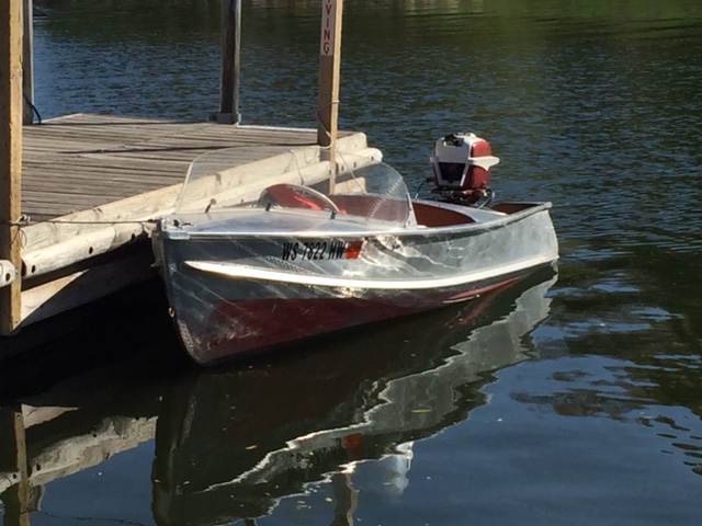

I took my 12 foot crestliner out on Tuesday (IN WISCONSIN!!) and achieved 21 mph. it’s a 2 cockpit runabout with an manual start 18 hp Johnson. just me in the boat (170 lbs) and my folding ducktwin back up motor. I was running a Michigan AJC 417 2 blade brass prop (what a beautiful prop: 9 1/4 x 12).

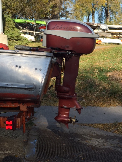

I believe anti-cavitation plate is a bit low. it’s 4-5 inches below the bottom of the boat. I’m planning to remake the transom this winter and raise it significantly. would addressing this issue gain me any speed?
should I have been able to go faster? I’d love to, but I believe my motor was running tip top. I feel like this is the perfect motor for this size of a boat. I have run others up to 30 hp and it can get a bit squirrely.
scott

classicomctools@gmail.comNovember 13, 2015 at 12:09 am #26991Well, raising the engine, and perhaps trimming it out a bit, should help take advantage of that nice prop. The 12" pitch prop might be a bit much for that engine though, kinda tough to judge without a tachometer.
PS- What a beautiful rig!November 13, 2015 at 12:16 am #26993Sitting up in the bow will definitely limit your speed due to wetted surface. Place your steering into the aft deck and you will make a very significant improvement.
My Model R with the 18 runs around 30-31 and my 15’6" fiberglass Gheenoe runs 27 with the same engine. Same prop you have.MODEL R (note steering position)

November 13, 2015 at 2:41 pm #27025I think Randy in Tampa has the same hull as you with a rear steering set up. Much better performance. He ran a PO on his last time. In my experience with three different engines on my Gheenoe (18hp, Speeditwin @22hp, and a PO) they all ran around 27mph with the same load.
I think Randy was running better than your speeds pretty easily so you have something to look forward to.
Fleetwin is correct on raising the engine but the biggest bang for the buck will come with moving the steering back and setting the trim to free up the hull.November 15, 2015 at 2:03 pm #27125quote fleetwin:Well, raising the engine, and perhaps trimming it out a bit, should help take advantage of that nice prop. The 12″ pitch prop might be a bit much for that engine though, kinda tough to judge without a tachometer.
PS- What a beautiful rig!hey fleetwin,
when you say trimming it out, are you referring to the position of the motor relative to the transom? based on the first pic I posted in the original thread, would I have to bring the bottom of the motor closer or further away from the transom?
thanks,
scottNovember 15, 2015 at 3:00 pm #27133Bringing the motor (exhaust housing/leg) further away from the transom is what I am saying when I say "trimming out". Try moving that trim rod/pin one notch out (farther away from transom) than it is now. Doing this will raise the bow of the boat out of the water with less friction.
Like Casey says, your helm set up may in fact be too far forward, making it near impossible to do this. You will know when you have trimmed out too far if the engine ventilates excessively, especially on acceleration, and if the boat porpoises (bow slaps up and down at high speeds) excessively.
Again, it would be nice to get an RPM reading at WOT now, to get a better idea if your engine is operating in its designed power band. Look at the transom ID plate, it should give the RPM range at WOT. An engine with a larger pitch prop, like yours, that is lugging, will not perform optimally. Let’s think of this in terms we are all familiar with. Let’s just say I am cruising along in my car at 35mph in fourth gear and suddenly have the need to pass another vehicle. What happens if I leave the gearbox in 4rth gear and stamp on the gas? Exactly, practically nothing. I would have to downshift to 3rd or 2nd gear in order to get the engine RPM up to where it can develop the power needed to effectively pass the other car. Think of propeller pitch as the various gears in your transmission. An over simplification, absolutely. Outboard motors do not have variable pitch propellers (like our auto transmissions). Furthermore, boats do not glide alone easily like autos, there is always a great deal of friction, consider what happens if your engine cuts out completely at WOT, people are tossed around in the boat and could be tossed into the water.November 16, 2015 at 10:45 am #27189My experience with 18s has been that those two-blade props only work well under the absolutely lightest and most drag-free, conditions. I’d put down money that says a standard 9 by 10 on your boat, without any modifications of transom or steering position, would give you a mile or two better. If you get lucky and can find a 9 by 11, by all means try that, too. At any rate, it would be worth a try, in my opinion, before you start having to deviate from stock design….I know everyone is right about the mods being a help; but my preference is to always favor originality. Your opinions may vary. 🙂
