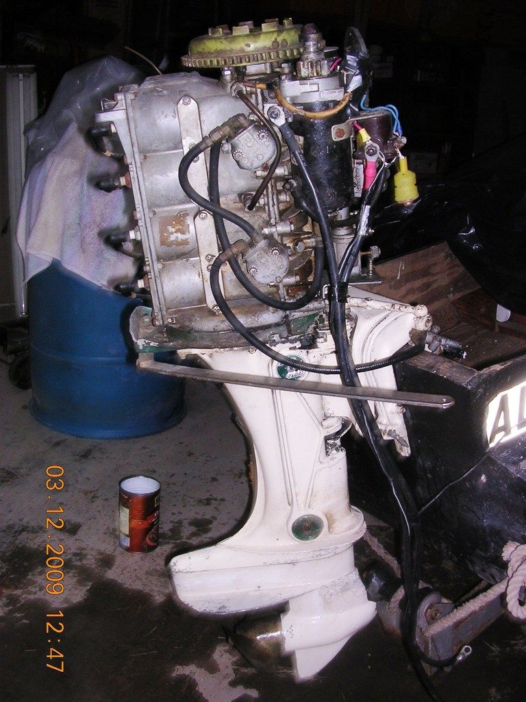

          Change flywheel, add alternator and $6 Radio Shack rectifier if you want to charge a battery, obtain and mount a starter and solenoid, cables to a battery, mount a starter button somewhere handy, and, subject to correction, I think that will do it and save your shoulder.
          Here’s a pic of a Mark 30 modified. Good luck. 😀 JW in Dixie
