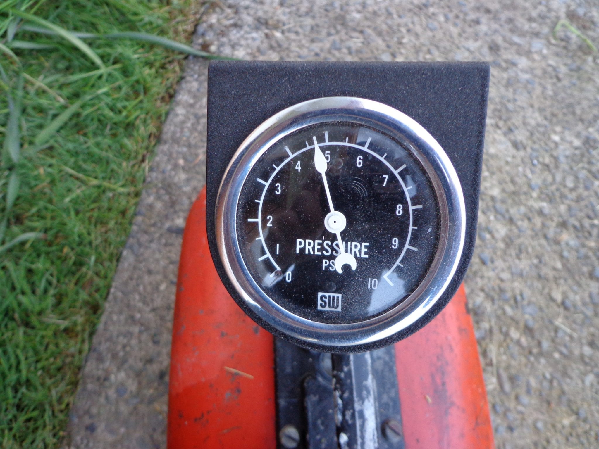

            A few years ago I tried several different motors to see what kind of pressure they developed in the tank and they varied slightly but around 4 PSI was the norm. I believe the pressure relief valve in the tank blows off around 11 – 13 PSI.
            DSC00589
            #216311
              What a cool tank pressure gauge! You patent it yet?
              Jeff, they can build up pressure from the sun here also. I’ve seen lots of relief valves fail to hold sufficient pressure, but never seen one fail to blow off excess pressure. Not that I’m aware of anyway. Boom ????? Good reason to junk rusted tanks.

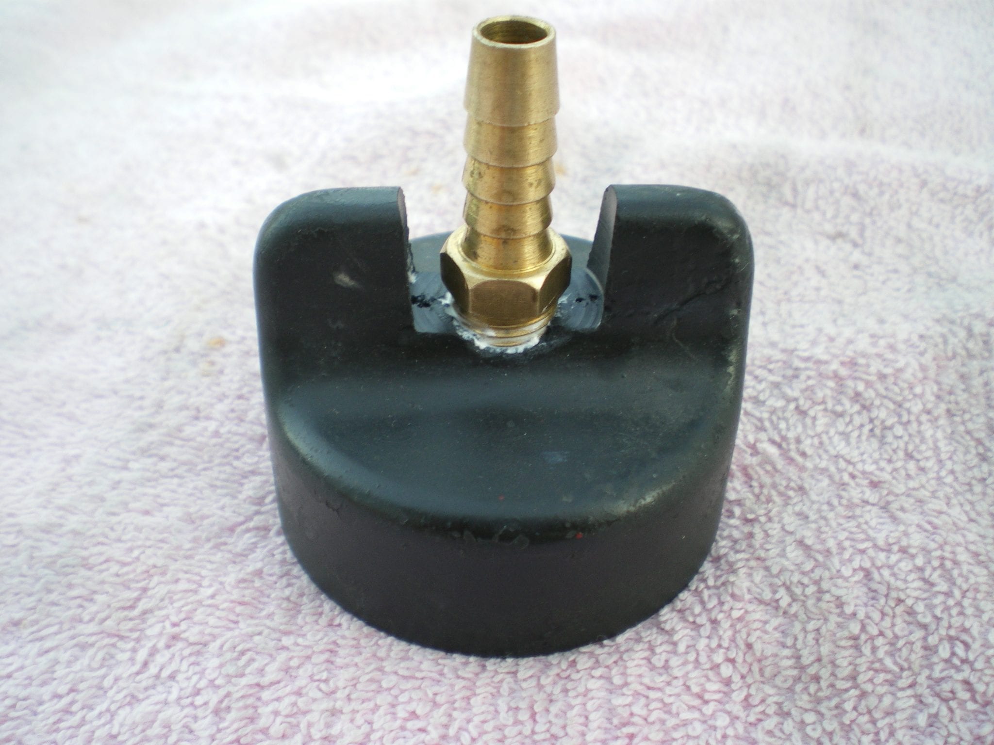

                    #216338
                      Frank says: What a cool tank pressure gauge! You patent it yet?
                      The 10 PSI gauge is an old school Stewart-Warner unit I found at a garage sale. It came in its original cardboard box and I believe it to be NOS. The gas cap was modified to accept a fitting and it also works great for draining the tank.
