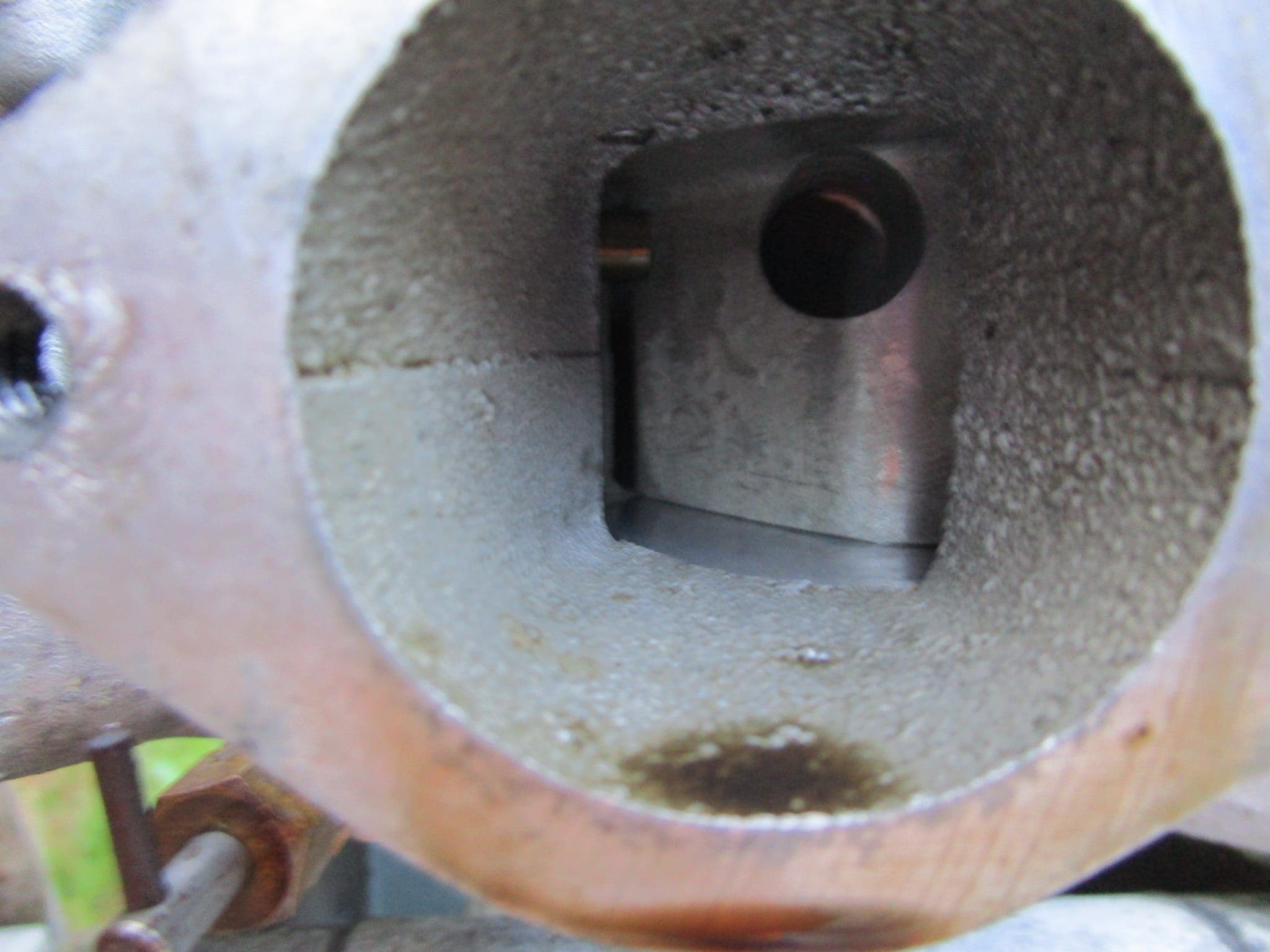

I hooked the tiller arm and there seems to be a bit of play in the cable . This pic shows the location of the butterfly valve when it’s at start position on the handle . About a 1/ 4’’. Open .Is this correct ? When on slow it will close off completely..

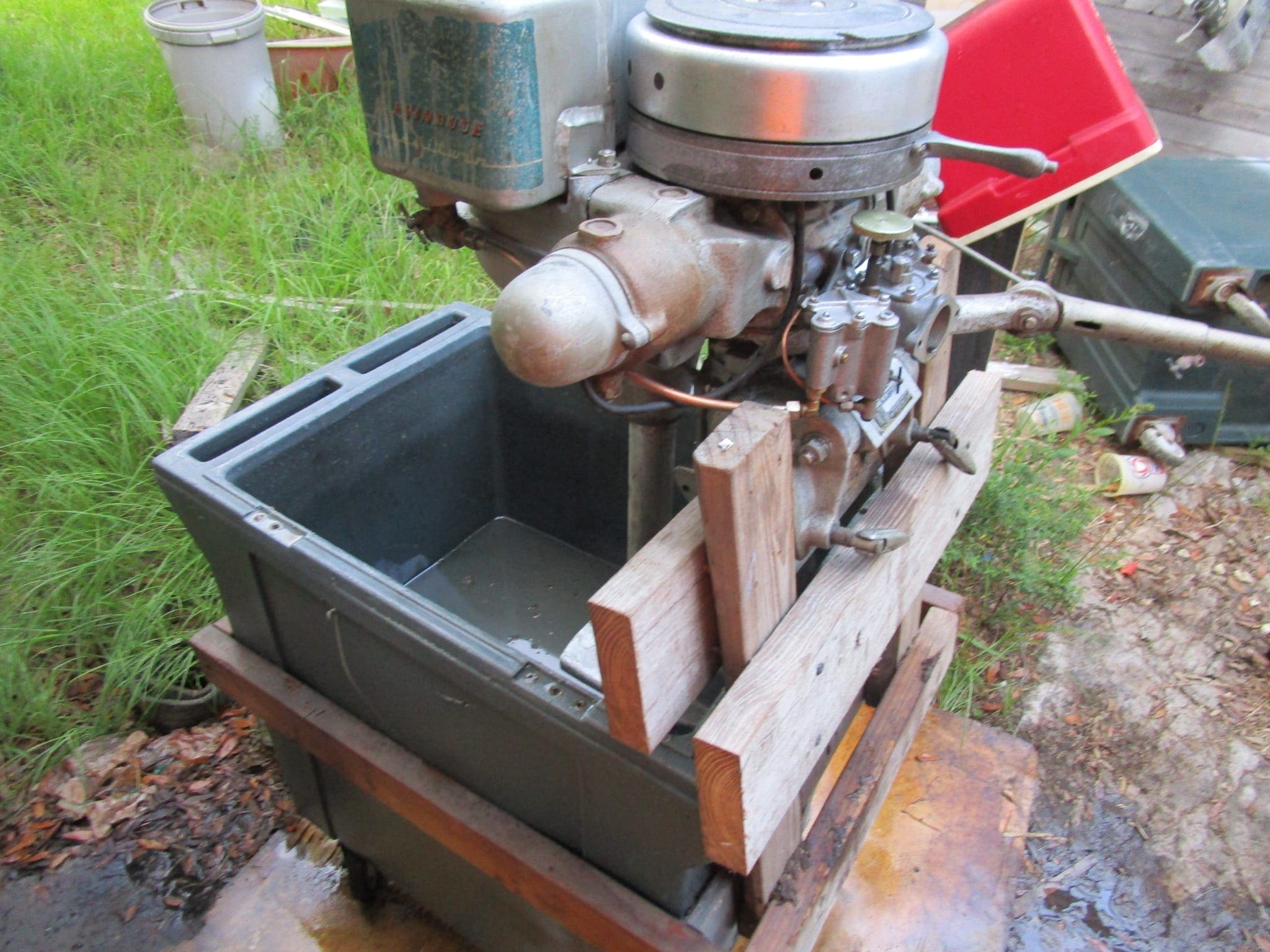

Thanks for any help guys ! Here is my tank set up ….June 26, 2019 at 7:25 pm #178017Ok let’s see if this works ..

Looks like you’re off to a good start. Put her on a boat and hang on!

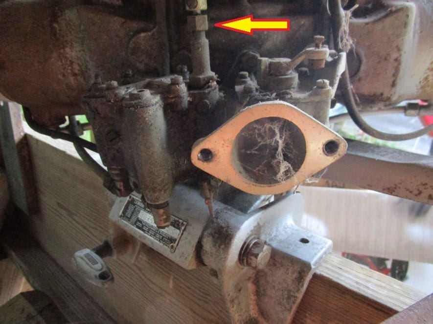

I was going to take the muffler unit off and was wondering if it’s possible to take the muffler off without dropping the lower unit . It has the big tube attaching from one to the other .
I would rather not take the foot apart if possible .July 22, 2019 at 11:15 pm #179356What luck!! I have one of these motors trying to get running also!! Mine is a 22.5hp and it was run about 45 years ago. The motor turns over easy but there is no spark. Does the condenser go bad?
