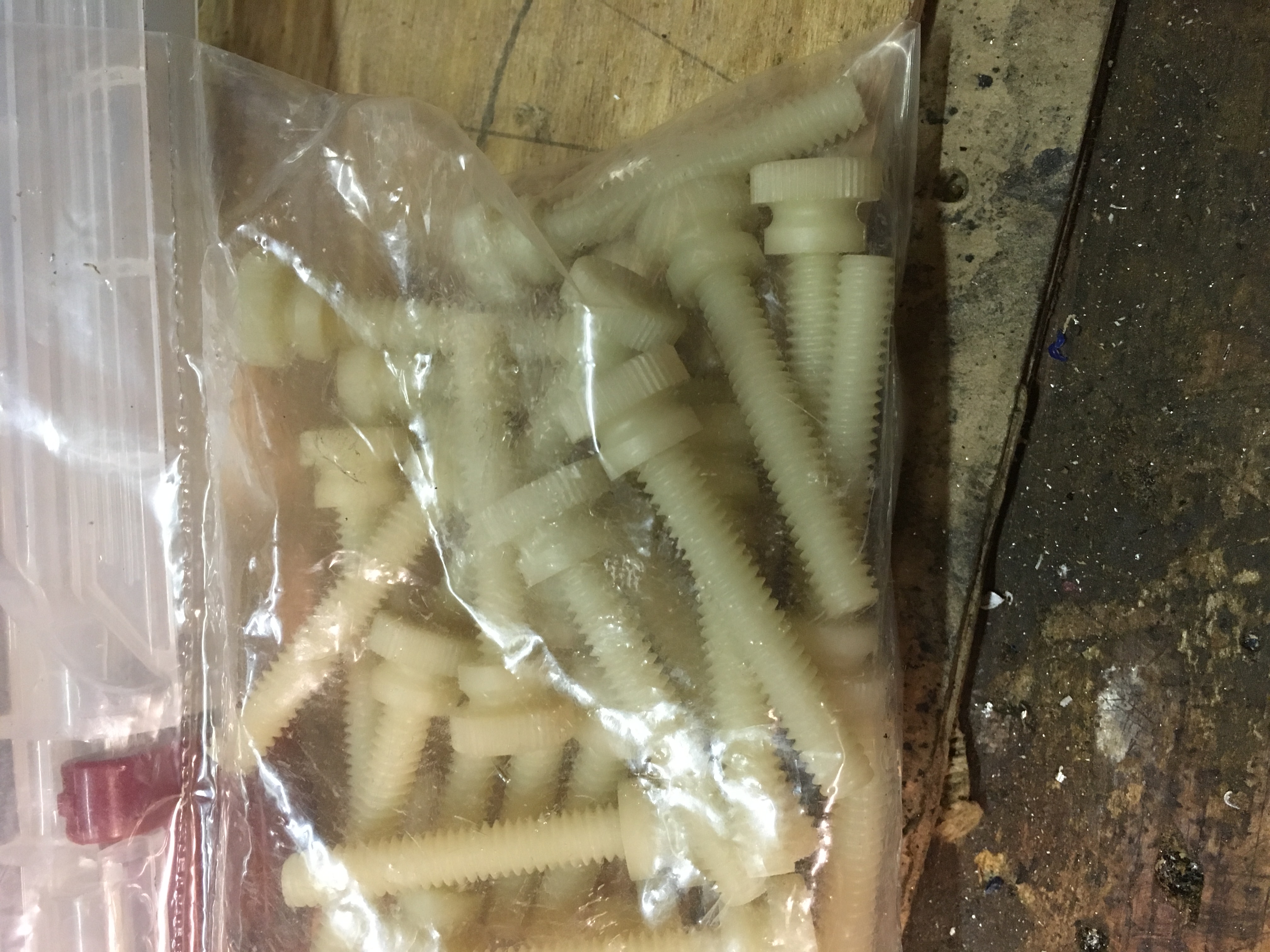

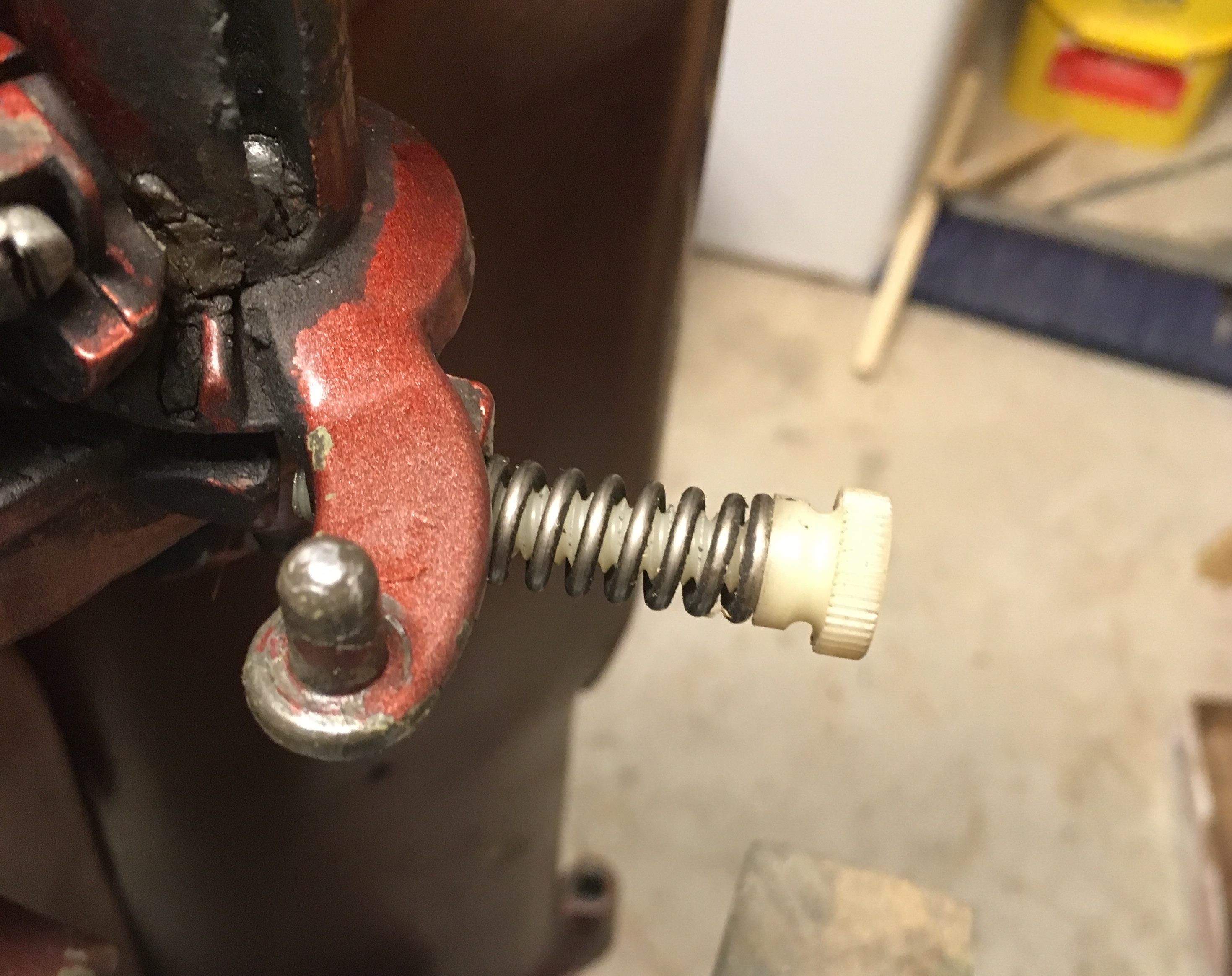

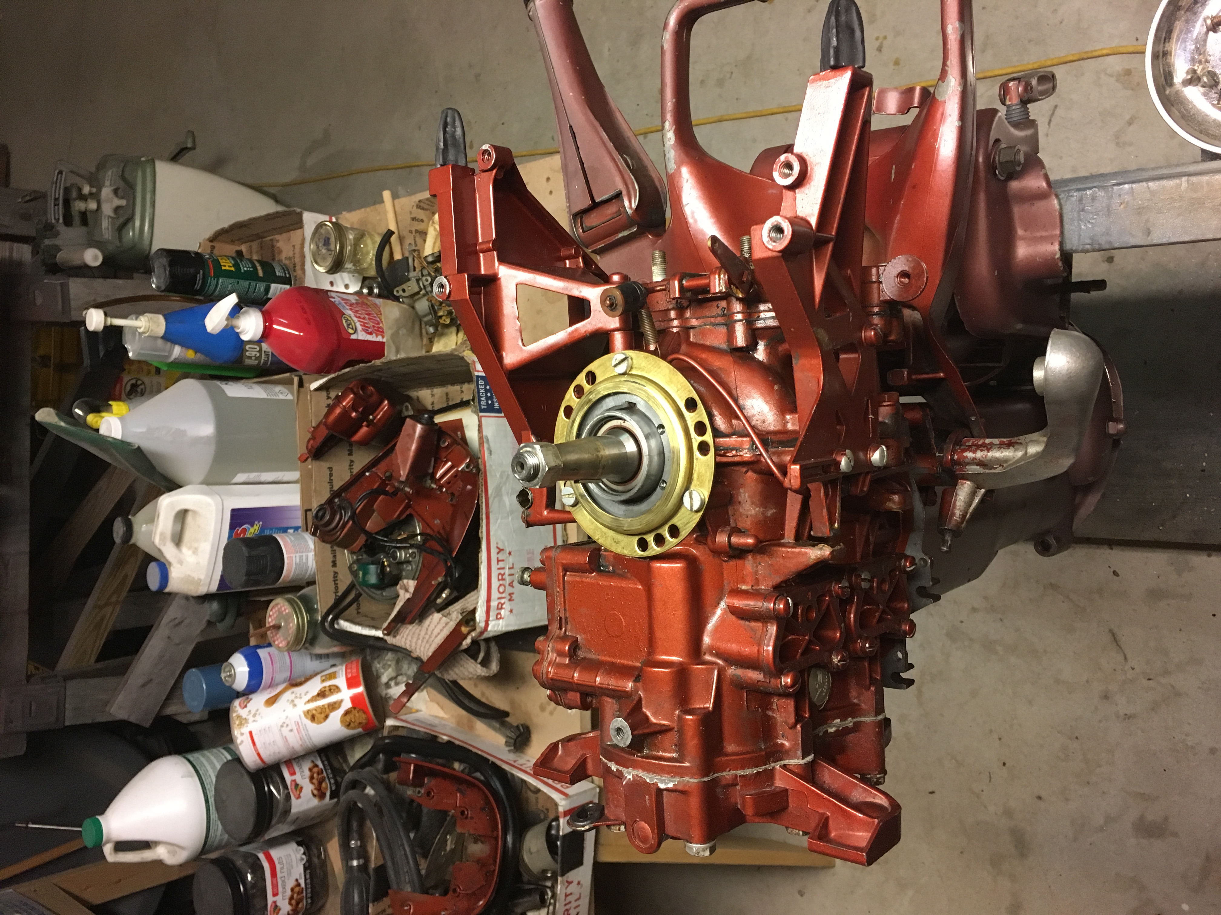

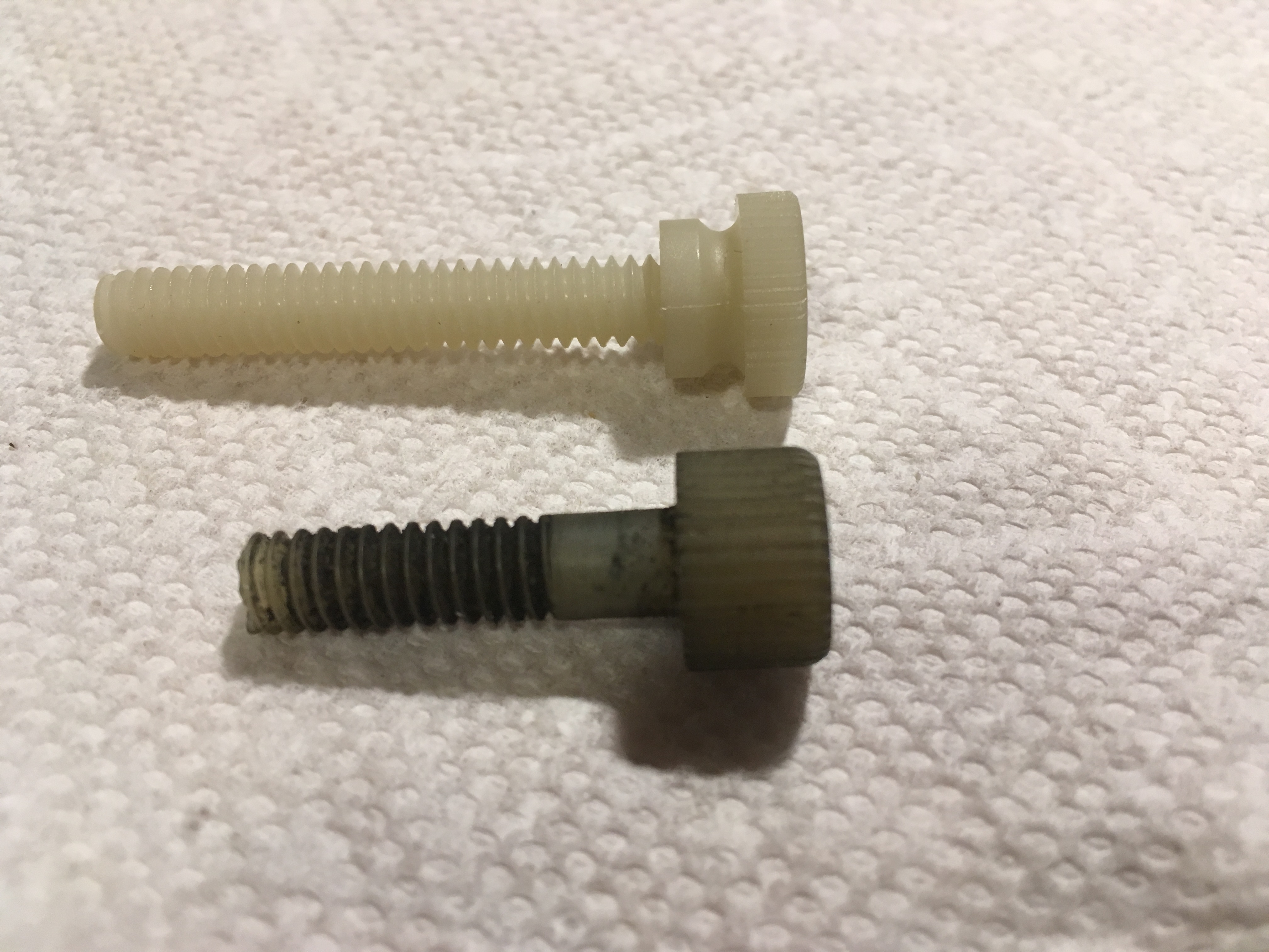

      I recently started work on a FD-12 I picked up. I changed the upper crank seal and put a new quad ring in the lower seal. I broke the idle screw and I will NOT pay the price for a new one.
      I had an order ready for McMaster Carr and look what I found. Now I have a lifetime supply of quad rings and idle stop screws.
      I will bring some to Bud’s on Saturday if anyone needs one.

            1957evinrude
              Looks almost original . What is the part number??
              #72069
                OEM ones have a metal core, so that WHEN you put the engine down on its side and attempt to break it, it just bends over. It IS a special item. Whether it’s worth forty-five bucks or not is open to debate, for sure. I always use stainless screws for that; but I know that I run the risk of breaking the aluminum gear instead, if I mis-handle the motor.

                    Darrell,
                    McMaster # is 90462A680. Glass filled nylon in pack of 25.

                    david-bartlett
                      quote Dave Bernard:
                      I have used a SS bolt also. wont break.
                      Right, but the casting might. I’d rather replace the plastic one again.
