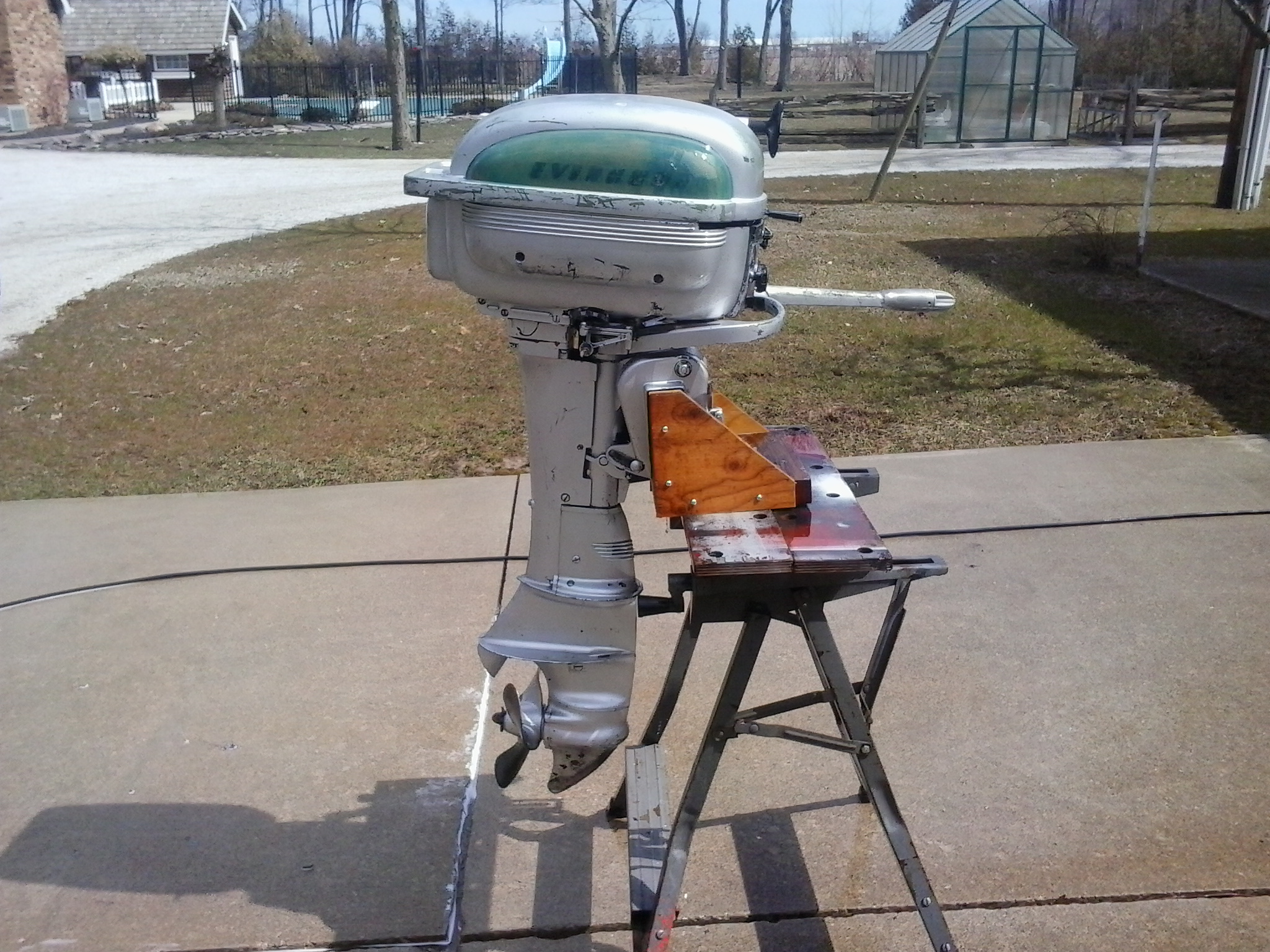

      Just picked up a 1950 Evinrude Fastwin 14hp I think
      There is no ID tag on it anywhere
      Cleaned it up yesterday and plan on a full restoration
      Just wondering if anyone might have some information on this motor
      Plan on putting it on the 1950 Peterborough Aquaflyer that I have been restoring in my spare time for the past 3 years
      Thanx
      #73728
        Cylinder block, pistons & rings interchangeable with the 1949 12 horse Elto. I seem to have lost some of the pages of the parts book . . . 🙁
        #73729
          P.S. That is a model 4438 Fastwin – I had trouble with the rubber motor mounts twisting out of place and put a very short sheet metal screw in each to help hold them in place. It uses a Tiltson MD carburetor. The low speed adjustment adjusts the air. The idle tube supplies a set amount of fuel. It is also easy to clog up with stale oil. The gearcase was also used on the ’49 and ’50 QD Johnson. . . 😎

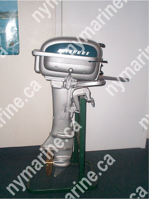

                #73908
                grunt

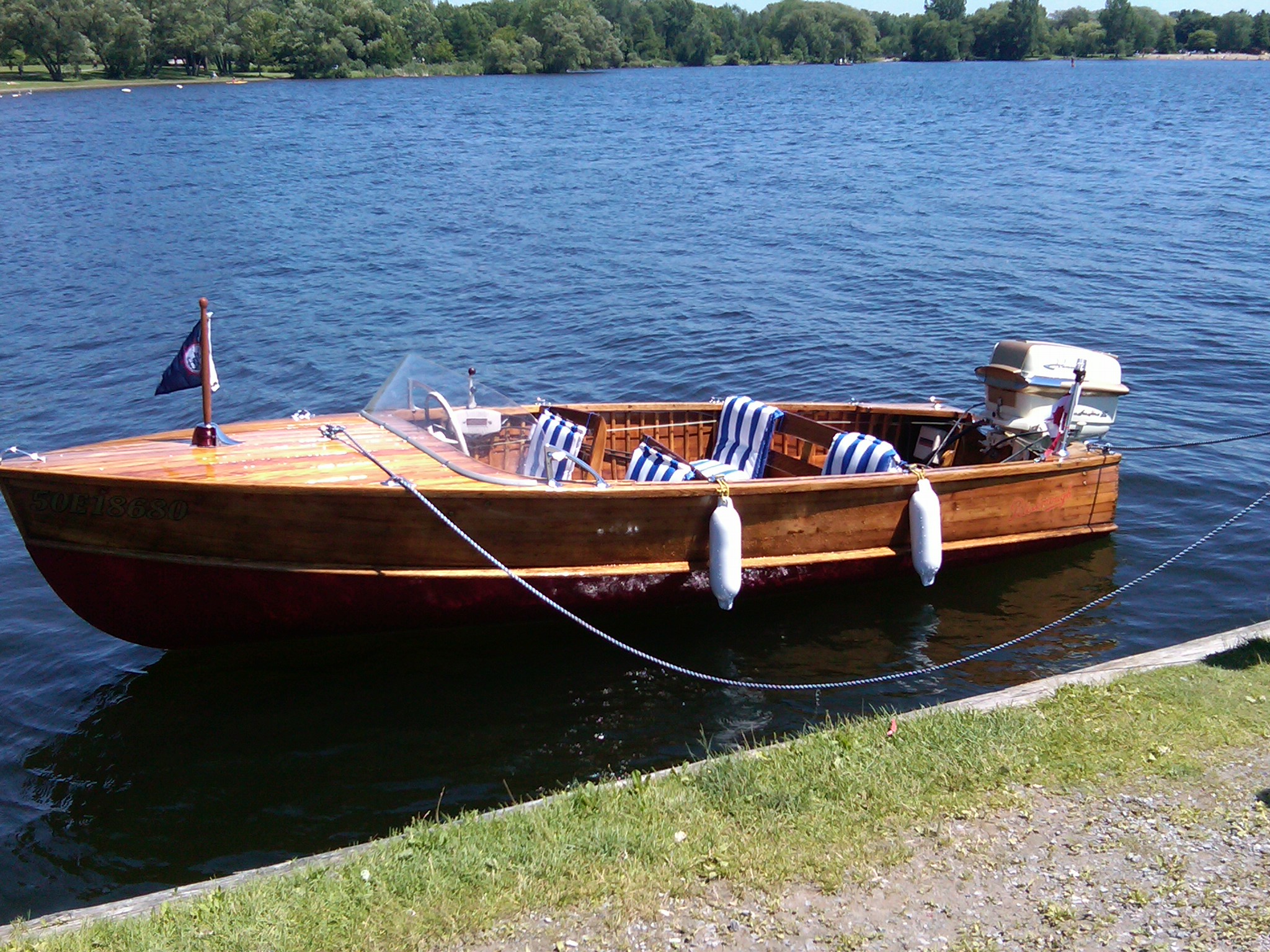

                  I have been doing some more reading and the 1950 Evinrude model 4438 is 14hp
                  Should look like the picture attached when it is finished
                  Hopefully it will get the boat up on plane…no trim tabs on the Woodie
                  #73910
                  chris-p
                    I have had a couple Aquaflyers. I ran 35hp motors on them. I personally don’t feel like you will be happy with the performance with the Fastwin on it sorry.
                    #73931
                    squierka39
                      That’s the same motor I learned to boat on, mine was on a 1930 Thompson 16’. Performance was fine for a big boat and small motor. We had a speedo on it and I seem to remember 15 mph, maybe 18 tops. My boat can be seen in the pictures page here.
