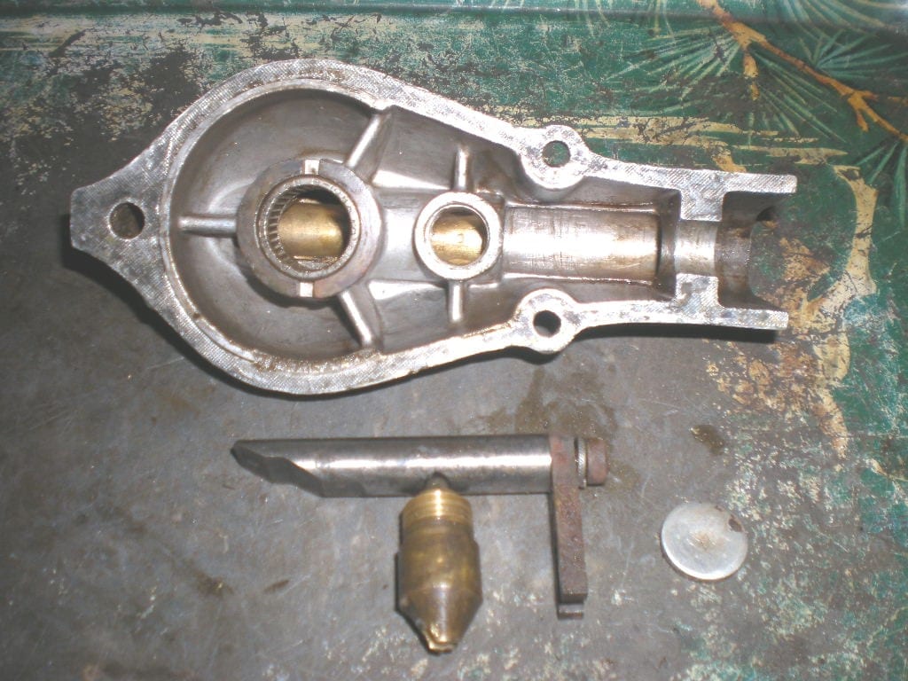

        Not sure if they’re the same as the Firestone’s of that era, but this 5 hp Firestone
        had an “unusual” wedge to operate reverse……
        DSCN4905

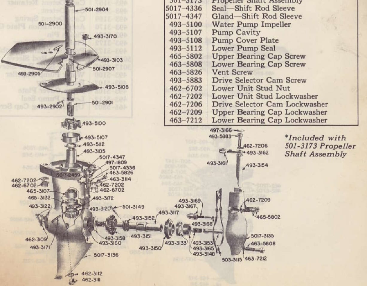

          Is this like yours?
          Scott-501-LU
