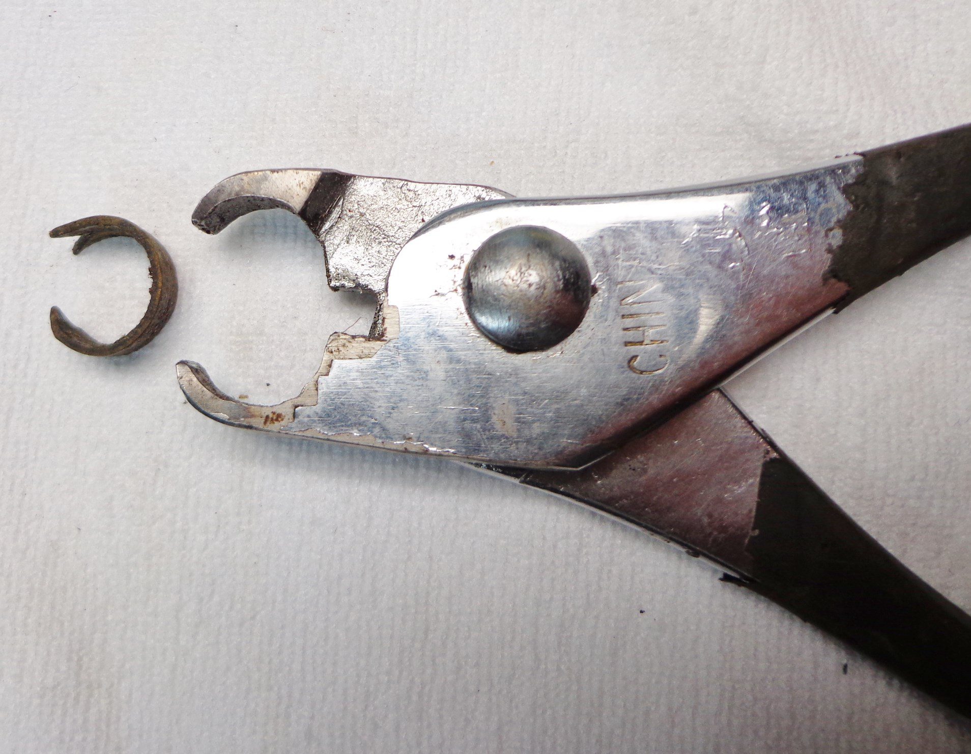

              #256012
              Steve D
                Crosbyman said “saw a modified pair of pliers one time the jaw tips were rounded to match the clamp diameter”
                Maybe it was this picture crosbyman. Pretty sure this was Mumbles solution using old, cheap, expendable pliers.
                pliers-adapted-for-crimping-dual-hose-tank-fittings
                #256016
                Pondrocket
                Keymaster
                  or like this…
                  Travis
                  #256018
                    yes those are the one… 🙂 I tried to make a pair way back but….I do not have  mumbles  shop tools..or patience ….
                    I converted  all my oldies to pump but keeping this one  original….   no need to recrimp the hoses except  for the side connector’s  new  hoses  to  the carb and air nipple
                    it is all  refurbished  (ignition carb impeller etc…)
                    • This reply was modified 4 years, 8 months ago by JACQUES.
