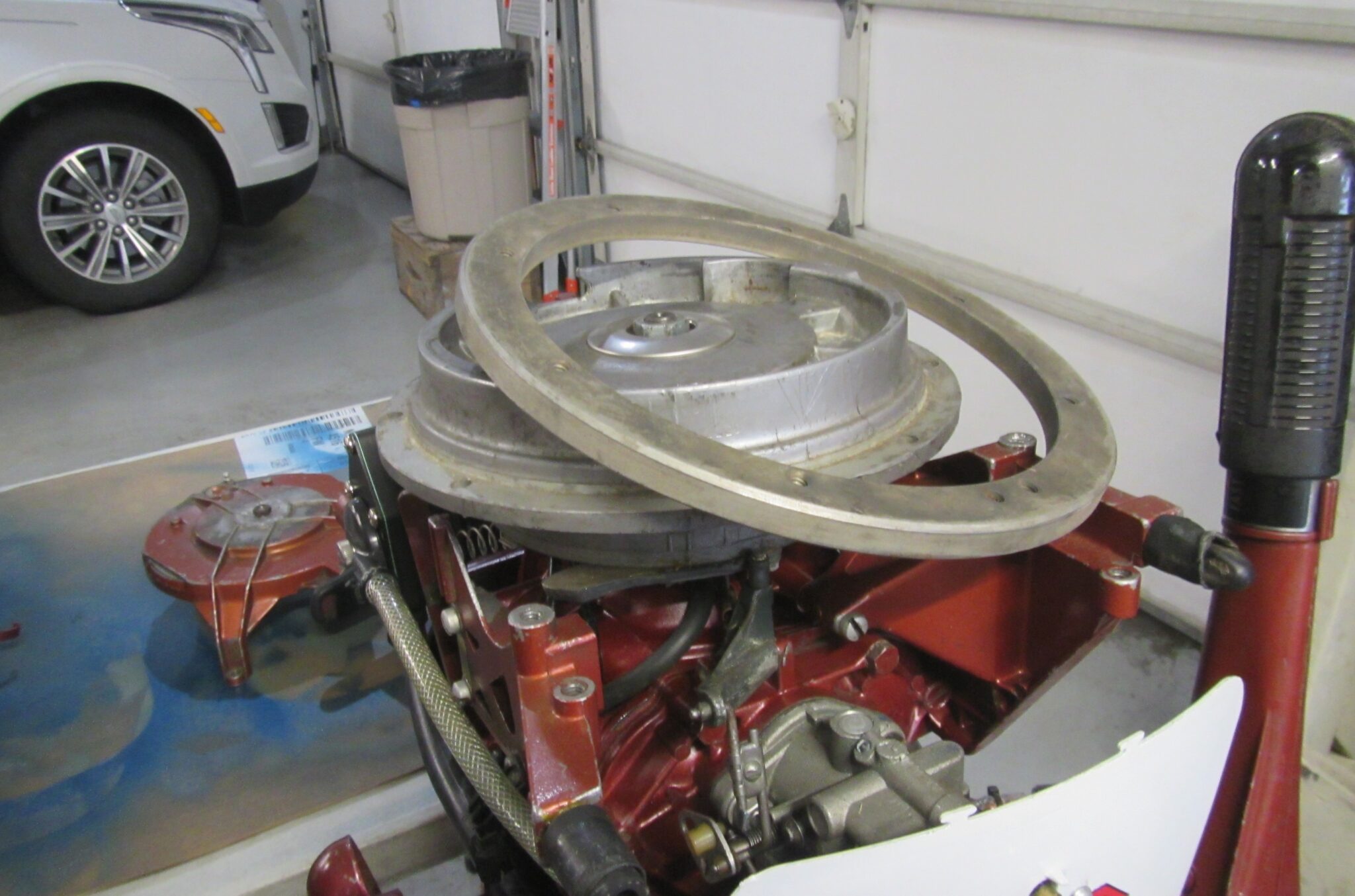

It may give you better low speed idle to have the ring on,
other than that, I don’t know!Prepare to be boarded!
January 8, 2023 at 10:26 am #270865Back in my hotrodding vw motor days we would shave a couple lbs off the flywheel to bring the revs up quicker. But that was a four stroke motor. Why do you not want it on there?
January 8, 2023 at 10:31 am #270866Have you ever seen the results of an exploding flywheel? I have. You don’t want to .experience that.
I figure that steel ring helps to reinforce the flywheel as well as provide a good idle.
January 8, 2023 at 11:14 am #270868Yikes Frank. I guess you don’t have a video; eh? What engine was it where the flywheel exploded?
January 8, 2023 at 12:43 pm #270887When I was a kid, I took one off my 18, to try to go faster. If it made a difference in top end, I couldn’t tell; but it sure did idle a lot worse. God sometimes protects the ignorant. It was only when I “grew up,” that it dawned on me that it probably held the flywheel together, and I had been extremely lucky.
January 8, 2023 at 12:58 pm #270891don’t redesign what works…..somebody (RIP) figured all this out a long time ago for us young fellows . !!
January 8, 2023 at 1:03 pm #270892It’s an inertia ring, meant to smooth out the power pulses.
Best to leave it on or the motor might try to pull your arm out of its socket when roping it over or it might try running backwards at idle.
January 8, 2023 at 2:26 pm #270903With my background in industrial manufacturing, I approach a question like this from a corporate “Bean Counter” perspective. That ring cost quite a bit of money to manufacture and install…. trust me, the “bean counters” would have badgered the engineers to leave if off if it was not necessary. In this case looks like logic and the engineers prevailed.
Any time you encounter what appears to be an extraneous part, apply the bean counter test.
Joe B
January 8, 2023 at 5:04 pm #270921Yikes Frank. I guess you don’t have a video; eh? What engine was it where the flywheel exploded?
I didn’t see the actual accident, just the guy when he dropped by for a visit a number of weeks afterwards. It was a cast iron flywheel on an industrial engine, (a Wisconsin, I think), mounted in a midget race car. The thing blew up in his face and punched a few holes in his head. He survived but was never the same after that.
