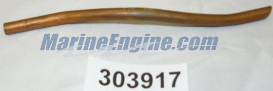

        piddler
          FD-11-Water-Tube-0303917
          This is the part. Looks like mine just not sure how long it is. Also Mine may pull out. Still working prior to digging in

              Welcome pippler! The pickle cut end goes down. The squared end goes up and it should stay there when assembling. A little sealer on the top end will help it stay there. A little grease on the pointed end will help also. If you have a spare 3 or 4 inch 3/8 coarse tread bolt that you can cut the head off with a hacksaw. You can put it in the big bolt hole in the lower unit (gear case). Use the bolt as a guide pin when trying to slide the cases back together. It is hard to see for alignment but once you understand how it goes together it will be a piece of cake!

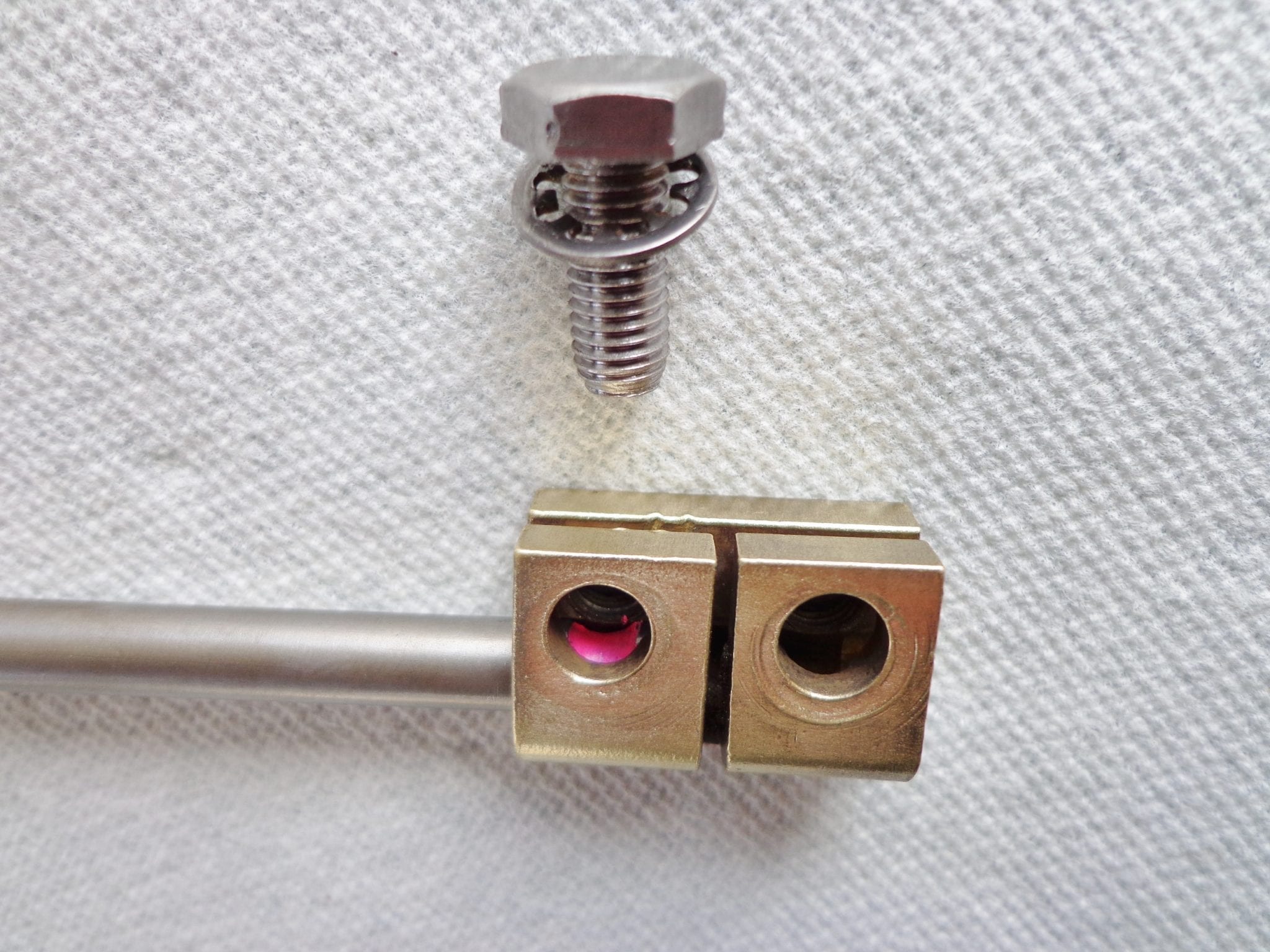

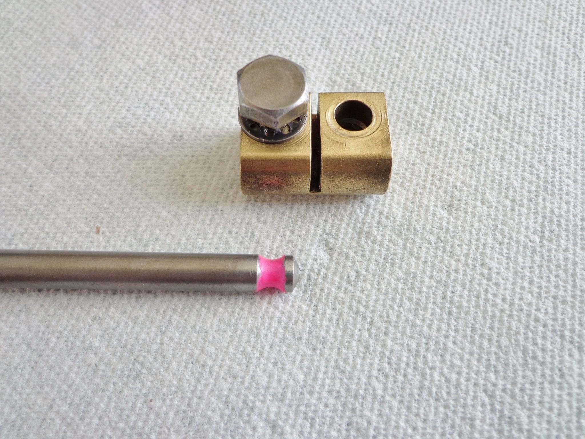

                When reassembling these units, the driveshaft splines, shift linkage, and water tube all have to line up together. Lightly greasing the water tube and its rubber grommet in the pump and the splines and marking the shift rod for its correct position will help to make the job easier. If the copper tube is loose, it may need turning to help line it up. Sometimes I hold a small flashlight in my mouth while doing this and align the tube by hooking on to it with a piece of wire. It can be done.

                    OK, I just looked at your pictures again….The top picture is from marineengine.com, the bottom picture (with the ruler) is actually your water tube….Do I have it right?
                    If so, it doesn’t really look bent, but who knows. I don’t have a water tube handy, but will look and measure it if I find one. For now, please be sure you understand what LG said about the water tube orientation…The square cut fits up inside the exhaust housing grommet. The angular cut end fits down into the water pump grommet. The angular cut makes it a little easier to align the water tube with the impeller housing grommet.
                    At this point I would reinstall the water tube into the exhaust housing, then I would install the aluminum impeller housing/grommet assembly up into the exhaust housing until it engages with the copper water tube sufficiently. If the bottom of the aluminum impeller housing is roughly even with the bottom of the gearcase, then it is safe to assume you have the correct water tube and it isn’t bent/distorted excessively. There is a fit issue if the bottom of the impeller housing is up inside the exhaust housing when engaged sufficiently with the tube….
