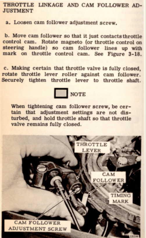

                you should see how long it took for me to figure out the carb cam on a 9.5hp ….till a member sent me this .. one more reason to join aomci 🙂
                9.5-cam-adjustments
