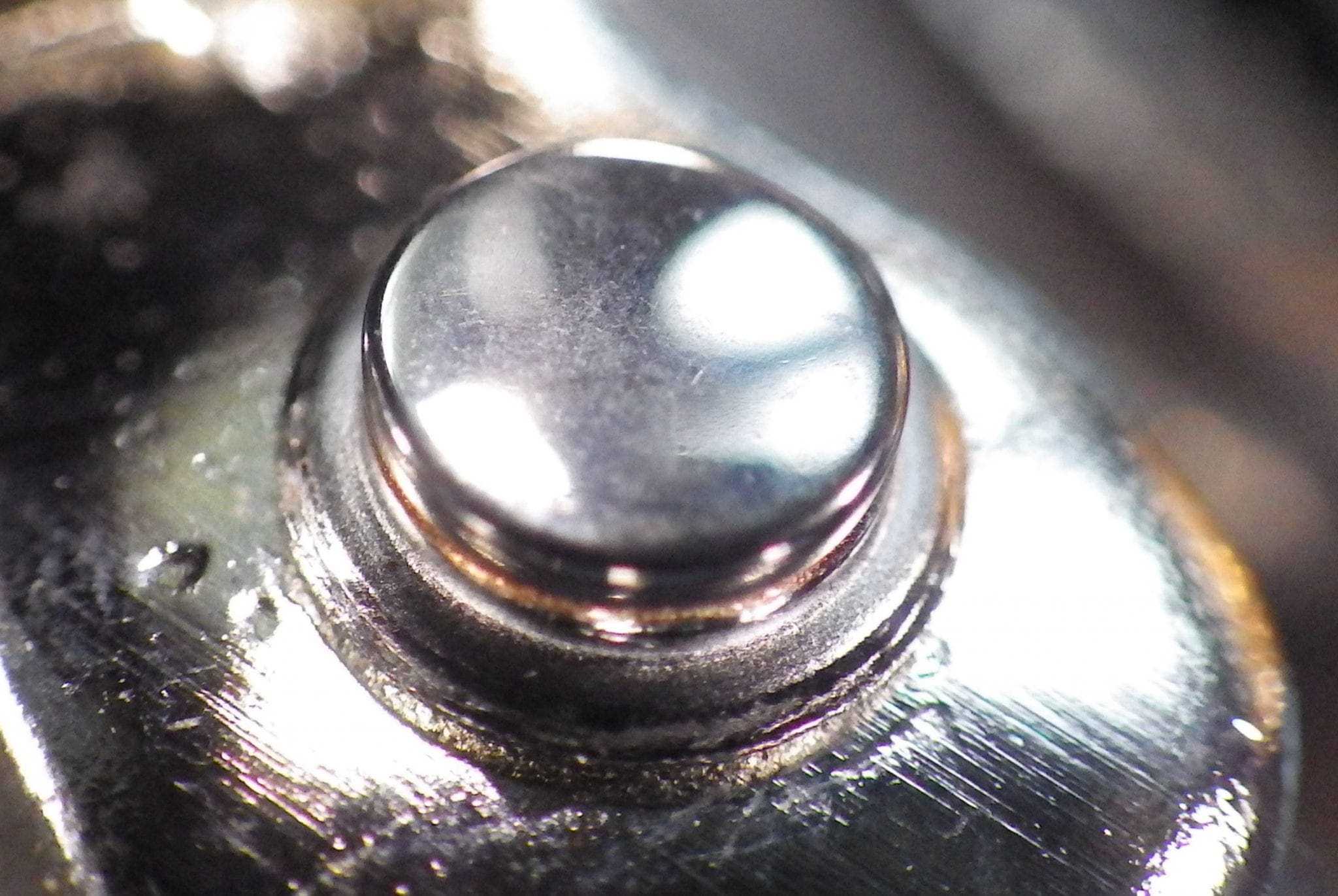

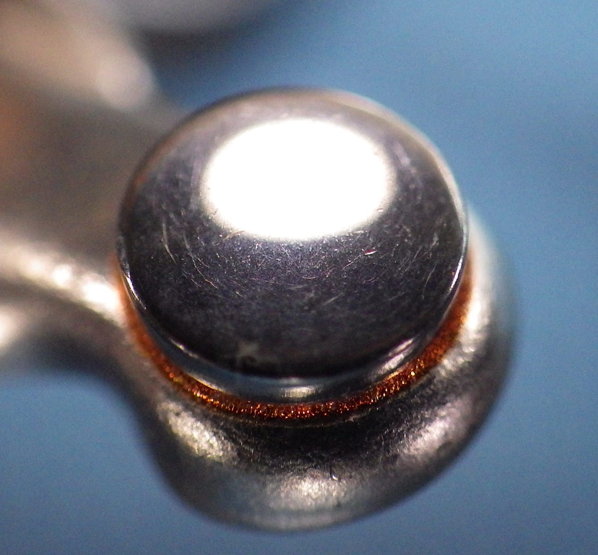

                    Emery will leave a rough surface on the points. They should probably be removed and polished with progressively finer grits of wet n dry paper or replaced. 1000 or 1500 grit will leave a nice shiny surface on them and a wash in lacquer thinner or something similar will remove any oil film left behind. They have to be clean to work properly.
