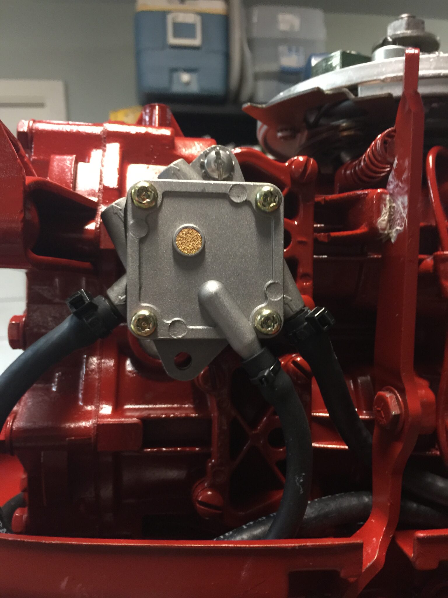

I did try opening the carb needle a little more but it didn’t seem to make much difference. After the carb overhaul and prior to installation, I did test the carb for float/needle seating upside down and rightside up – needle was seating correctly. I did the air pulse nipple mod to get my air source for the pump, which I’ve done on several motors with no problem. The fuel pump is for a Kohler or B&S engine lawn tractor with advertised flow rate of 4 liters/hr. but for the price I suspect it’s a Chinese made product. Thought I might swap it out to a Mikuni pump. I’ll try to include a picture of the pump but don’t know if will load.

I plugged off one side of the intake behind the reed plate and ran an air pulse line from the manifold to the pump. Main incoming fuel feed to fuel filter inlet, fuel filter outlet to pump inlet, pump outlet to carburetor. During the last run when it started to die out, I did squeeze the tank primer bulb and it got to running again, so I’m pretty sure the Chinese made pump is NFG (it’s a Mikuni look-alike knock-off product). By the time I quit fooling with it, I was getting low on fuel in the tank, so I plan on getting some fresh gas tomorrow and I’ll check the fuel pump output.

"Every time you remove a broken or seized bolt an angel gets his wings."March 12, 2023 at 8:31 pm #273778I had exchanges some time ago about these pumps with the gold mesh similar to your B&S pumps. AlthoughI had no problems it seems these gold mesh pumps are more for 4 stroke engines more than 2 strokes…..
the pulse line should normally push air but could in theory push oily vapours enough to degrade the pulse pressure to the pump .
try another pump style (square mikuni) maybe just for the fun of it or….drill and tap a side cover to mount a nipple to pulse the pump and… plug off the pulse nipple behind the carb
