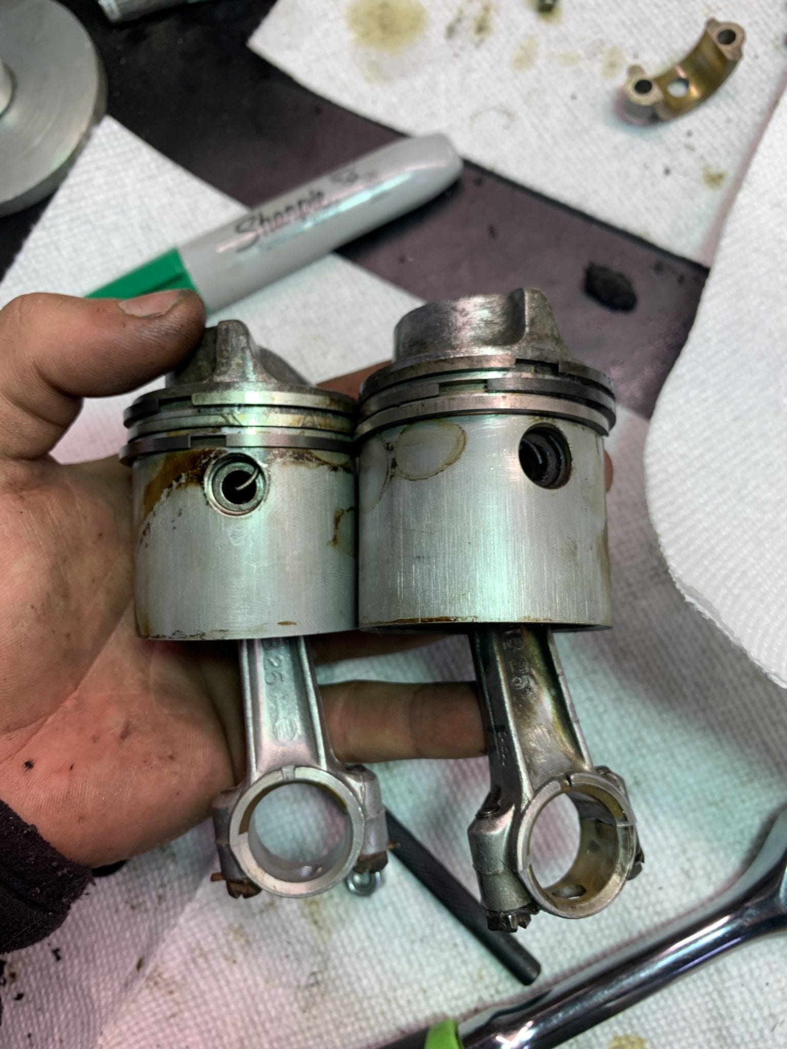

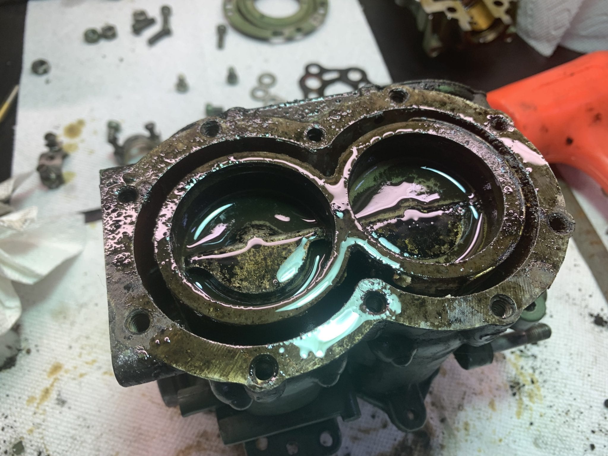

              Compression is 68 on bottom 60 on top. When I had this motor apart to un-stick it I freed the rings and replaced the ones that broke
