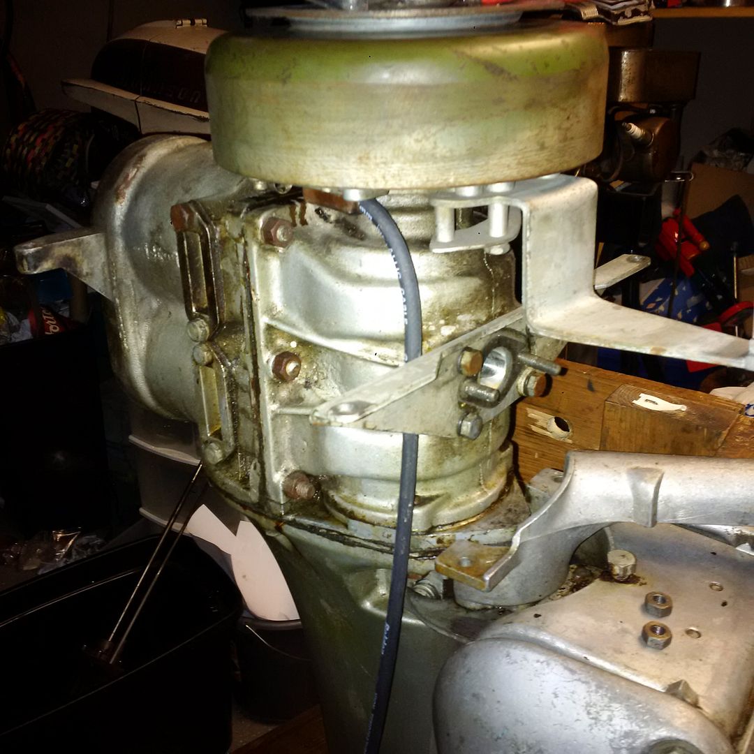

Here are pics of the carb, and some leftover items I need to remember how to assemble 🙂
Story is, a fellow brought it to me a couple years ago to mechanically restore for him. He had brought me many motors in the past. Well, I haven’t heard from him in about 2 years now. Also have one of his 60s 33hp OMCS I finished at the same time. I normally did all OMCS for him, this is my first Merc full mechanicals job, told him I would practise on him.
Figured I should finish this in case he ever comes back. Don’t want him to come back after 2 years and Im still not done.
October 4, 2015 at 7:39 pm #25124October 4, 2015 at 11:28 pm #25131I see a Bendix magneto, Many like the Phelon better but I too have a few Bendix’s mags. Just pay attention to detail & everything should work well. While installing the flywheel be sure to have the points sets open much so the rubbing block on the points don’t get damaged. Nice motor but runs better with the KF7 model 29 carb. The AJ 19 had issues I hear. Look in the manual they are almost the same except jet sizes. Good luck!
October 4, 2015 at 11:54 pm #25134the coil wires should come out towards the rear.
