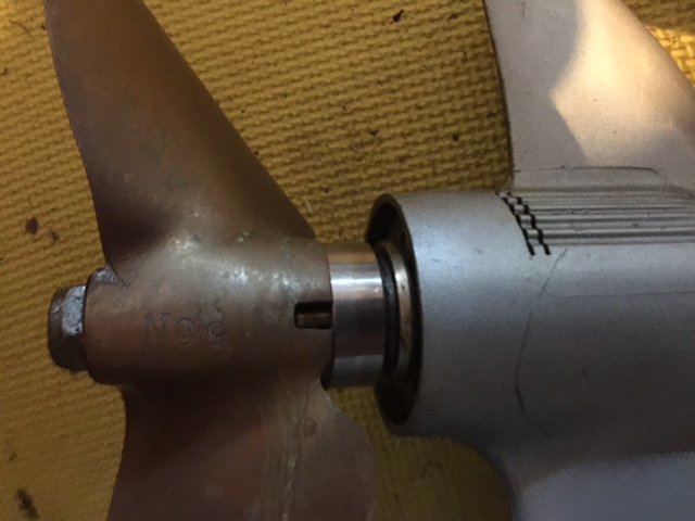

http://www.ebay.com/itm/11-Spline-Prope … SwuAVWuQio
Here you go. Ron Hill has them.
September 28, 2017 at 12:10 am #65450Thank you very much I hope I can repay the favor someday.
MikeI see but that one is straight cut on the outside. Looking for a tapered outside I still will toss one on the shelf.
September 28, 2017 at 1:04 am #65452I have the same adapter on my KF-7, I’ve never seen a tapered cover for it. Did anyone ever make such a thing?
September 28, 2017 at 3:12 am #65459That spacer is for the KF-7 and KG-7 with the splined prop shaft. The prop shaft is smooth and smaller on the KE-7. (9/16" vs. 5/8" I think) I can measure them and verify, but I am sure that they are smaller on the KE-7.
Steve
September 28, 2017 at 10:02 am #65469As I understand it the originals were in fact 9/16 for the one and 5/8 for the other, but if one changes all the bearings and such they can be used in either. I have a KE7 with a smooth 5/8 prop shaft and a KG7 with a splined shaft…Oh the fun of working on a Merc, but LOVE that speed
classicomctools@gmail.comSeptember 28, 2017 at 3:19 pm #65482Hi Richard,
Yes,
My Merc’s the KE7 has a 5/8 smooth shaft in it and so does my KG4. My first Merc’s and I am enjoying them so much and they never have been run in my hands yet.
MikeSeptember 28, 2017 at 10:09 pm #65507So you are looking for an adapter to change from a through shaft shear pin to two parallel pins.
September 29, 2017 at 12:17 am #65515No that is what you see on there now. I am looking for something to compete a smoother contour between the foot and the prop.
September 29, 2017 at 3:36 am #65535Nothing I know of is available. From what I have seen with the "exhaust through the hub" lower units, it is unnecessary. The early V4 75 horse used a huge tapered prop nut for a smooth flow of water. No change in performance was found with the use of a smaller nut. The biggest improvement was in prop design. The only way to ensure a smooth transition would be to use a longer prop shaft. Then a transition piece would be more practical.
You may be assured that if I am wrong I will quickly be corrected . . . 😆
