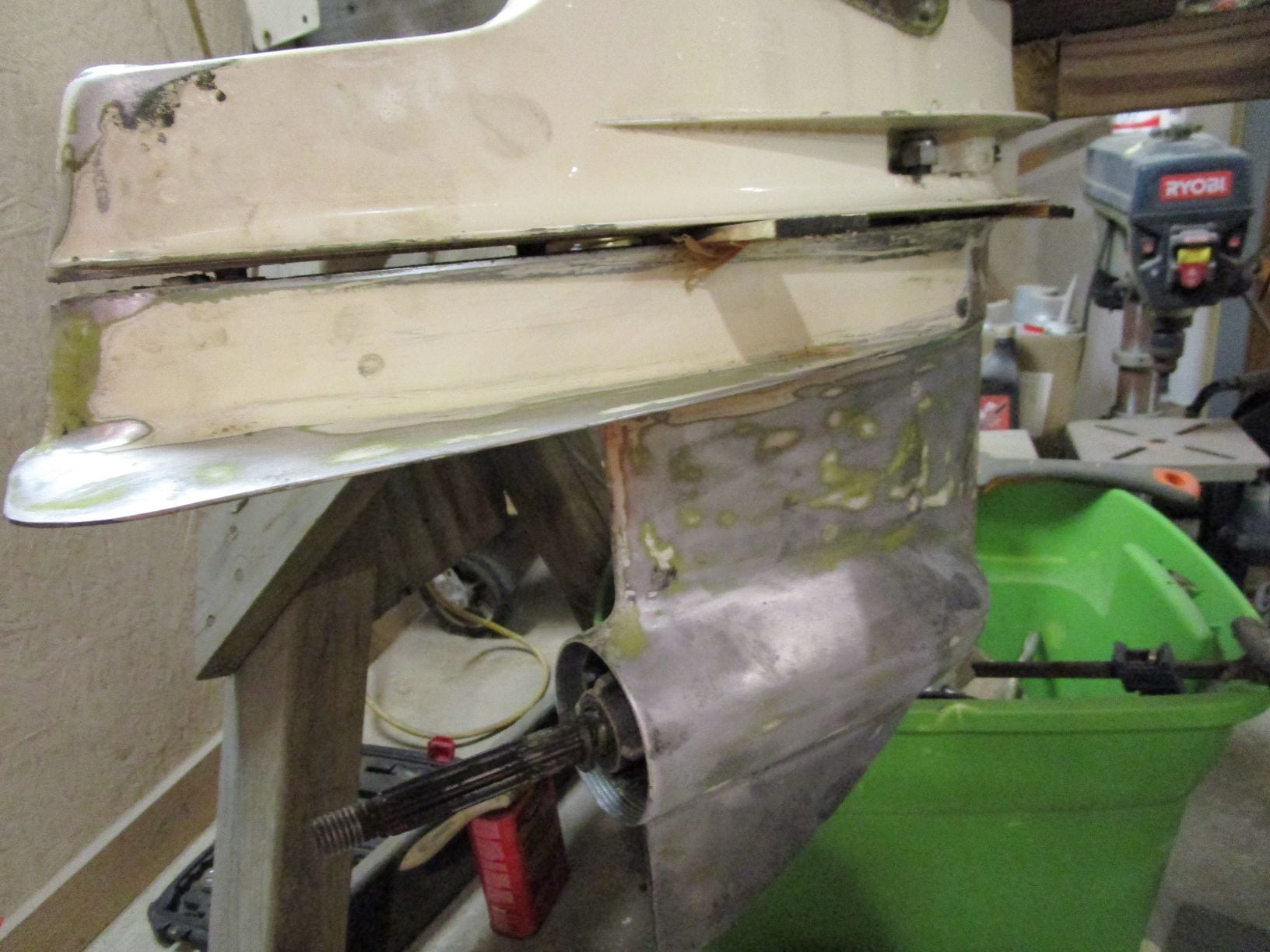

        #192341
        Samuel Phelps
          Struggling with it … Any suggestions or tricks ? Doesn’t want to shake loose ..

          #192361
            that is usually a frozen shift shaft coupling. I use wedges on both sides of the shaft. MOST TIMES it comes apart.

                #192460
                Samuel Phelps
                  Got it loose finally ! I stacked some washers on top of the upper mounting nuts and loosened the nuts . Thus pushing it down against Drive shaft housing ..
                  About 3 good turns and popped it loose …
